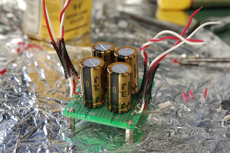

- purchased some leaded single cell AA battery holders on eBay. (link)
- grabbed two b-board pcbs from the in-house stack.
- assembled a power switch (DPDT), headphone jacks, a reasonably large case so I have plenty of room to work

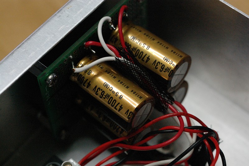

- grabbed some Nichicon FG 6.3V 4700uF caps from Mouser. I don't believe in battery power unaided. The AA cells will feed a 4x4700 uF energy reserve.

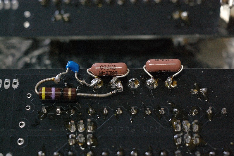

- the b-board circuit will be modded as R1-R6 : 47 ohms (kamaya 1/2W carbon comp) R7-R9 : 1 ohm (kamaya 1/2W carbon comp) R10-R13 : unpopulated. The board will be powered from the "regulated input" V+, V-, COM pads. The Z-reg stage is left unbuilt.

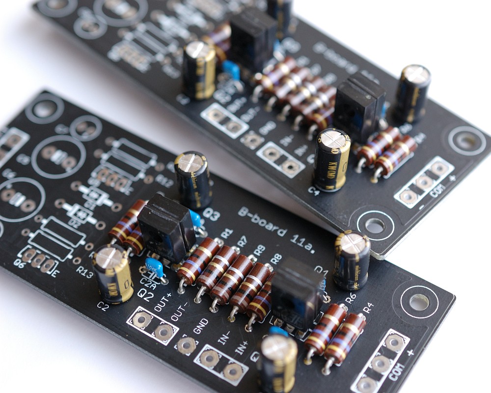

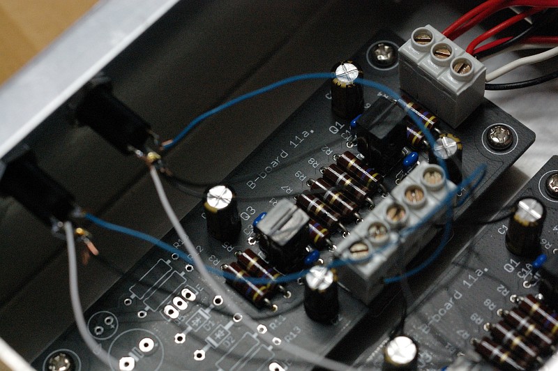

Finished assembling the pbcs. (That was the trivial part...)

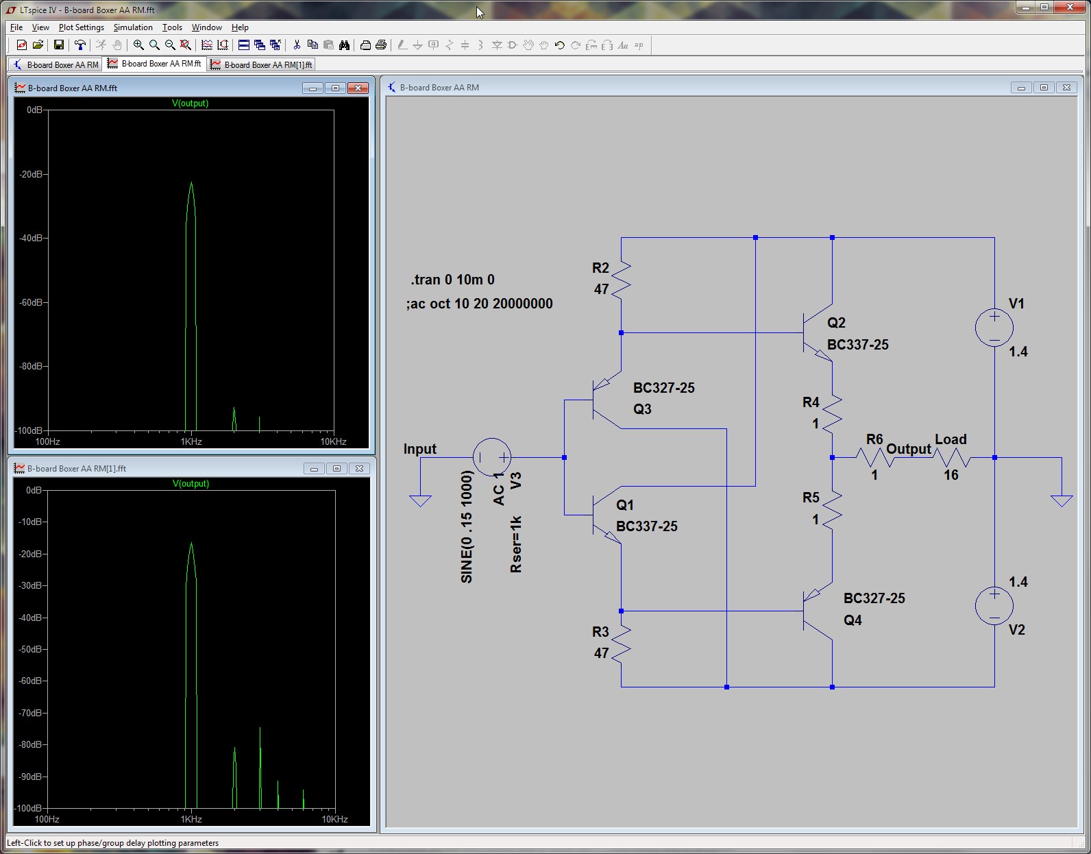

LTSPICE file
This is a model for simulation, not the actual circuit. I'm using it to get a feel for what the distortion looks like vs. output power.
The circuit manages about 0.5 mW class A into 16 ohms. 10 mW class B before voltage clipping. In class A the distortion is extremely low (<0.01%) but it rises a little with some prominent 3rd harmonic as you move into class B operation.
All very expected and textbook-y. The point is, though, that as long as you are listening at less than 0.5 mW, it's really clean and you've good a fairly massive class-B power reserve before things get really nasty. Even on transients real-world output power is highly unlikely to reach 10 mW for >100 dB/mW-class headphones

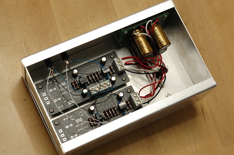

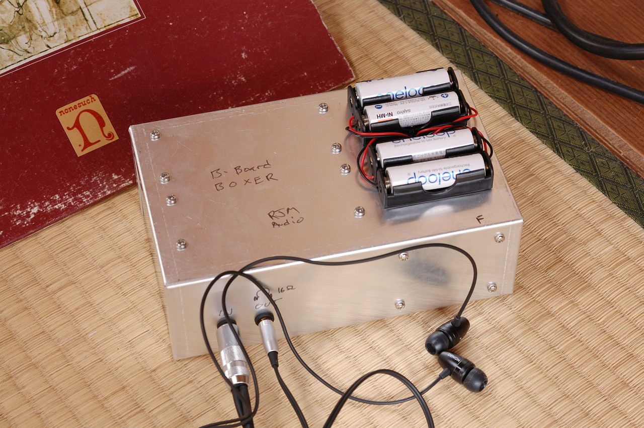

Sorry for the wait, been too busy this last couple of months to deal with this - finally managed to case the B-board Boxer up this morning.
+/-1.26 V rails, dual mono, 4700 uF filter capacitance per rail.
1k ohm input resistance, 47 ohm 0.1 Zobel on outputs.
9 mA bias, <20 mV offsets.

Test notes:
Sanyo eneloop AA voltage is 1.17 V on turn on, but rises to 1.26 V after a few minutes, falling very gradually thereafter.
47 ohm emitter resister measures 0.63 V (13 mA)
1 ohm emitter resistor measures 0.008 V (8 mA)
~ 75 mA per channel power draw.
~ 0.4 mW class A output power into 16 ohms
~ 10 mW class B output power into 16 ohms
Adjusting the simulation to lower the voltages to from 1.4 to 1.2 V, the currents displayed match the physical measurements exactly. LT spice is impressive! Hopefully the distortion calculations are as reliable...
