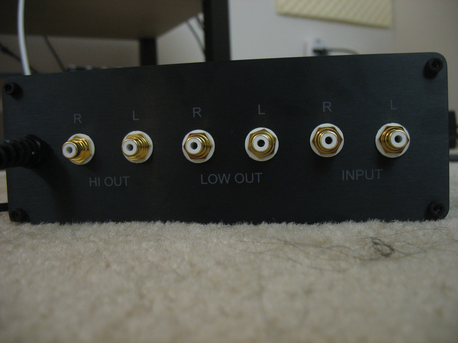

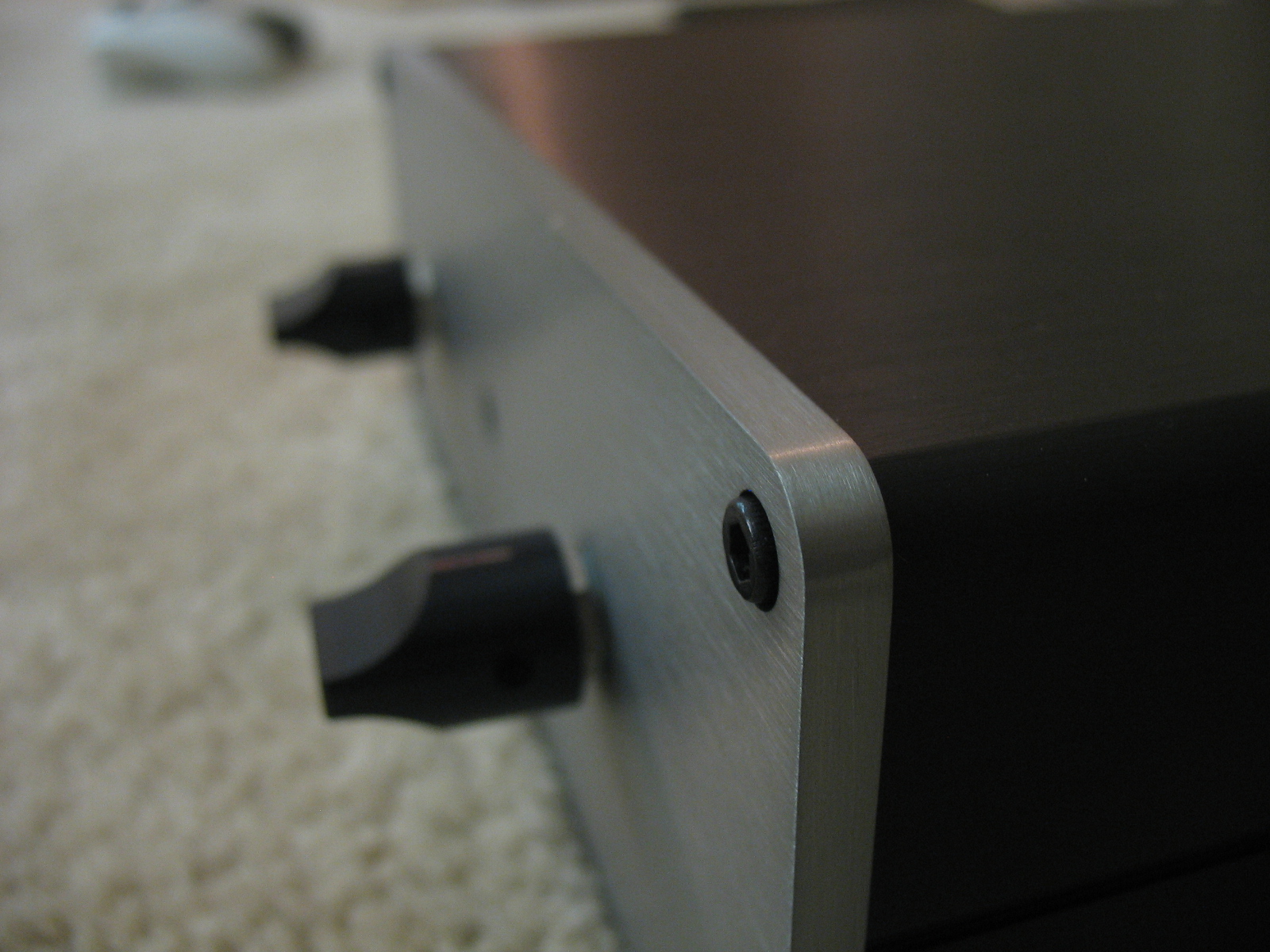

B5
Nelson sent out a preliminary version of the B5 a while back. This version, which ra7 has, is a bit different than the final version. A peak on the inside will not tell you much about the final version.
There is no notch filter or step filter in the release version. The original version had the crossover frequency limited to 150 hz, the new release extends this to 300 hz, which works really well with some of the smaller baffles and smaller drivers.
I have taken a number of orders for these already. They will probably be quite popular.
There's definitely a coil in there. But its in the notch filter/step filter section.
Here's a couple of pics to whet your appetites.

Oh and the innards are a work of art. The craftsmanship is of the highest standard.
