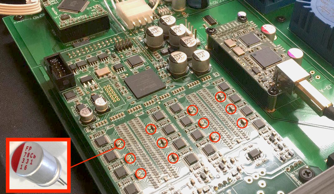

Hi Audiozen / other Soekris bros,
I finally finished my DAC; I just have couple questions:
1. The big transformer is the main power supply for the Soekris board obviously; I think it also powers the OLED display and other minor circuitry right?
I am thinking of trying the Salas BiB v1.3 PSU; Do I simply plug in through J7 and leave the big blue transformer as is?
2. My friend finished his DAC months ago; we bought the extra capacitors for both the base board and Soekris DAC board modding. He listened WITH and WITHOUT the 12 silver caps on Soekris board and he concluded that he did not like the sound quality of the 12 silver caps. It was worse than without.
I wonder if we bought the wrong type/value or anyone has the similar experience? I still have the 12 caps in the bag and I am hesitated to go for it.
3. I believe the IR sensor needs a hole on front panel to receive the signal from a remote? I forgot to make one; if so the case, I can live without one; it is not much to control on the dac anyway.

Ok. For safe 2 pcs lt3045 an 1pcs of lt3094 is enough. Positive current is around 350ma negative 150ma. Rev5 even lover because of just 1 opamp. It is well known that opamp stage is bad. So if you unsolder opamps out it is even less *problematic*. Tps is not optimal for analog supply that is what we heard at testing soekris. Also FP polymer mod is not optimal. Ok noise go away on scope but midrange iss too plastic hard sounded tweets little to harsh, compare to dacs like Total dac, Analog dac, Audio note...

Can you describe what was worse, maybe we have similar problem.
Filter linear ...frimware 1.06 or 1.19?
I bought the DAM1021 at the beginning of 2018, no idea what version.
I have to ask my friend what exactly is worse with the caps than without.
Are those the correct type/value caps for DAM? Any "the best" type should I get instead?Just a beginner here.

If you wan't more bass then do the super regulator/follower mod in addition to the more capacitance mods. You might want to change the 7x05 regulators to something with much lower Zout too if you eliminate the stock series resistor config to instead a superreg.
