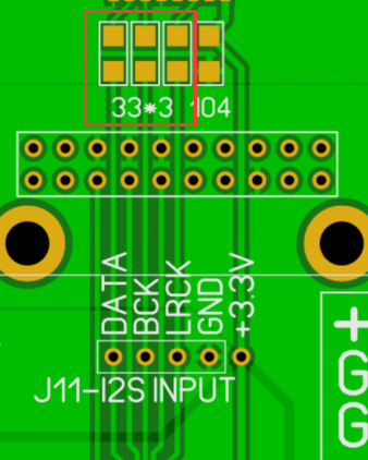

Using J11 to connect the raspberry pi, you need to remove three 33 ohm resistors. This way, the i2s is the raspberry pie, but the hdmi i2s isn't available.

I am going to create external on/of switch for choosing the input between Raspbery Pi (or Tinker Board) and HDMI. I want to still keep functional HDMI(I2s) as is now, just to have possibility to switch manually to RBPi. Should I brake/cut PCB paths between I2S and resistors? .
Which paths I need to cut? All of them or it is enough to cut GND and 3,3V? Or perhaps can I connect RPi directly to isolated I2S input on Soekris? And leave this HDMI as is?
The HDMI interface of AZ1021 SK is a differential I2S signal, and the interface standard is the same as PS audio
If you don't want to use this HDMI, you can remove the 3 resistors in the red box. Then J11 of AZ1021 SK is the second standard I2S interface.
I really appreciate your support but...As mentioned goal is to connect 3 sources to 2 inputs. I don't want to dismantle/deactivate HDMI (remain used by external transport) and sometime I will use Amanero for my PC (resistors I guess should remain in such case?) . Should be HDMI or Amanero switchable witth this RPi?The HDMI interface of AZ1021 SK is a differential I2S signal, and the interface standard is the same as PS audio

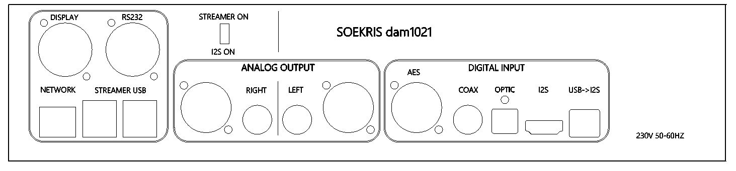

Thank you for drawing I used it to create own version for 320*70mm . Here is my multilayer CAD draw(so simply switch off measurements or print layer if openings are needed only).Since the chassis has not been progressed🙁🙁🙁, so I put the back panel files of the chassis for reference.🙁
I decided to buy ready full aluminium case WA50 -you can find it ie on eBay as it already has big windows in the front and 2 knobs (transparent screen is attached).
I used opportunity to utilize additional space and added Raspbery Pi /Tinker Board section with switch between I2S (HDMI) and RPi.
Additional socket holes are standard Neutik D type.
J11 and HDMI can only use one. When the resistances are removed, HDMI can't be used.
I think there is misunderstanding between us. I won't use both inputs in same time, but find the best way to manually switch between them. So I2S or RPi manual switch is something I need.I asked you for the support as you know it better. thanx

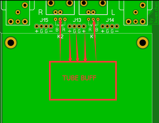

I ordered the AZ1021 (non-lite). Is it possible to to build a tube buffer using the signal off j13? If so, what would you recommend for hooking up RCAs (I only will use the DAC single ended). I could leave the board intact and add a another RCA set or remove the RCAs from the board and use them. Any other ideas/thoughts?

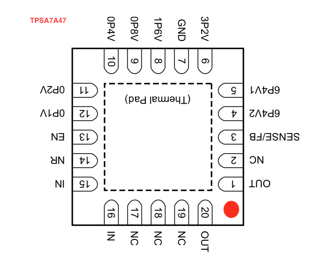

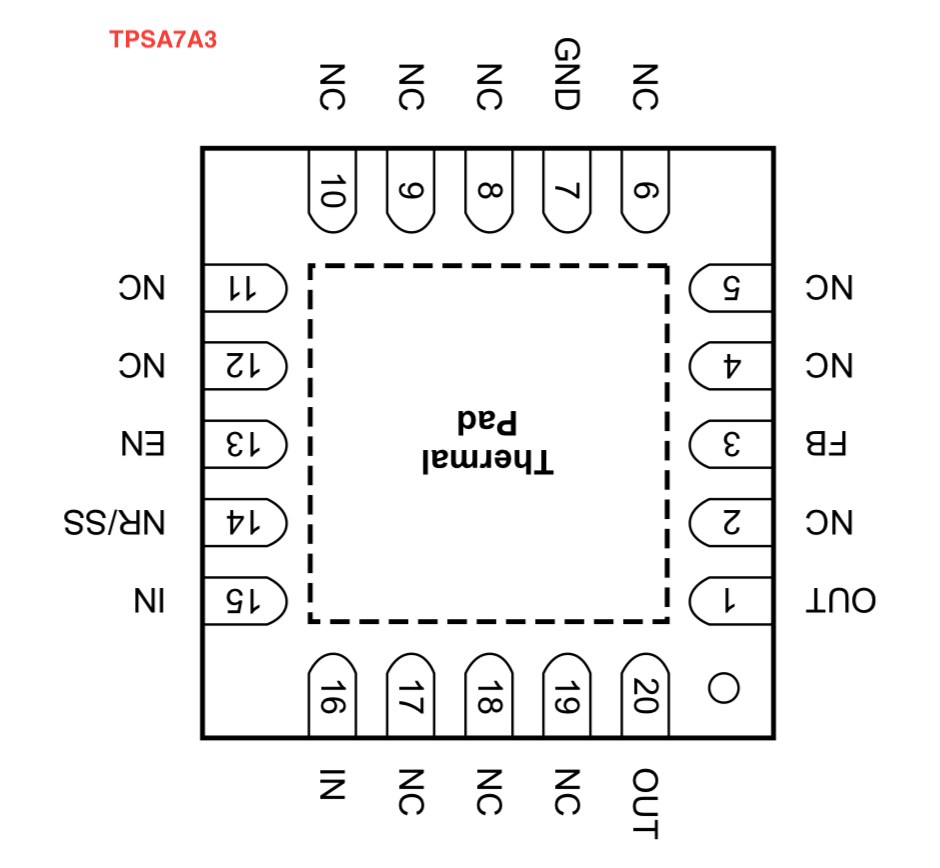

Had a quick look on the datasheets, looks OK. You can see the function of the pins in the pictures
The pins are soldered together on my board too
