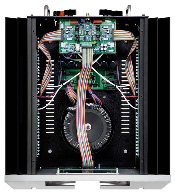

uptate Aleph 1.2's to XA100 or better
GL and GR, yes I am going to do it!! I have made a decision to update my Aleph 1.2's to the XA 100 to 160. My initial thoughts are:
Remove the Aleph Driver Board
Remove the Aleph Plitron 2kva transformers.
Keep everything else.
I have 24 out put devices per mono amp, I would rewire them into 4 quads with 6 devices each.
I will keep the PS caps, chasis and heat sinks.
I have to make up new driver boards but I would like a bit more power so I was thinking of about +/- 30 to 35 volt rails.
I will have to purchase some new audiophile grade xformers that are not the buzzards I have now. The Aleph 2kva (+/- 60v dc) xformers can be sold, saved or used as boat anchors.
My Alephs were built in 2000 and have given me 7 years of music harmony.
Risks and questions:
I will use the schematic that GL has proven works well to start and go from there.
I have followed the threads regarding how to adjust the current sources to 50% but I have never done it so I will make sure I understand this well before attempting it.
I hope the XA series can drive 7ohm impedance. I will use this as a full range amp or in a bi-amp mode with my Pass 350.5 driving the mid basses. For the biamp mode I am not sure what the total impedance of my 12 fountek ribbons per side is as I don't have an impedance meter and I can't get a dc reading because the drivers have impedance matching transformers.
I think I understand well enough the issues regarding DC offset. Needless to say, I must design this thing so I don't get thumps on turn on and turn off. I will protect my tweeters in my line array with a 20uf cap.
I have a lot of leftover parts with 9610's and resistors so the first job is acquiring the rest of the parts. The xformers will be the most expensive issue. I will reuse my AC input filters and hexfred diodes. I have 6-15,000uf caps in the PS hooked up in a clclc arrangement using 1mh iron core inductors. If there is room in the chasis I may add some extra caps. Or I could add some caps right at the drains. I will keep the grounding arrangemens but disconnect the speaker output grounds.
Since this is a balanced bridged design I am not sure how to calculate the output power. My Aleph's are biased at about
.33ma per device x 24 =7.9amps or 3.8A per side. The heat sinks get to about 55 deg C. When calculating the output watts rms into 8 ohms (I am going on memory) I got a bit over 200watts with clipping at 55v p-p.
The other option is to go out and help NP's bottom line and buy another 350.5. The last time I did this I had to convince the audio salesperson that he and I were related through DNA evidence back to Italy in the 15th century and that "you wouldn't take advantage of your brother would you"!! I also found a nick on the face plate and dust on the heat sinks which of course means a huge discount. I also must convince the Prime Minister at home that she can put off some vacation plans or furniture acquistions.
If you have any suggestions let me know. My time frame is to get the boards done and tested this summer but I have vacation and business trips which will interfere. Wish me luck, dave

Hi Dave,
Sorry I haven't replied sooner but I have been on vacation myself for the last 11 days. Fact is I was in the same area as NP if you can believe that.
I have never heard 1.2's so I can't say whether you are going to hear an improvement or not. I do know that you have always spoken very glowingly of your Aleph's so this is clearly a hard decision for you to make. I am still very happy with the AX100's and will be glad to help you through the build process.
There are a number of discussions on this site on how to adjust the Aleph CCS gain. There is even a synopsis on this thread somewhere in the first few posts. If you change the number of output devices from the 5 per quadrant that I used to 6 to take advantage of your current 1.2 build than you will need to re-adjust the CCS. But that can be done after the amps are built and even used for a while.
Please note that the transformer secondary voltage I used is not commonly available. If you want to duplicate the PS voltages I used you will need to order a custom unit perhaps from Victoria Magnetics. Your extra LC section will also cause a bit more voltage drop so that will need to considered too. Anyway if you end up with a DC voltage between 25V and 32V in the end, and if the power dissipation per output device is tolerable then you're good to go - so don't sweat it.
The rest of your plan sounds fine. Seven ohms is not a problem. I think you can probably find a parallel/series arrangement for the Founteks that will yield a reasonable impedance. It's the AC impedance that counts - not the DC resistance. The Founteks won't be operating anywhere near DC so that's not important. By all means use the cap - at least to start with.
I think you meant .33 amps - not milliamps.
If you can swing it I think that another 350.5 would be truly killer.

aleph 1.2's to AX100
Gl-thanks, yes I meant 33ma or .33amps.
I got started down this road because I cannot get my plitron transformers to quit buzzing. I have tried isolating them with sound absorbant material etc. I did call plitron and the engineer did admit that under heavy load that these xformers can buzz and he suggested that I put them in another room. Grey thinks I have dc coming in on the ac line. However, neither my 350.5 amp or my 92 vintage A-75 Pass/tharagard class A amps have any noise or buzzing. I could build a dc blocking circuit but I am not convinced this will work.
There is a response from NP on another thread in which he states that the XA100 was not recommended for low impedances and he suggested the XA100.5 but I don't know what the difference is between the two models that would account for this.
I did hear a rumor from a dealer that NP was coming out with new circuits for the XA line and I wouldn't be surprised if we see the Power J-fet invlolved somehow. I also thought of using power Jfets for the differential pair but I am not sure if they can drive all these output devices even if you run up to 20ma through them. I would definetly have to do some experimenting to get this to work.
Another less important reason for udating the Aleph's is grounding. The Pass 350.5 is a balanced bridge design with no speaker ground. All my other amps use the convential positive and speaker ground connections. I just wanted some symetry.
In biamp mode the tweeter and midbass driver circuits don't see each other but they are connected to the same DEQX preamp crossover system. Hopefully I am worried about nothing.

Manu said:have found this on the web.
How beautiful
Yep thats a beauty, allright Counting 4 IRF's in TO220 case, and I bet to spot 2 Toshiba dual J-fets in there. 2SJ109's? The pic is a bit blurry. What is the Thermistor doing on the amp board? Temp. stabilizing of some sort? Also, thats a lot of outputfets
Steen
beautiful is a good word for it indeed
likely the n and p jfets for the ugs driver stage discussed elsewhere in the forum.
looks to me like it's doing something for the meter, but what do i know ....
yup!
mlloyd1
- AX100 100W Aleph-X Monoblocks
