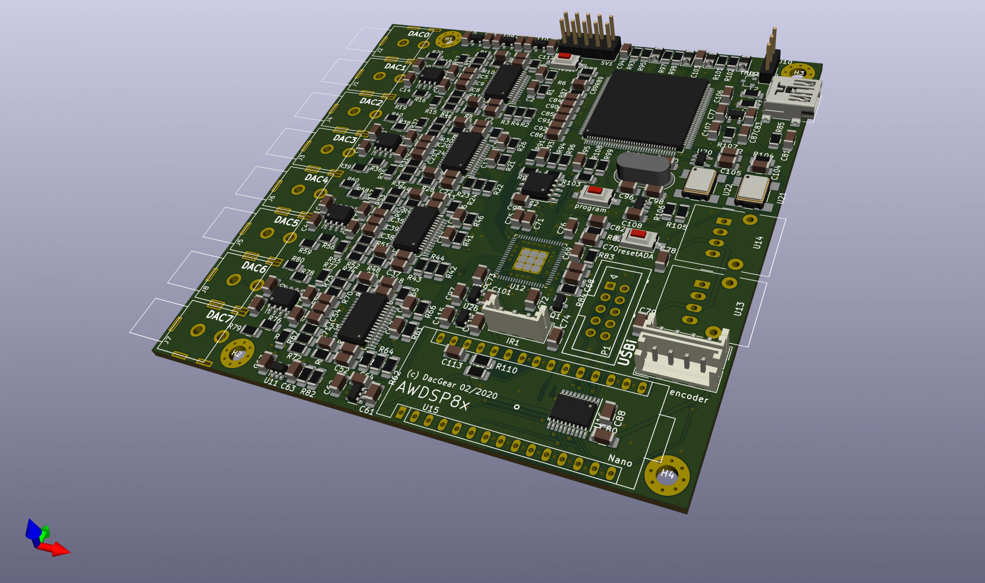

In short: Atmel AT32UC3A3256 (UAC1 and UAC2 modes) as USB-I2S -> ADAU1452 DSP as XO->4x PCM1794A DACs with passive I/V, meant for driving directly amps with 3way speakers + SUB, or 4way. Sort of a digital preamp with XO. Arduino for controlling OLED and for accepting commands from IR remote and encoder. TOSLINK SPDIF in and out.
