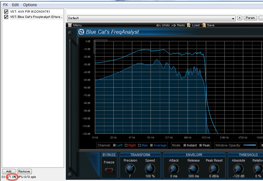

attached image: very steep LPF

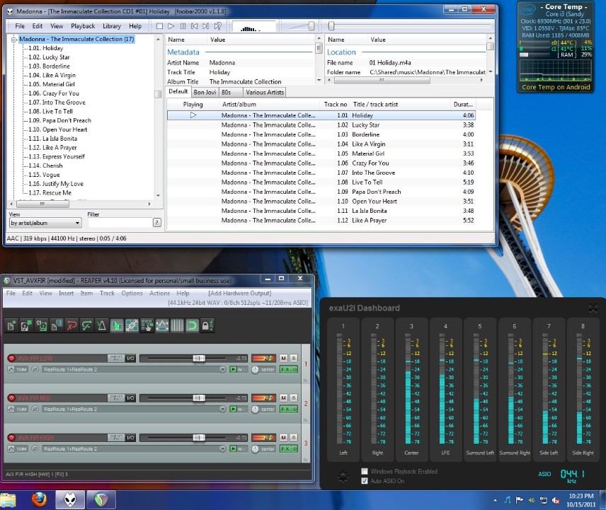

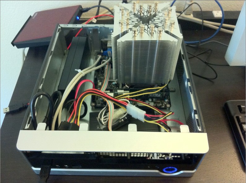

Now I'm playing on new FanLess PC,
Core i3-2120T + Scythe Ninja 3 + MSI H61 ITX + PicoPSU-150-XT
No problem for CPU % and temperature.
foobar + asio_out -> ReaRoute (internal ASIO) channel 1/2
Reaper has 3 tracks,
Low (0-960Hz) -> exaU2I ch3-4
Mid (960 - 3200Hz) + 15.4mm delay -> exaU2I ch5-6
High (3200-22050Hz) + 23.1mm delay -> exaU2I ch7-8

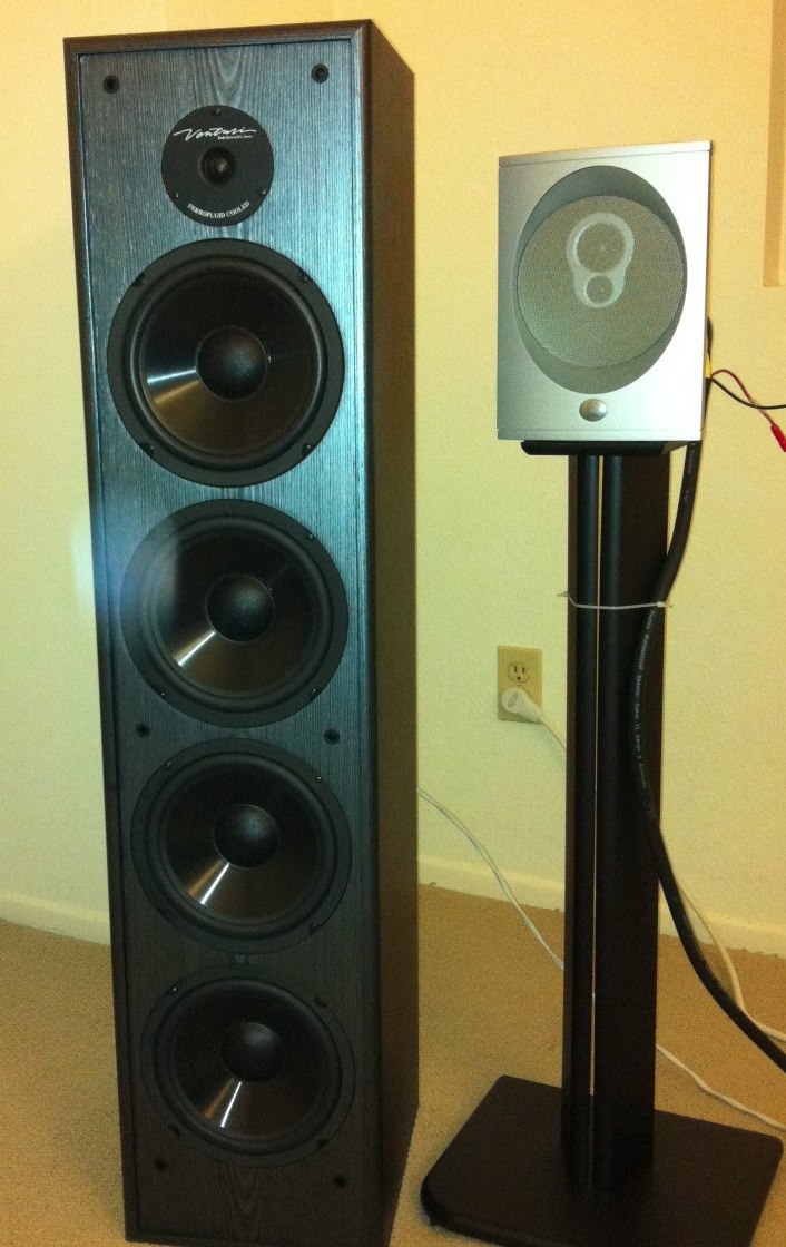

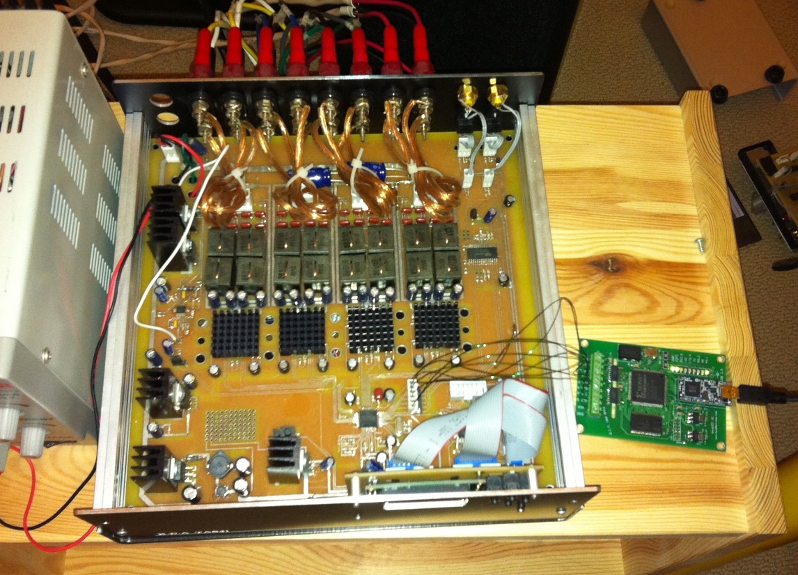

4 way FIR crossover
I added BIC DV64 (8inch x2 + Passive radiator x2), passive network was removed.
Photo 1: 4 way crossover on PC. each track has AVX FIR filter.
track 1: -120 (DV84), track 2: 120-960 (104 Low)
Photo 2: exaU2I USB to I2S x4 + 4way amplifier
Photo 3: Linn Komponent 104(3way) + DV84
DV64 is cheap ($300 pair) but makes tight base, I was surprised.
