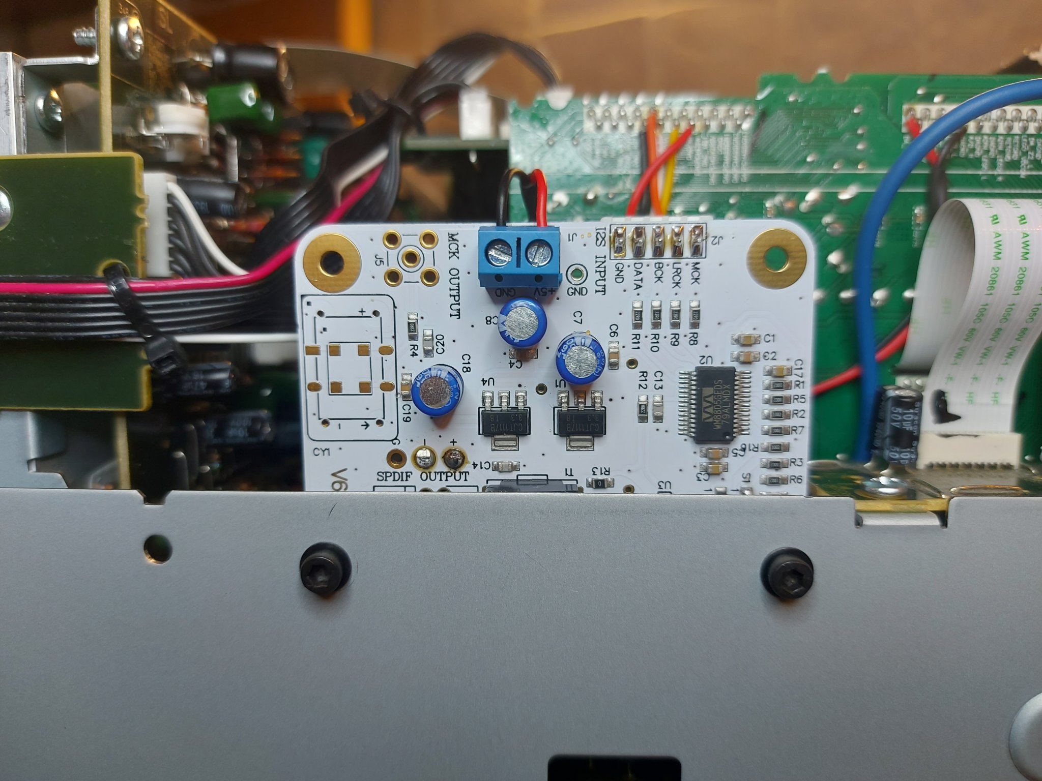

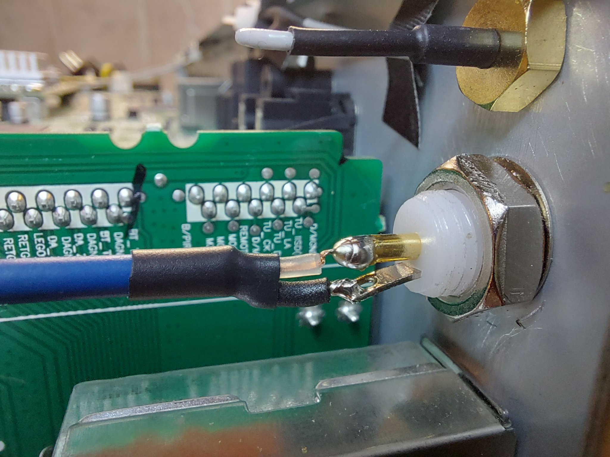

Hi, I would like to extract a coaxial digital output from my Denon x3600h, for the front and left front channels. I saw this video:
I think with your help I will be able to do it.
Unfortunately the video is in English and I can't use the translator, everything isn't very clear to me.
I bought the service manual for my Denon.
Can anyone help me understand which are the 5 points where I have to solder the 5 wires.
From the video I think I should look for:
SCK
BCK
LRCK
DATA 1 L/R
GND
+5V
...but in the end won't they have the same names? Because in the video he is modifying a Yamaha.

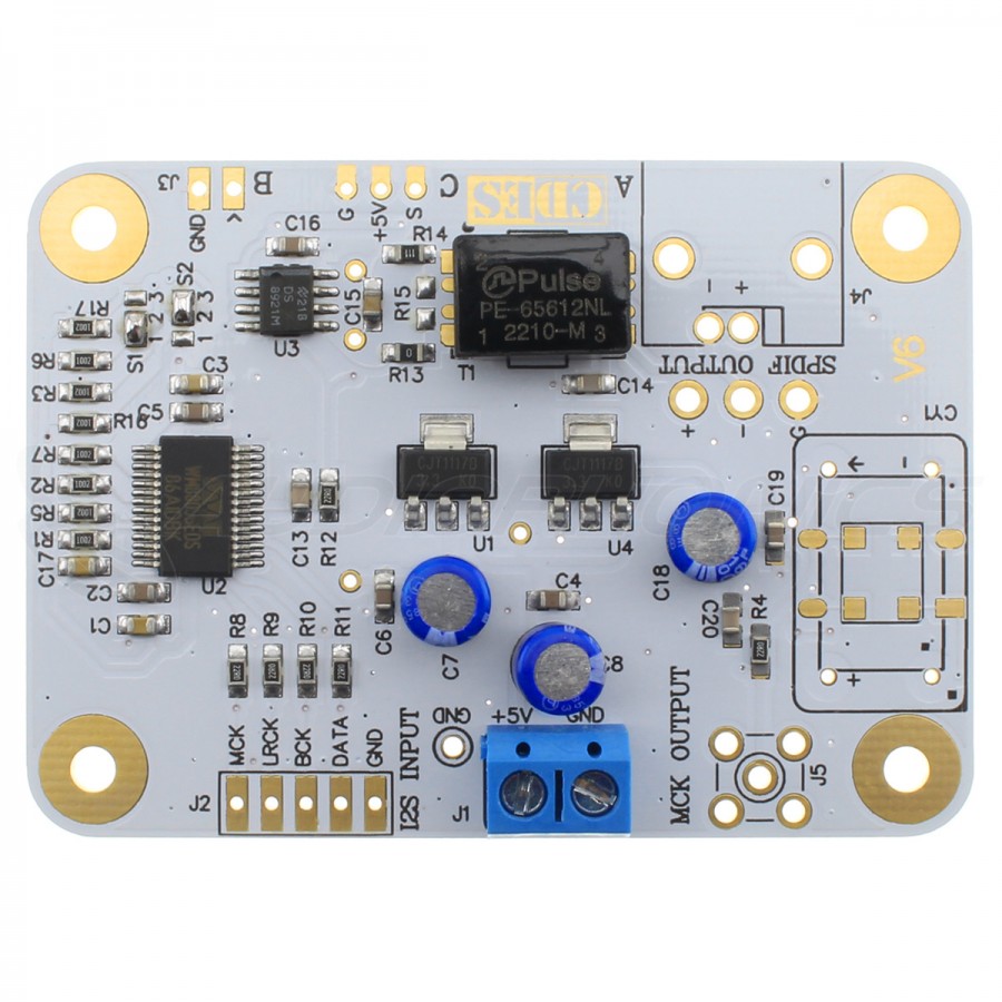

The board he recommends purchasing is this:
https://www.audiophonics.fr/en/inte...rs-spdif-bnc-wm8805-24bit-192khz-p-12561.html
Board have this connection:
MCK
LRCK
BCK
DATA
GND
My output dac is AK4458.
I think I have to connect to the pins (pads) of the AK4458, but I'm not sure which ones. Then they thought about getting the +5v.
Thanks for any help.

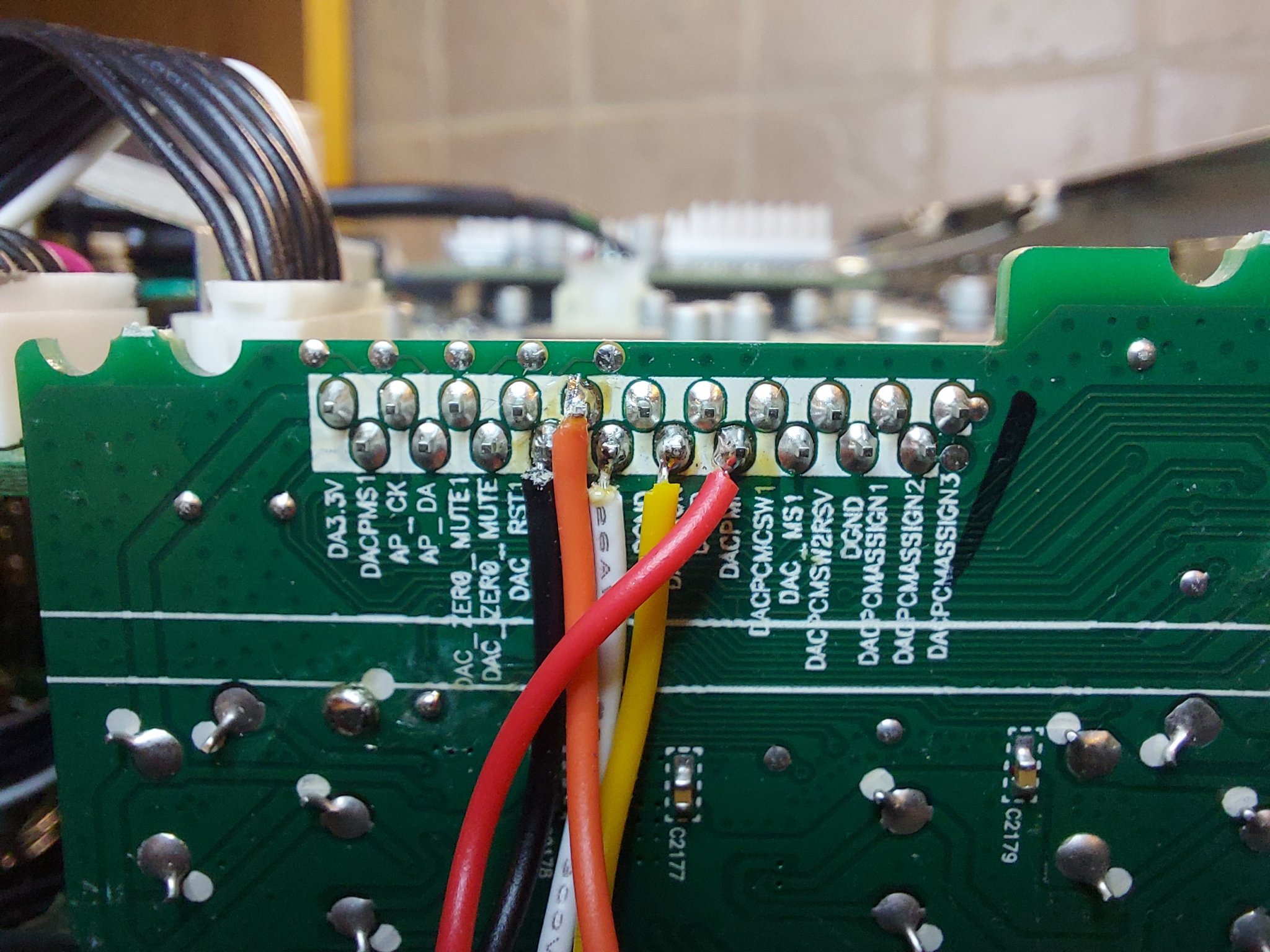

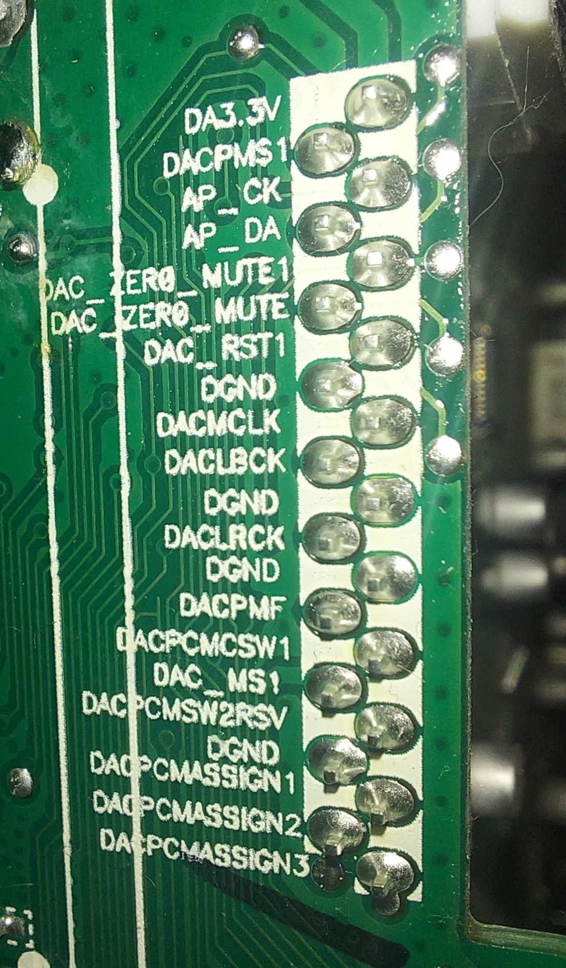

They will not be the same.
For the Denon it is -
DACMCK - Master or System clock.
DACBCK - Bit clock.
DACLRCK - Left/Right clock.
DACPCMF - Front channels left and right.
DACPCMCSW1 - Centre and subwoofer 1 channels.
DACPCMSW2RSV - Subwoofer 2 channel and reserved(no analogue output).
DACPCMS - Surround channels left and right.
DACMCK - MCK
DACBCK - BCK
DACLRCK - LRCK
DACPCMF - DATA
The service manual will provide the information on where to tap 5V and GND.

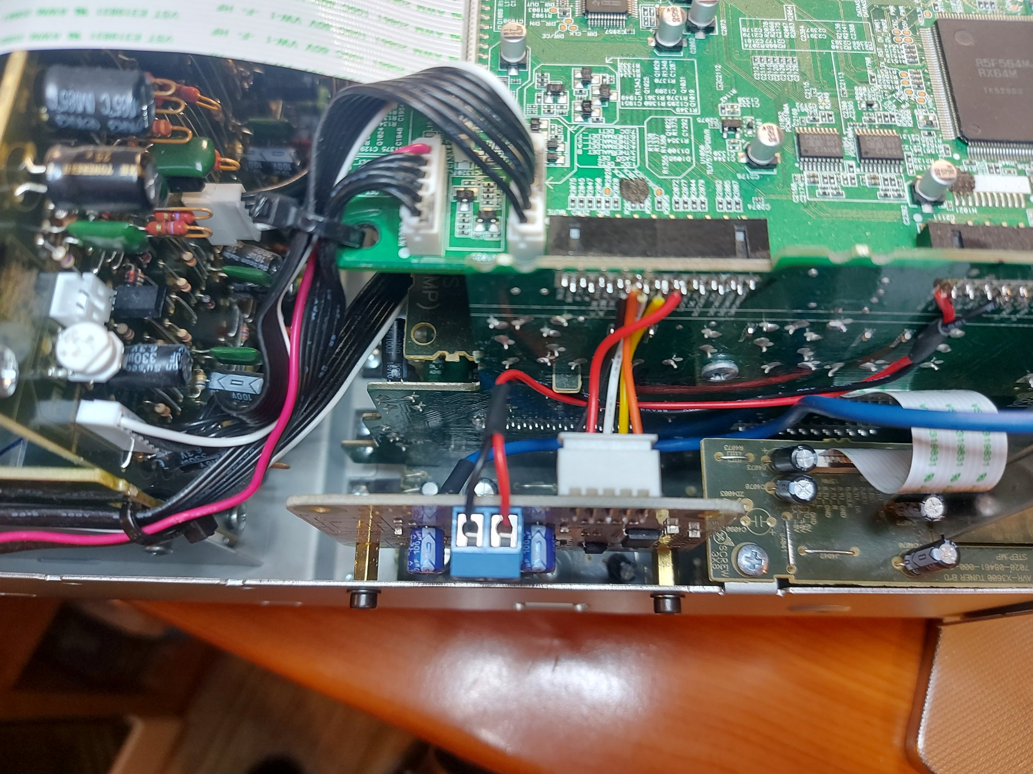

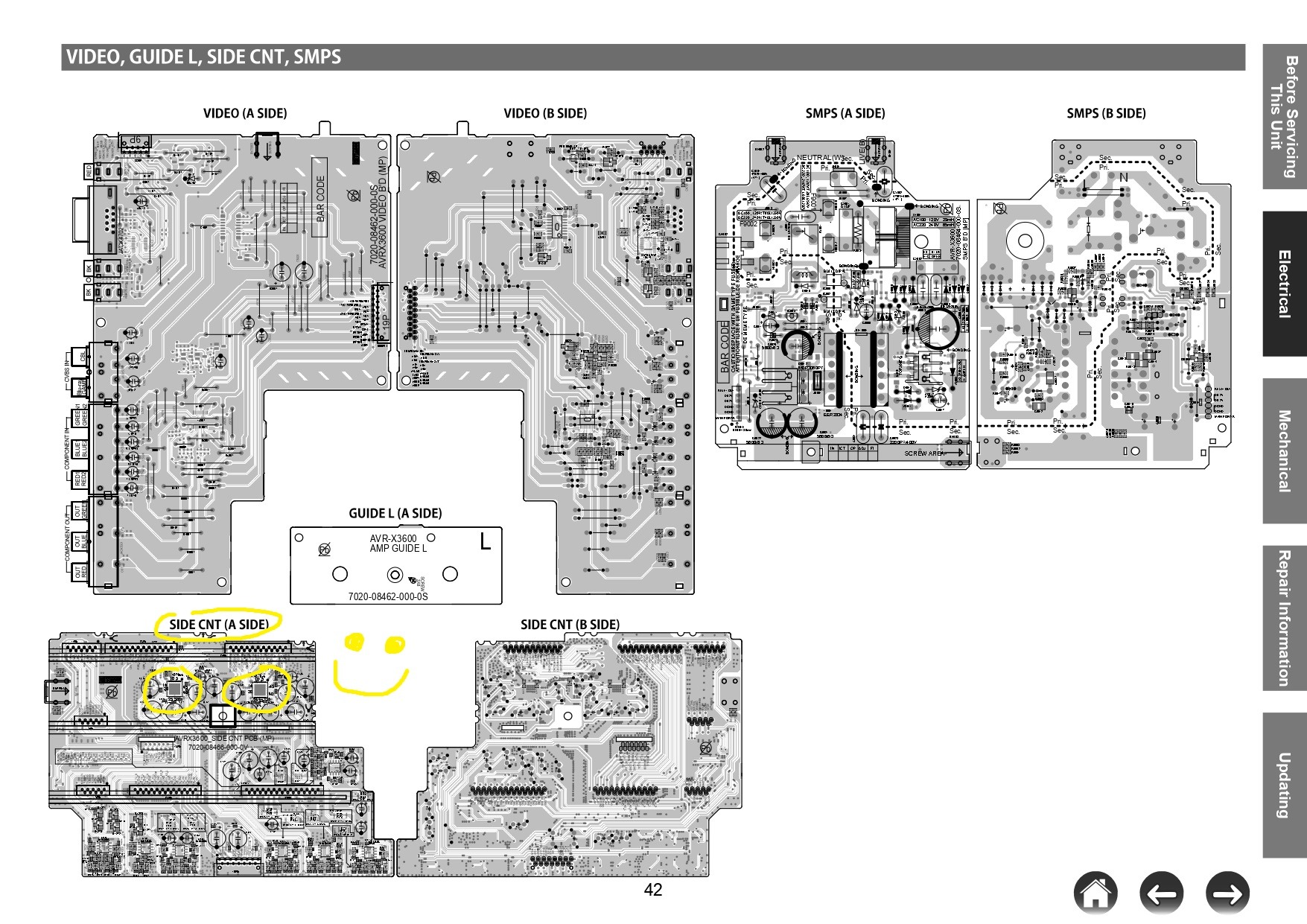

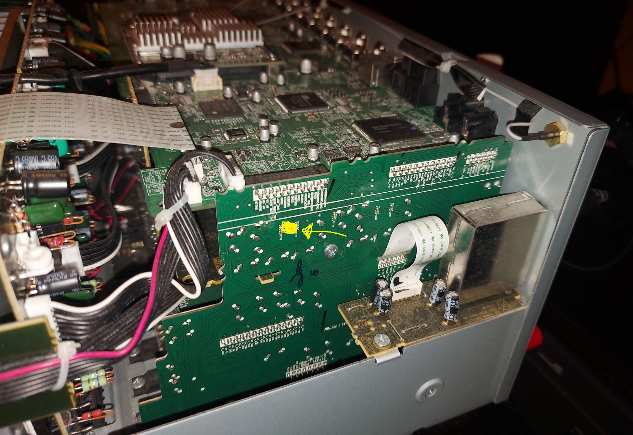

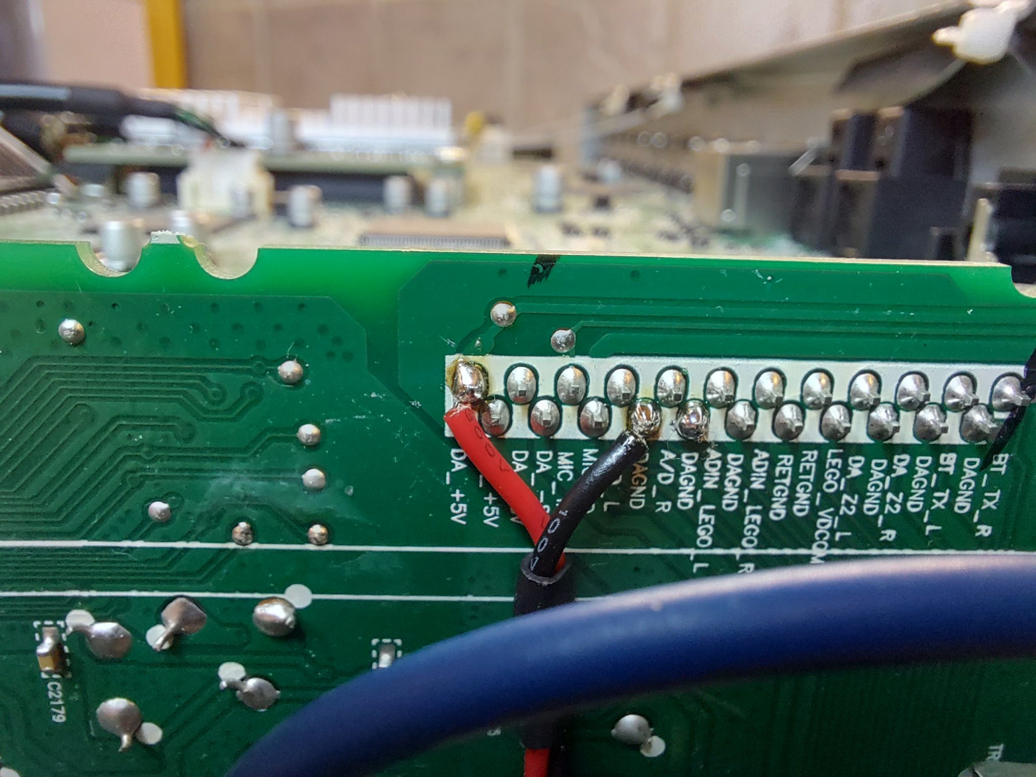

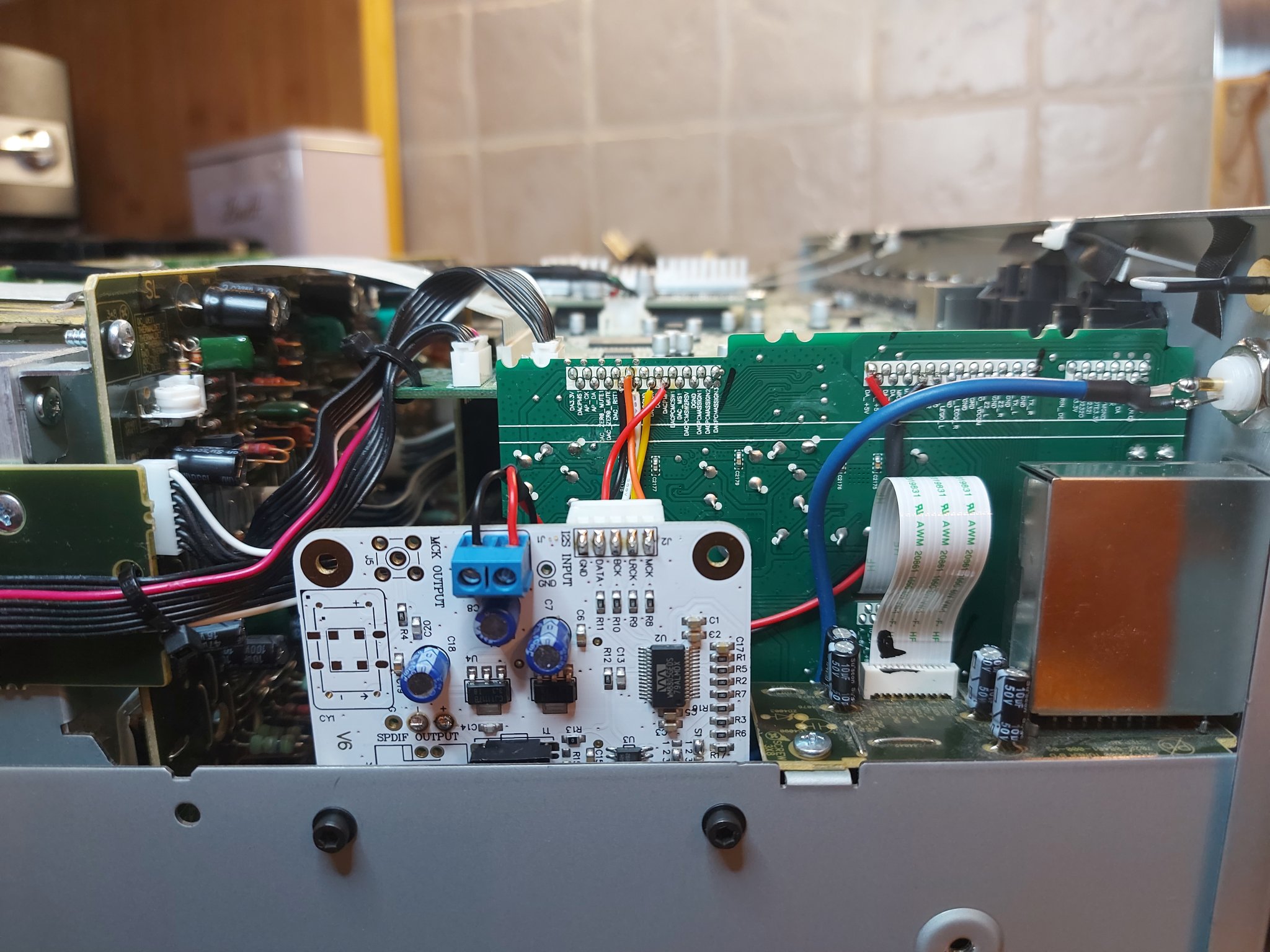

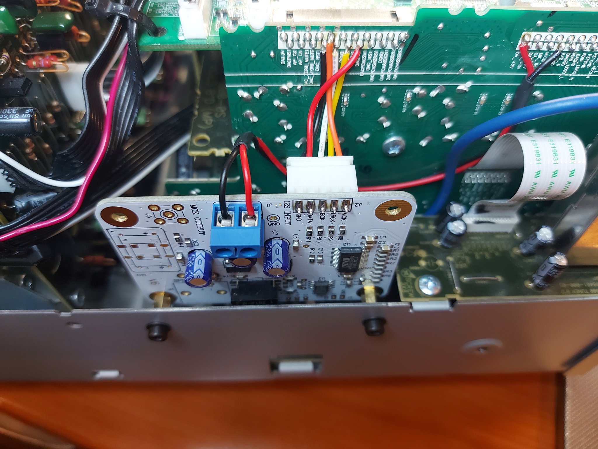

I located the AKM that runs F/L Front. It is on a vertically positioned board that connects to the digital main board.
There is a connector that connects the two boards. I think that connector is the right place to get the signals.
The connector is located 3cm from the AKM and 5cm from the chip it connects to.
Do you think it might be a good place to get the signals? Let's say it's quite comfortable.

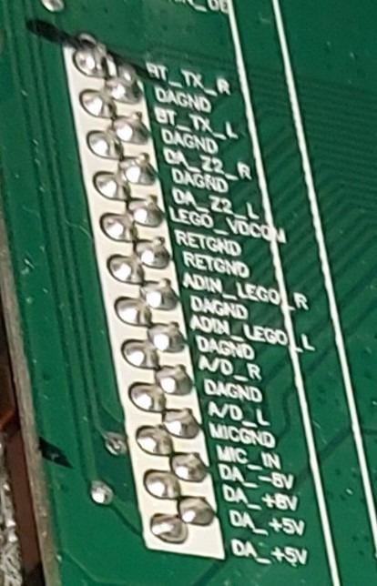

I think there are also GNDs on the connector where I would get the signals. On the other connector I see that there are +5v and GND.
I don't know which ones I have to take to power the board (+5v/GND) and which ones I have to take as digital GND (the fifth wire of the group of 5 wires).
Can you understand it? Thank you again

With the DAC signals I would use one of the DGND ground pins. For power to the board I'd use DA_ +5V and DAGND
thanks friend. I had thought the exact same things but being a beginner I always ask those who know (certainly) more than me! Good night! <3

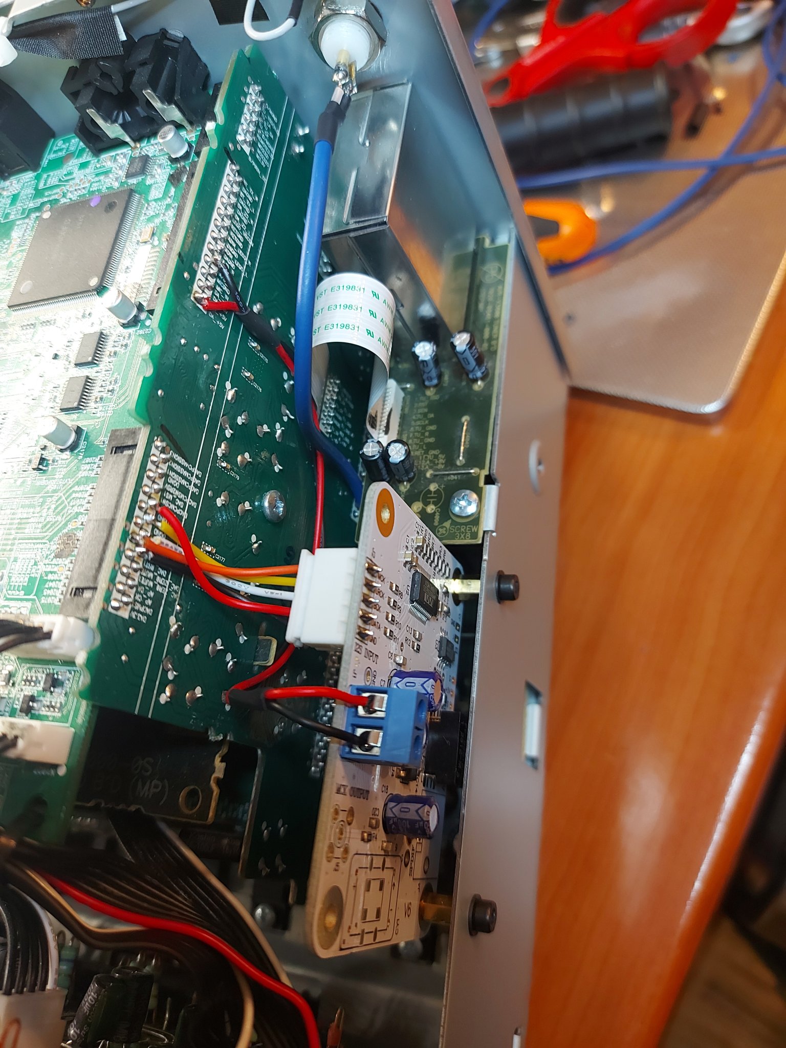

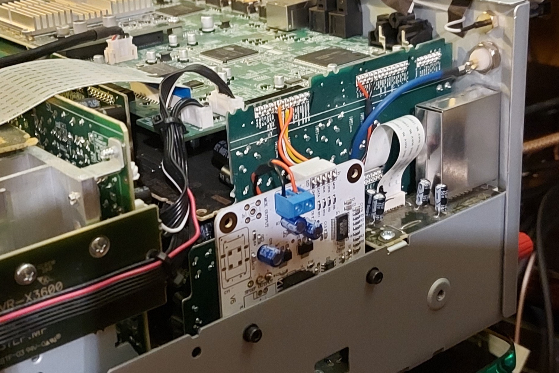

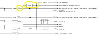

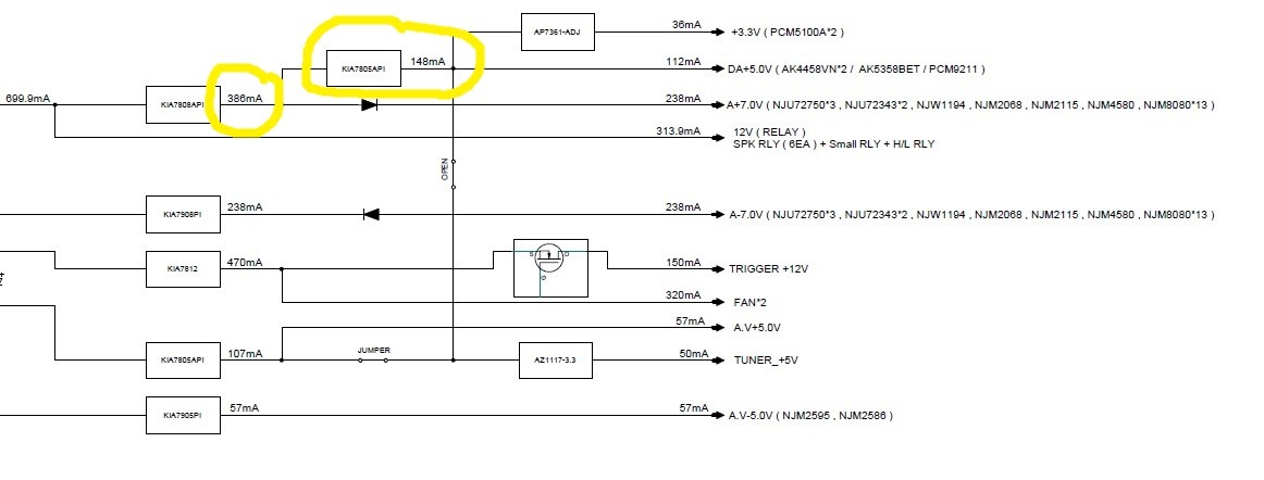

Hi! good evening 🙂 The additional card consumes 35mA on one branch (7808) with already 386mA.
I connected it to a 7805 which takes power from a 7808.
Will it be fine or is the absorption too high?
I don't think so but I'm asking.
Thank you

1. You can do the same for any of the other channels.
2. According to the datasheet the 7808 regulator has a rated output current of over 1000mA.

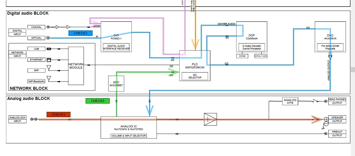

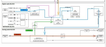

I wanted to add something. Inside the Denon there are two 8-channel AKM DACs...but the Denon doesn't have 16 output channels!
Maybe they put some channels in parallel?
But I don't know, I get the signal at the entrance to the AKM. I'm attaching an pdf schematic file anyway, I don't know if it's useful.
many thanks for any help. 🙁 .... 🙂
