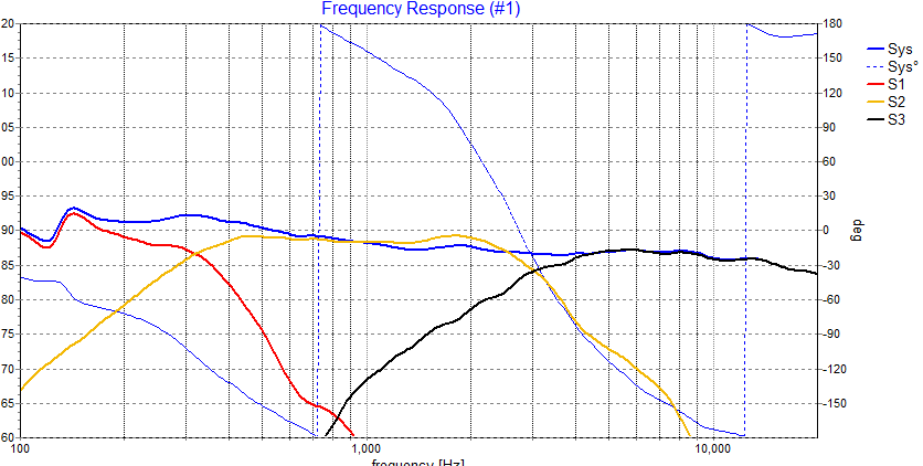

you could try to measure the baffle step as follows, since your bass driver is quite smooth upto 1k
put boxes in desired position and measure bass driver only without any filters
put mic at listening position, try ungated with 1/3 smoothing, measure L/R separately

Check why system response is below the response of midrange in the 1k to 3k area. Check phase tracking graphs.All, my woofer is the SB34NRXL75-8 and is 3rd order. The mid is AC130F1. 2nd order. The slopes seem to match pretty decently between woof and mid. Thoughts?

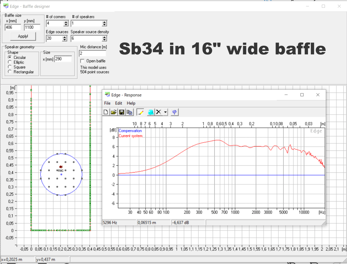

Freeware The Edge is easy sim for baffle effects https://www.tolvan.com/index.php?page=/edge/edge.php
- Edge cannot implement driver's response, it uses a planar membrane and flat response. Baffle edges are sharp, depth unknown.
- off-axis response depends on driver diameter, you can study that by offsetting the mic!
But remember that cone and dome behave differently when wavelength is shorter than diameter of membrane
"Baffle step" is not like a step on ladders, but a slope! In 3-way typically only the woofer must have compensation for the slope and gain. With passive speaker, mid and tweeter must be attenuated!
Only anechoic or outdoor measurements are better than Edge sim!
Room response is however most important for low bass, it is affected by room dimensions and speaker placement. When using dsp, don't sress too much with low end response simulations!

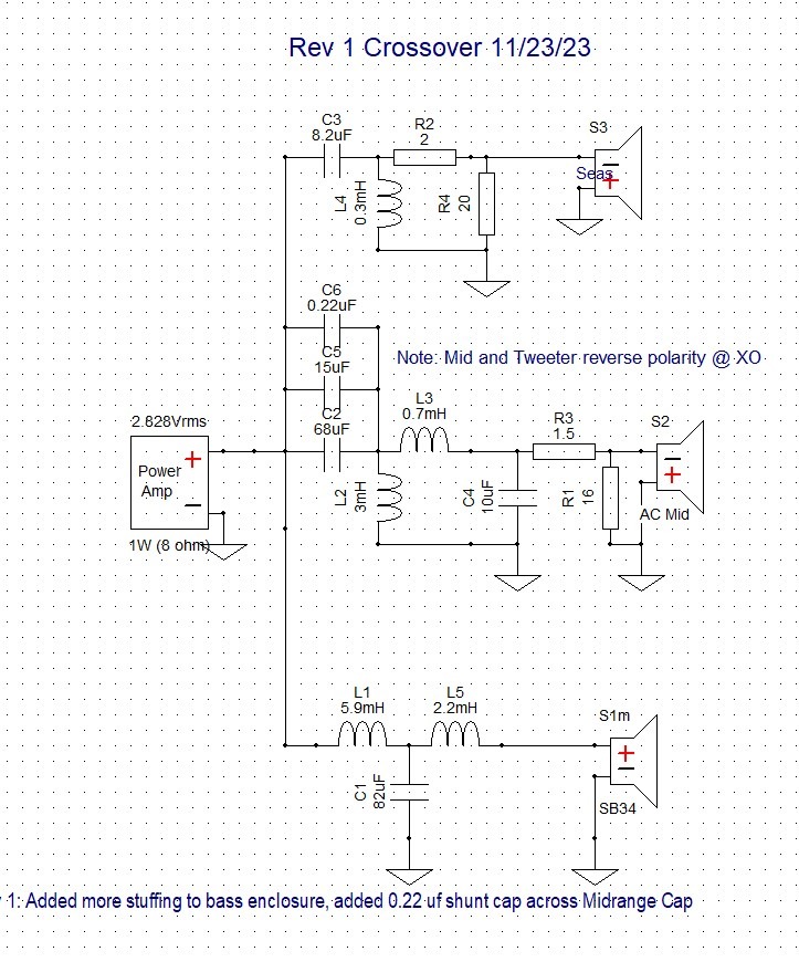

My baffle width is 16 inch the step frequency comes out to 285hz. I crossed over my woofer at 285hz. I pad down the mid and tweet. Is that an acceptable alternative to adding the baffle step compensation circuit?
So that's two different things, one cannot replace the other.

OK I have a question. If I use the Baffle Step calculator (6db) requires a 3.4mh coil 6 ohm resistor. I can do 3 db and it would be a 1.4mh and 2.5ohm resistor. Does this take the place of the existing crossover in the woofer section? in addition to?
The question in post#1 was "I pad down the mid and tweet. Is that an acceptable alternative to adding the baffle step compensation circuit?"
The simple answer is NO. Padding M and T is secondary, because BS compensation of the W will reduce it's output. If one does nothing to eq the woofer's farfield response and pads down M and T, there will be a bump in upper bass just below WM xo (assuming all drivers have same nominal sensitivity)

If the woofer to mid crossover is at somewhere between 0.707 to 1 times the BS(-3) then padding down the midTop works perfectly.

here is the crossover as modeled in XSIM. I did not take into account baffle step initially so trying to make required adjustments now. Some answers say to add the compensation before the existing XO others say to make changes to the existing XO incorporating the baffle step compensation so I am a bit confused.
