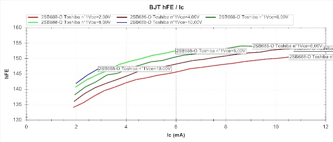

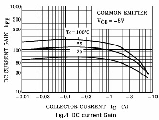

Of course, each electronic equipment should be used carefully within limitations. DCA 75 goes up to 12 mA. While it isn't design to give the actual Hfe under proper bias operation for power transistor, it can give a rough idea of it's range at low Ic value.
The first picture below is from the 2SB688 SAVANTIC datasheet. As you notice, Hfe range starts at 10 mA, and Hfe increase only slowly with Ic.
the second is a Hfe measurement of used Toshiba 2SB688. As you can see, despite the DCA75 limitations, the values are quite consistent.
I've done the same measurement with some ON 2SD1943 from Mouser. the Hfe were quite the same : 117/118/119/119/120/120/120/120/121/121/122/122.
For sure, DCA 75 can't be use to match accurately power transistors vs Hfe parameter. But to give an idea of Hfe range, it isn't that bad you describe.
