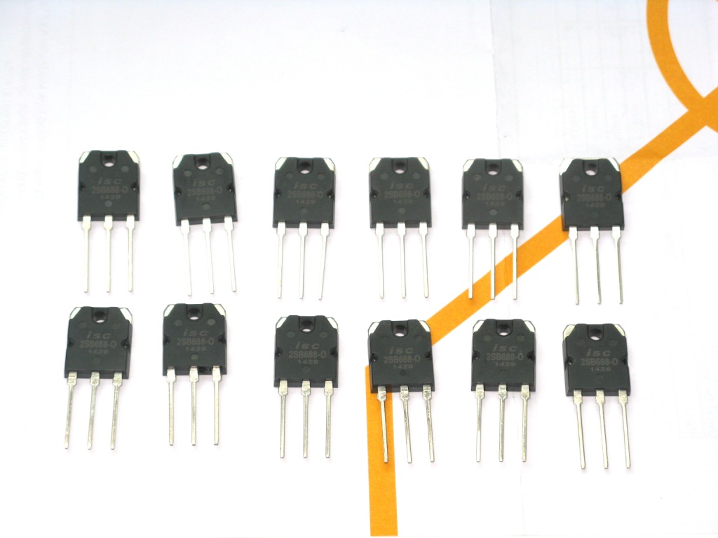

The amp I get has burn his left chanel power transistors including the darlingnots/drivers ones, so I start to inquire genuine transistors to fix and overhaul the amp.

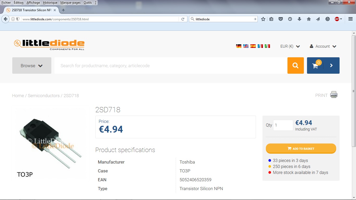

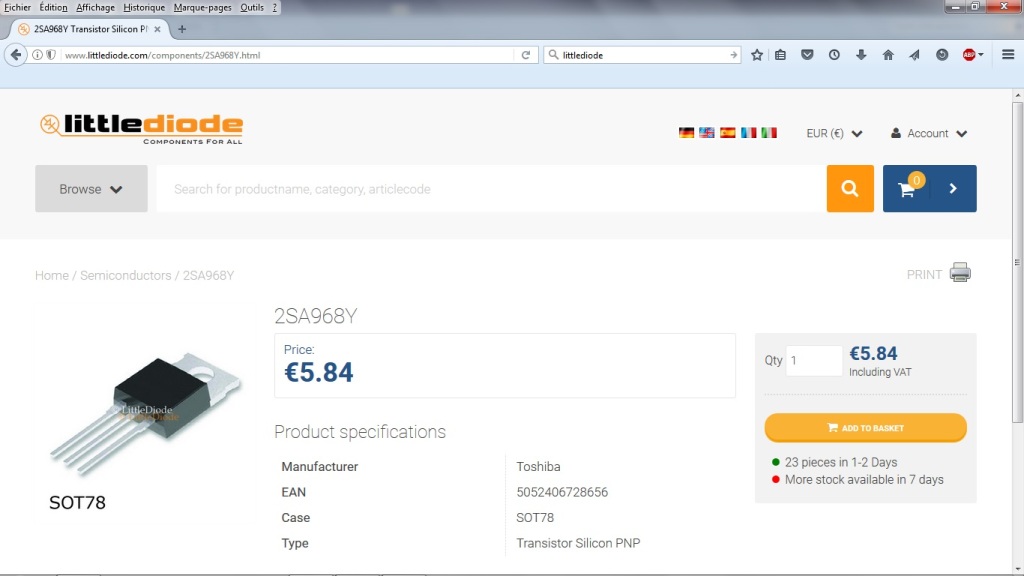

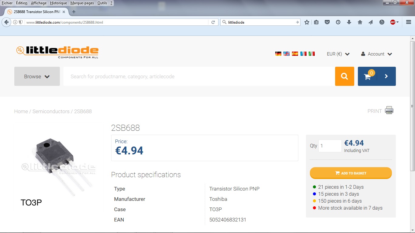

I've found (sell as) genuine power transistor Toshiba 2SD718/2SB688 and genuine drivers Toshiba 2SC2238/2SA968 in a provider based in UK named LittleDiode.

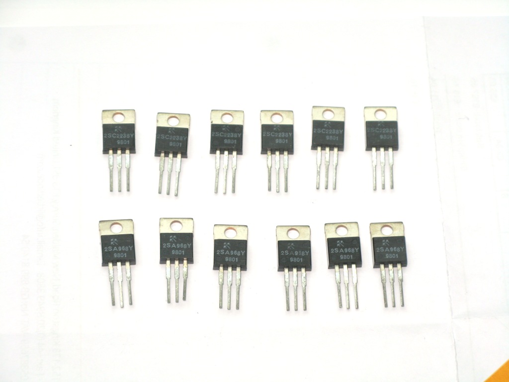

I paid 211 € for 36 genuine NOS Toshiba transistor and here are the pictures of what I received :

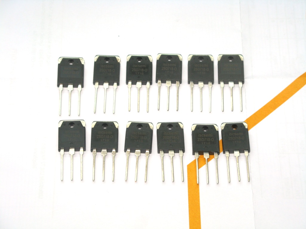

Only chinese copies ! ! ! This are not realy fakes but true fakes ! With my PEAK Atlas DCA75 transistor tester I'made a quick measurement of the Hfe of the 2SD718 and here you are : 60, 40, 42, 44, 35, 55, 53, 65, 39, 51, 60, 38. These transistors, with their -O suffix should have their Hfe between 80 and 160.
View attachment Transistor 2SD718 MOSPEC.pdf
Since I paid with PayPal I've asked to send back my delivery and LittleDiode had no choice but accept the return, I made this post to warn you against them. They clearly say on their website you will get genuine Toshiba semiconductors, and what you get is those ******** chinese copies out of specs - fakes indeed.
Since those refs doesn't exist anymore as NOS, I'll order True Toshiba pwr trans (2SC5200N/2SA1943N) and ON-Motorola drivers (MJE1530-31) withe serious dealers as Mouser or Digikey.
Next time don't waste your time and energy and avoid exotic provider as LittleDiode. they are swindlers !
