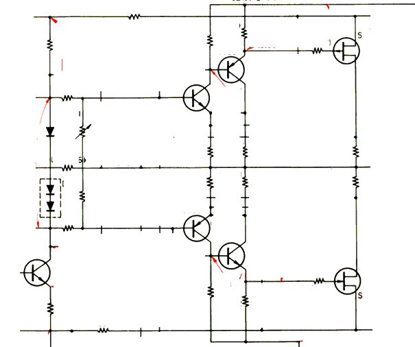

A striking resemblance with another variation of this output stage, with the V-fet output by Sony (4650), in clearified view.
At the same time, the output config is just different, but the scope is similar: one needs a high current capable collector or drain output stage to avoid this nasty switching. Done with modest components (2955/3055), 2W@8 is an achievement nonetheless.
Being Q3-Q5 & Q4-Q6 in a Sziklai mode, thermal coupling is on debate now!

In the schematic of post 1 no useful amp is described, because most
of the output power is wasted in R11 and R12. I suspect unpleasant
operation at high amplitude levels also.
The output as shown, without any feedback, has high output impedance,
it has current source character.
The comparison with the Sony amp, post 7, is not justified, have a look
at the wiring re ground and output.
Reactions: ejp
All true, but not the aim of the op. Nor the actual valid config.
FWIW you swapped the 2N3055 and 2N2955 in the final stage
