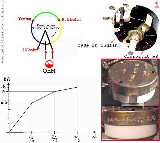

I am looking for the following, it is marked 5905-99-972-8299/ ABM 0675/ 10KOhmSpec5%.AB. They are from an Avo Valve Tester.
See attachment
See attachment
It is a standard 10 log pot (AB taper). Normally the resistance curve is drawn from the front of the pot, inverting the curve shown. E
