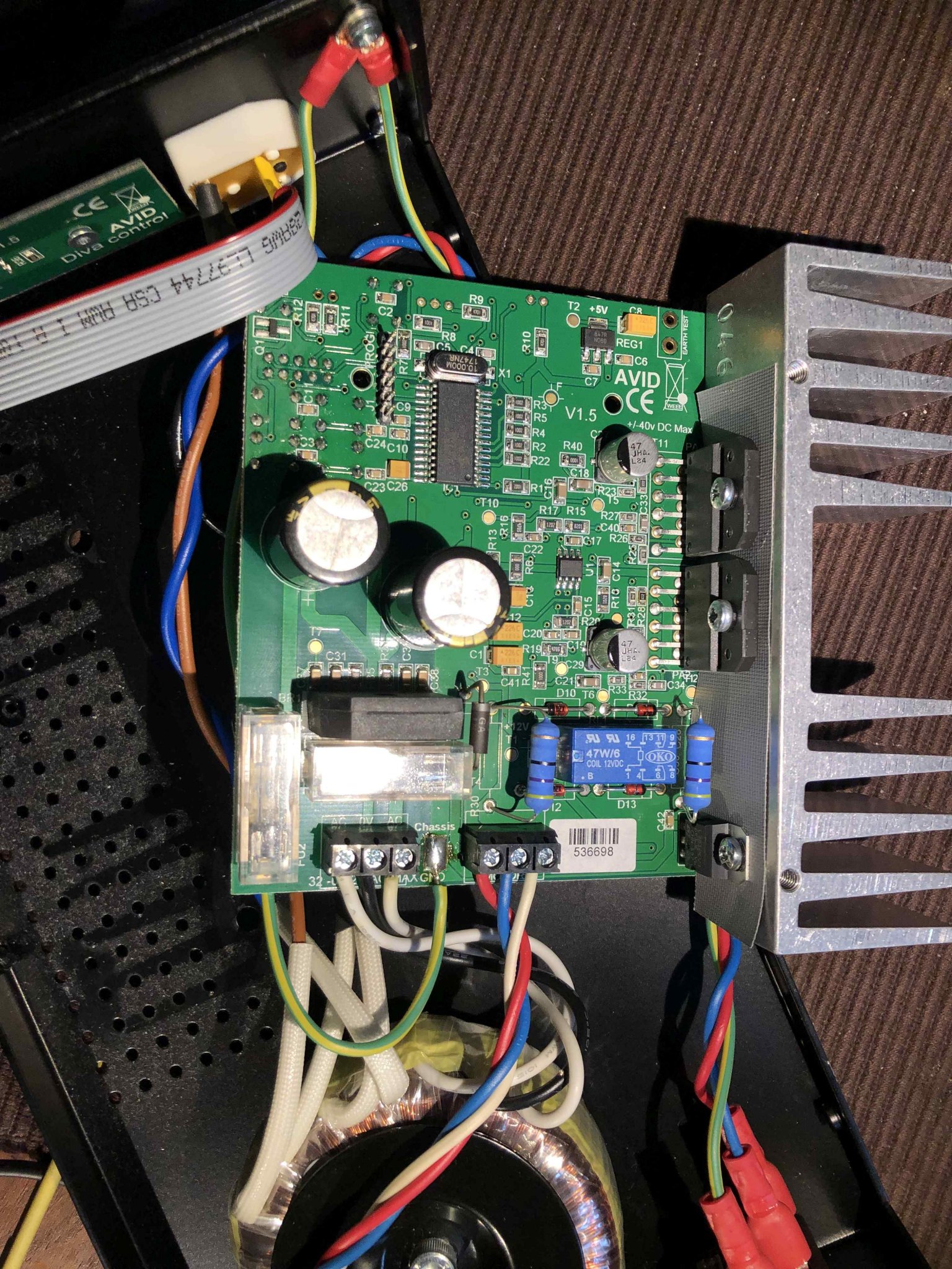

Avid Turntable repair info?
Does anyone have any Avid Turntable repair info??? I just repaired a Volvere and I need to know the value and speed rating (fast or slo blow) for the 2 fuses inside the power supply/speed controller unit. I have reached out to avid several times with no response so far.
My Diva II SP uses 2x T1A (=slow) inside. As I have 6 push buttons on top of the pcb it looks like mine is a different controller or revision.
