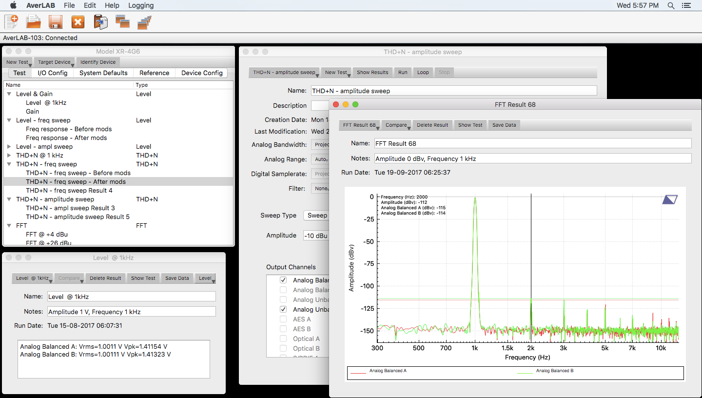

Sorry to see this happen, it looked like a great product well positioned between AP and QuantAsylum. Every time I checked though purchase avenues just weren't available. I don't recall it ever being available to Canadians for example.
Don't seem equivalent.
