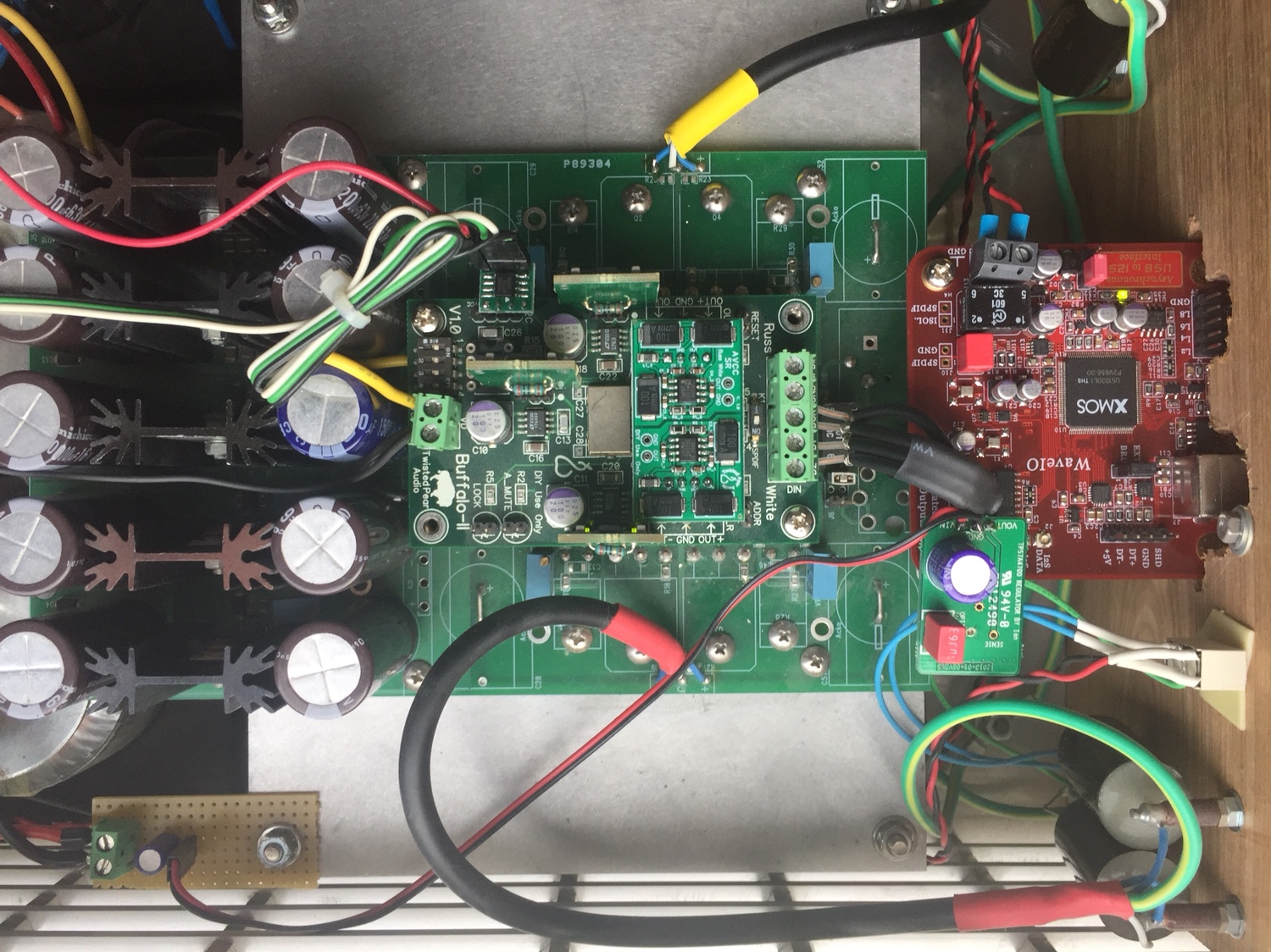

Nice! But we want to know how does it sound 😉 BTW, Why isolate, are I2C from Volumite picking noise or other noisy device?
I am using an Arduino to control the DAC, so I am not sure what noise could be added by I2C. It does not cost much to add isolation. (like 3$)
I did not really conduct an A/B test, but sound nice. I'll need more time for it.
