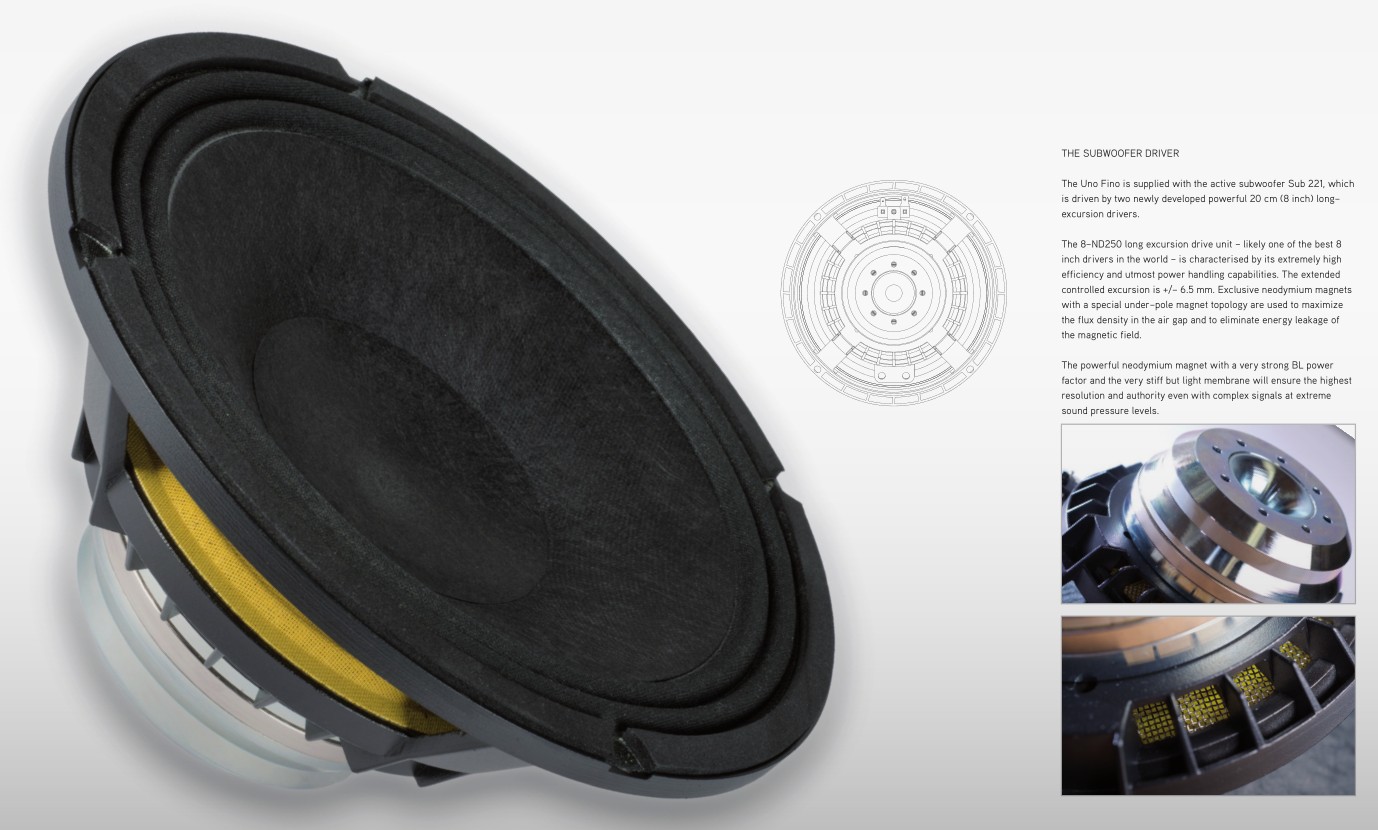

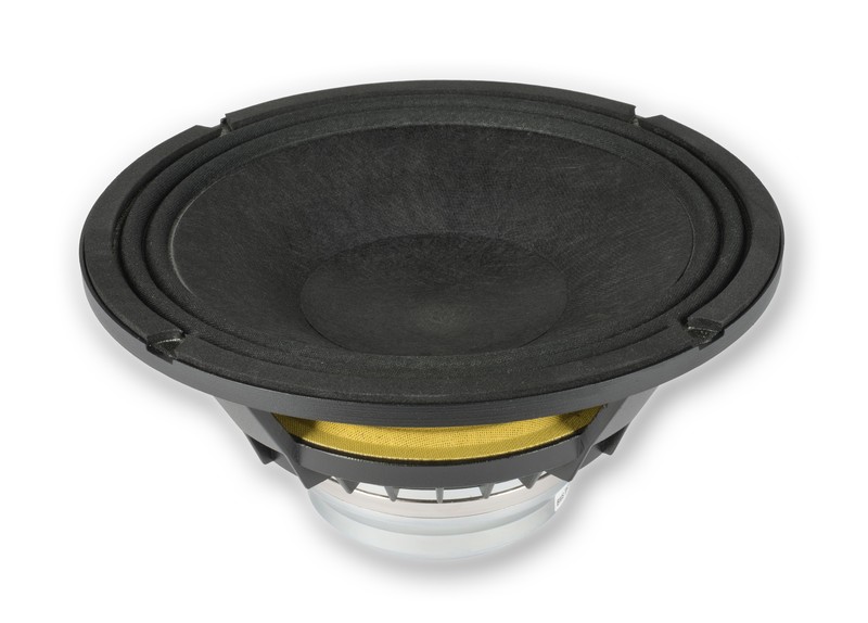

Avant-Garde uses horn-loaded cone midranges AFAIK. Some crossover points are made by using the acoustic rolloff solely.
The Uno seems to use 10" woofers, that they strangely call subwoofers. On one of the pictures one can see a Beyma driver. But they could be custom-made ones.
Regards
Charles
My bad. The cone/driver is similar to the BMS.😀

Once again thanks for all the replies, a lot to get my head around, read, and think about.
I have looked at the bms drivers, they seem like one of the best options. Bit pricey to get a set to Australia.
