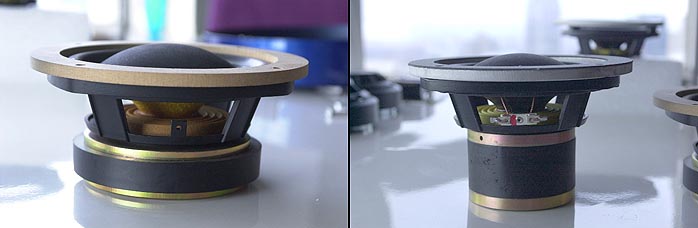

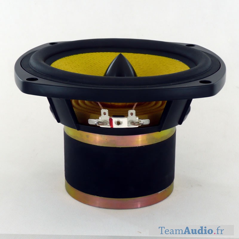

The Avantgarde midrange driver is a cone, not a dome.
See here the First and the Omega (16ohm) driver.
I'm agree, very look like Davis Acoustic, they are suppliers for many brands and makes on demand ! So I don't think it's the one you talk about but surely same substrate !
I'm asking myself the advantage of a cone-domed profil in a horn ?!
Their current catalog is more than 300 different units for OEM I believe !
Take close attention on details...same basket,same thickness,same terminal pins,same cone,same suspensions....
Remove the phase plug and put a big dustcap and done....
The advantage ?....maybe they choose this driver for linearity and soft suspensions....also the big horn can be shorter if is used this type "cone (domed)" ....probabily the low cutoff freq.

The TiCoNAl magnett seems to be the same and is surely outsourced (would like to know its Curry point, hoping to be better than the old ALtec which were fragil ein the time due to heat issues iirc!)
In the Avant Garde, the cone seems more to be their black woven carbon than the kevlar one ! The dome ??? Polypro I assume ! And yes seems glued !
The dome is also more linear than a cone shape ? with less break ups and a smoother roll off ? (better for a horn ?)

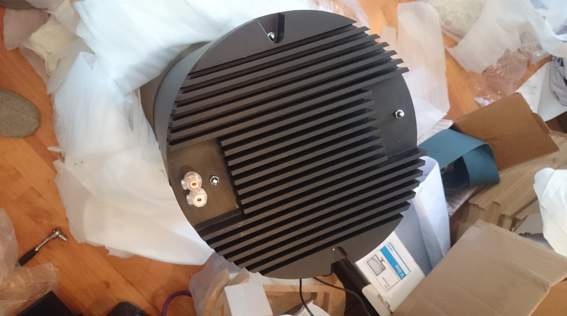

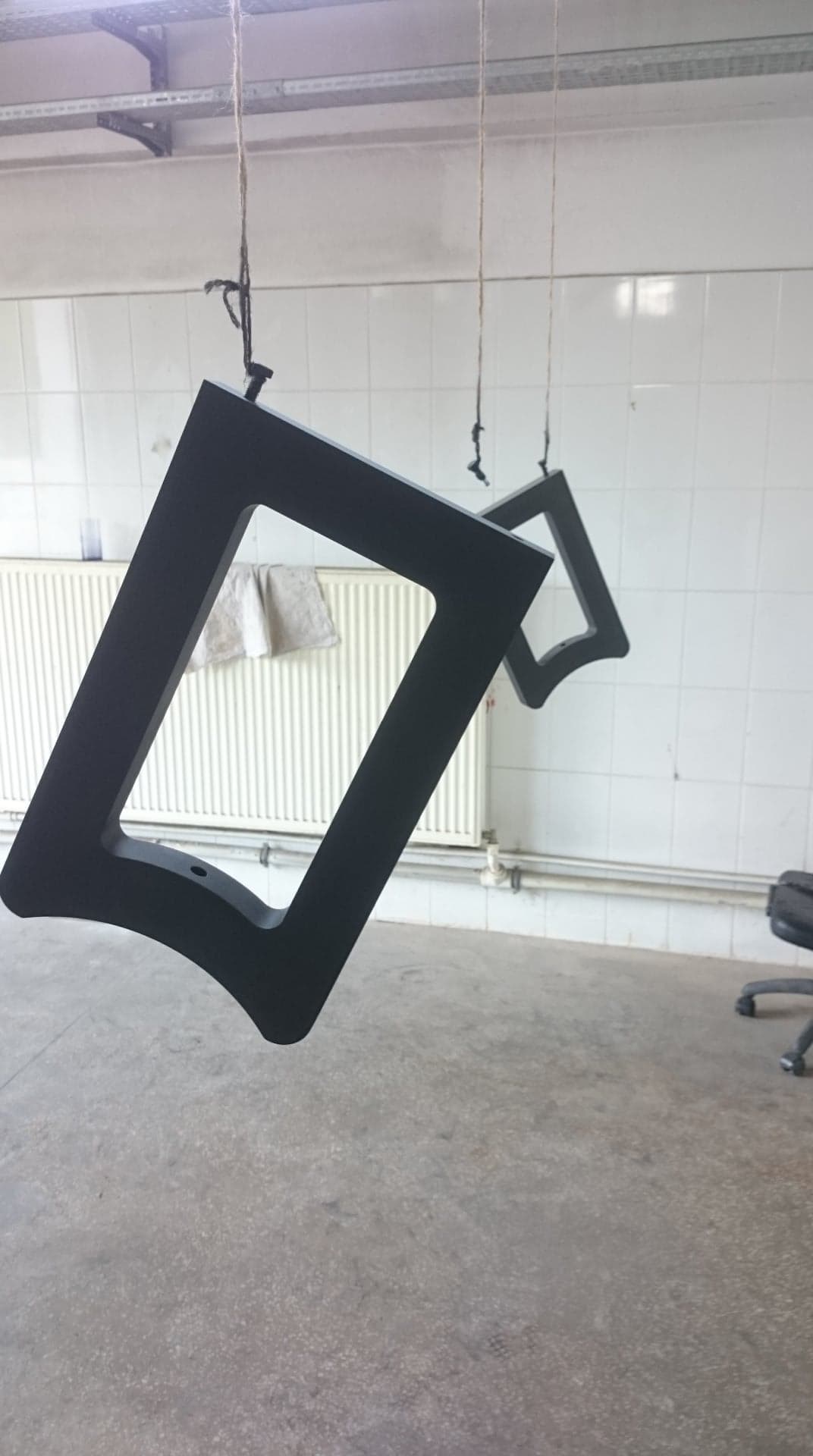

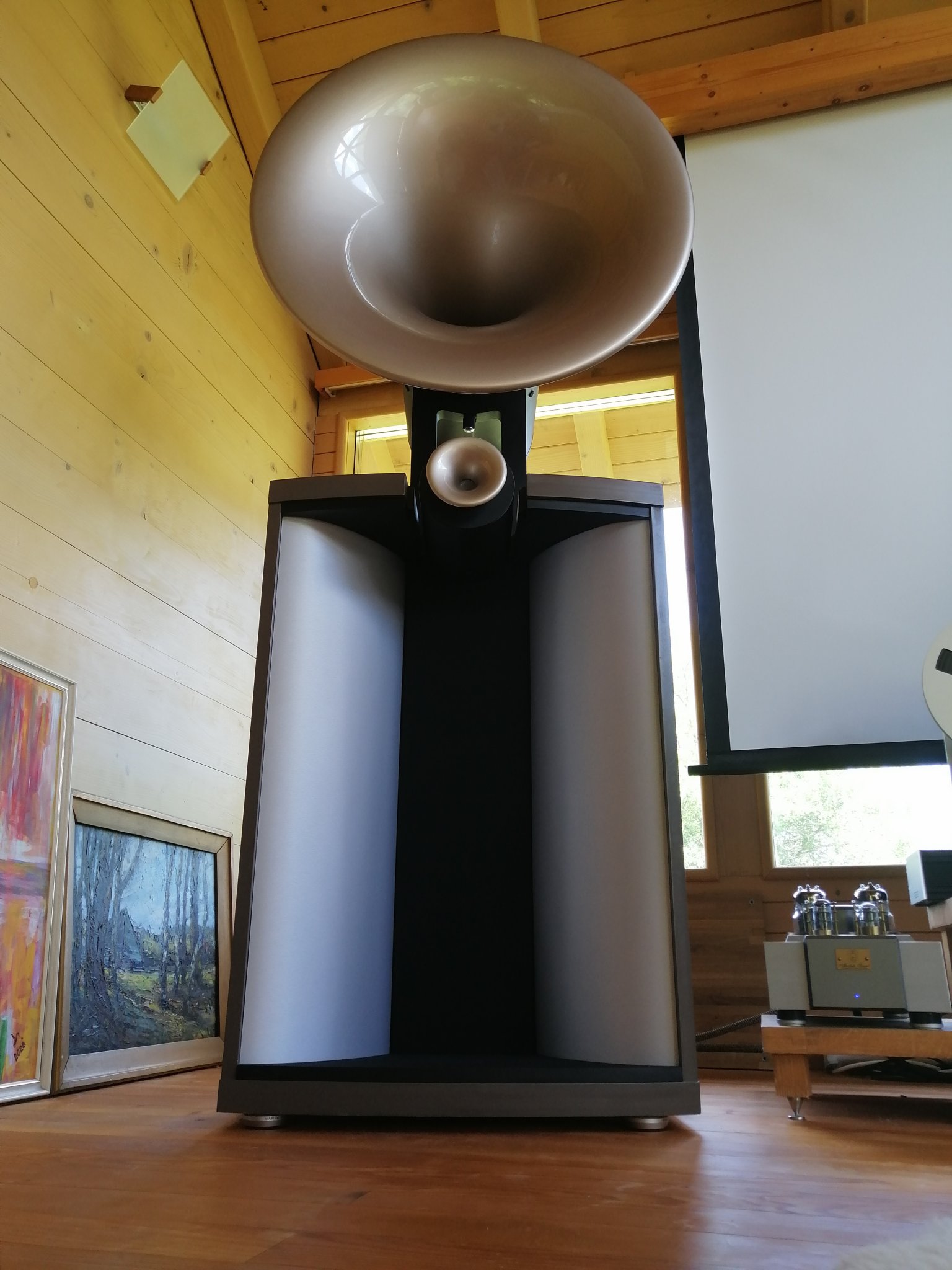

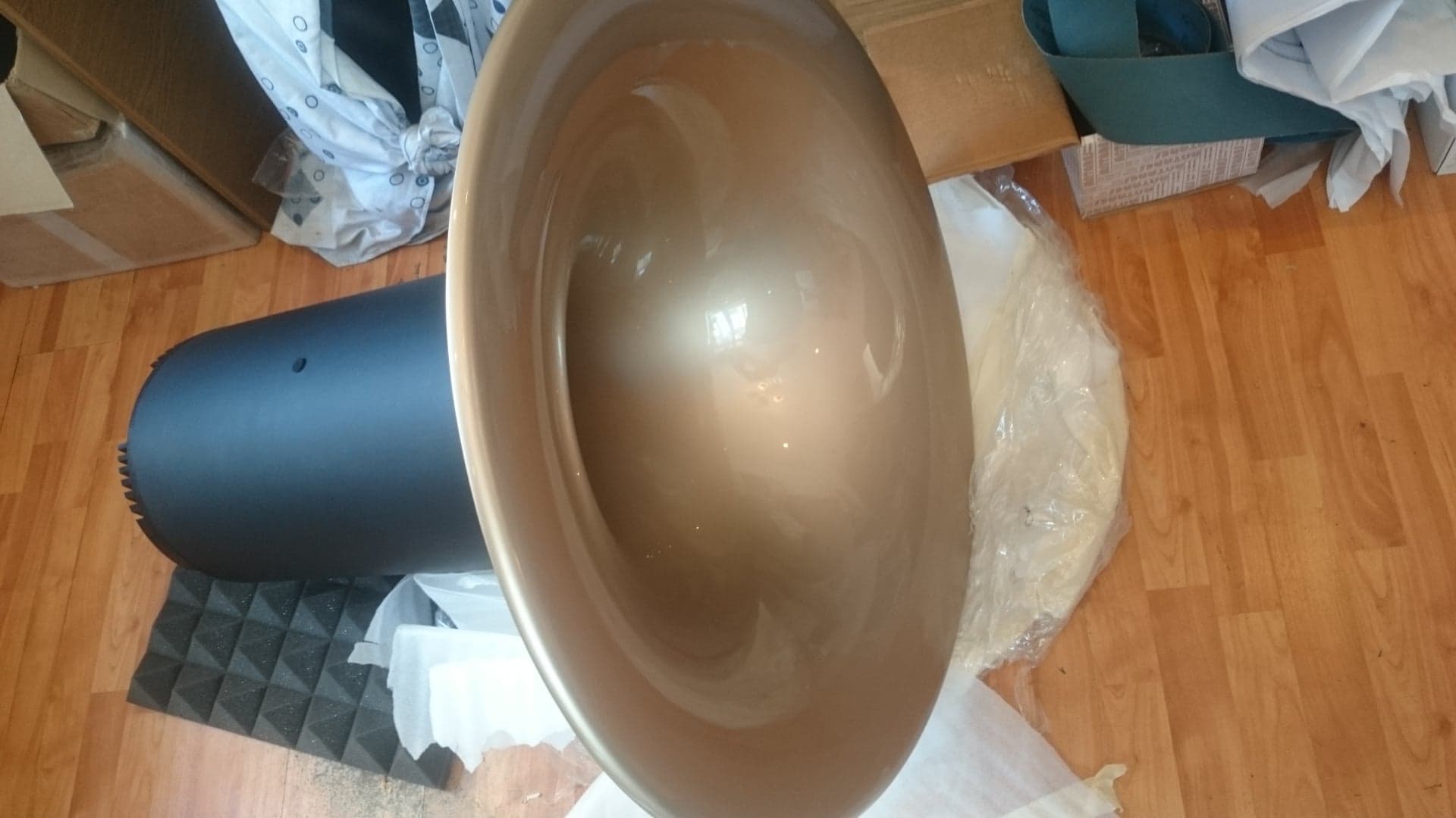

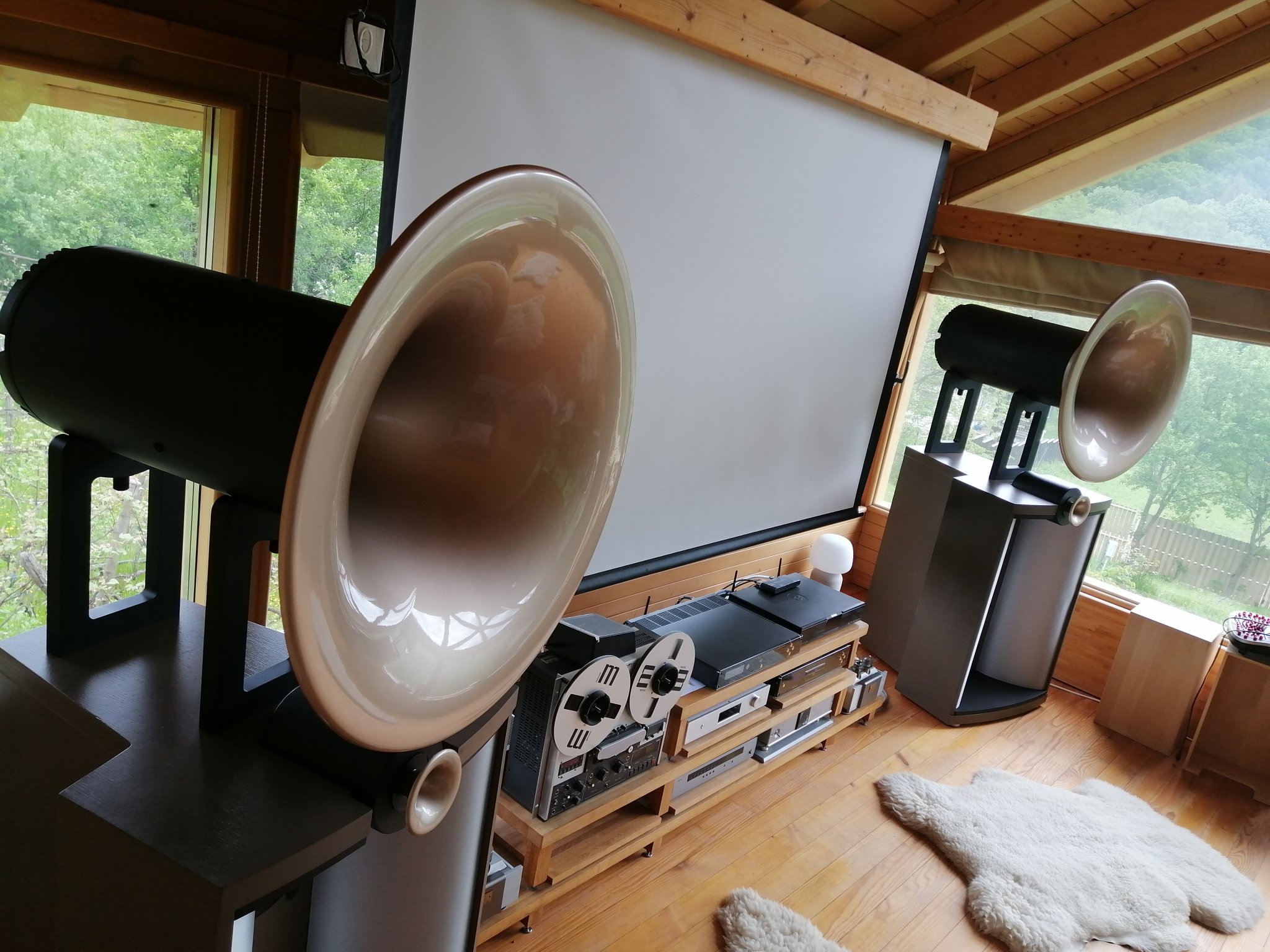

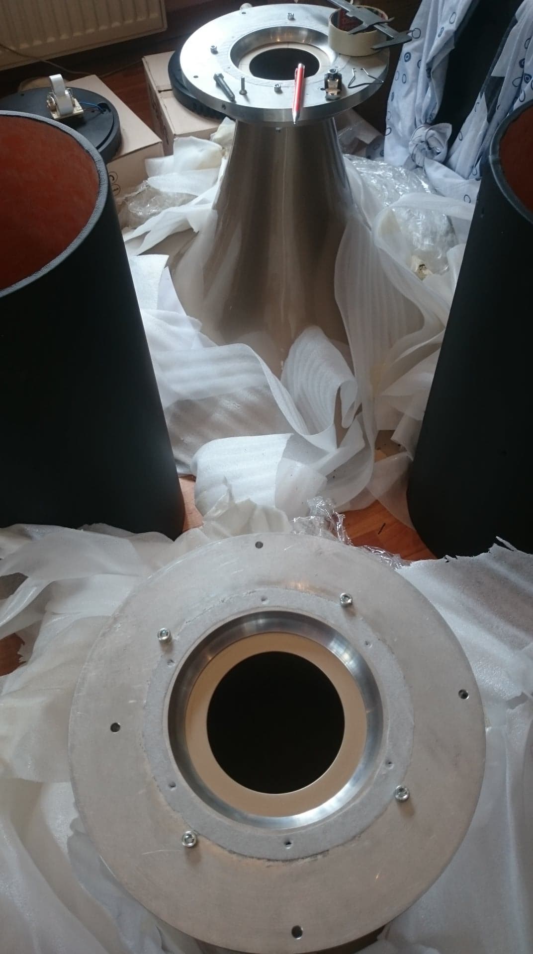

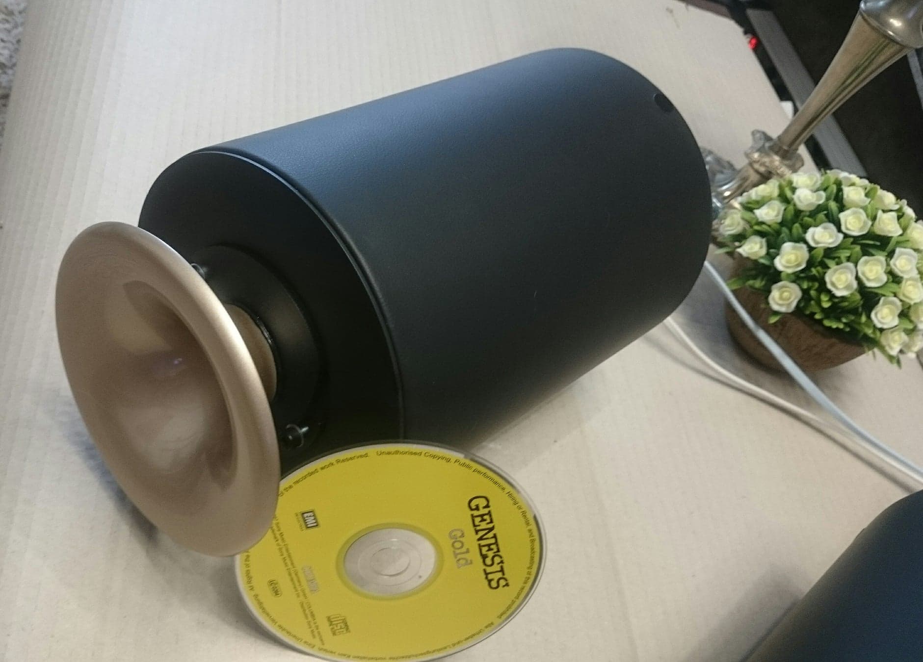

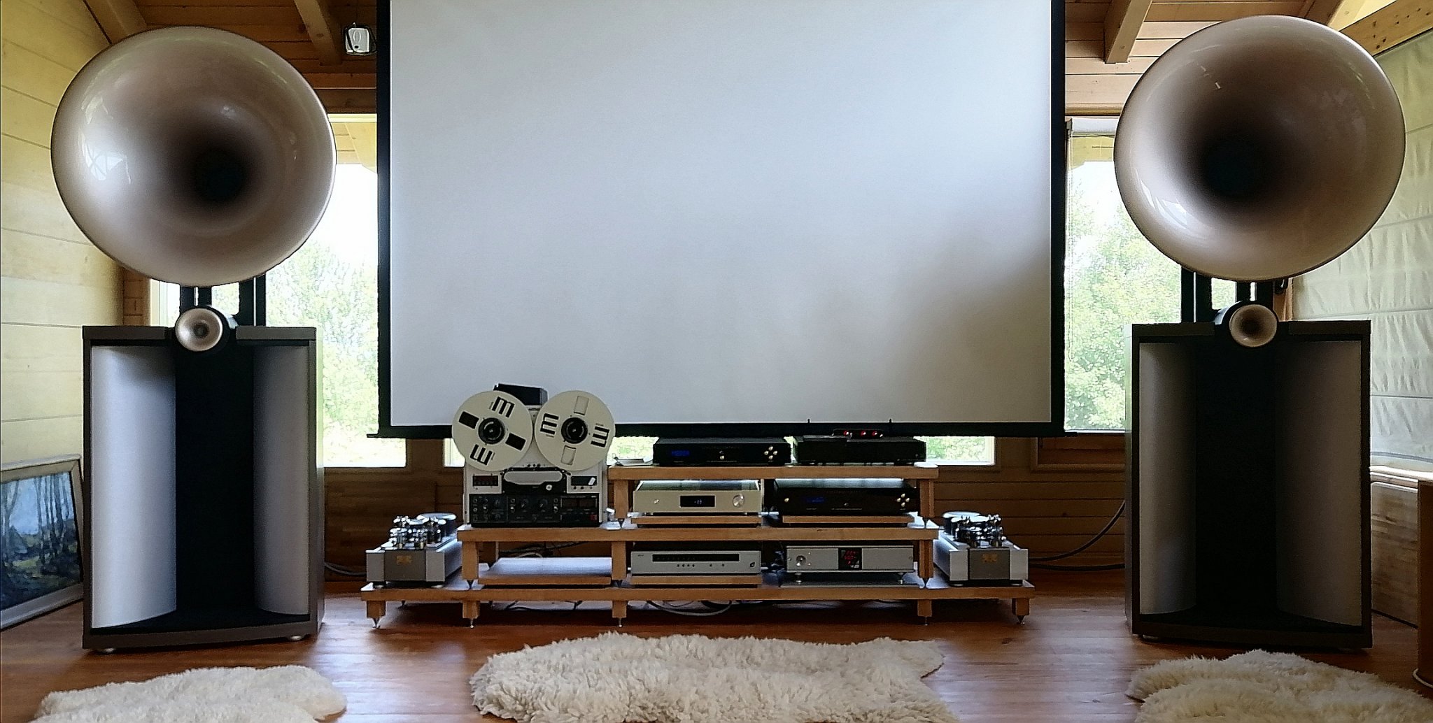

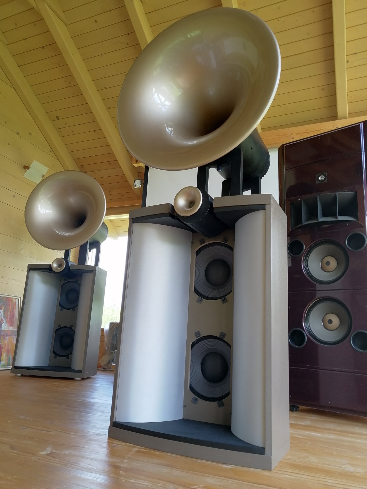

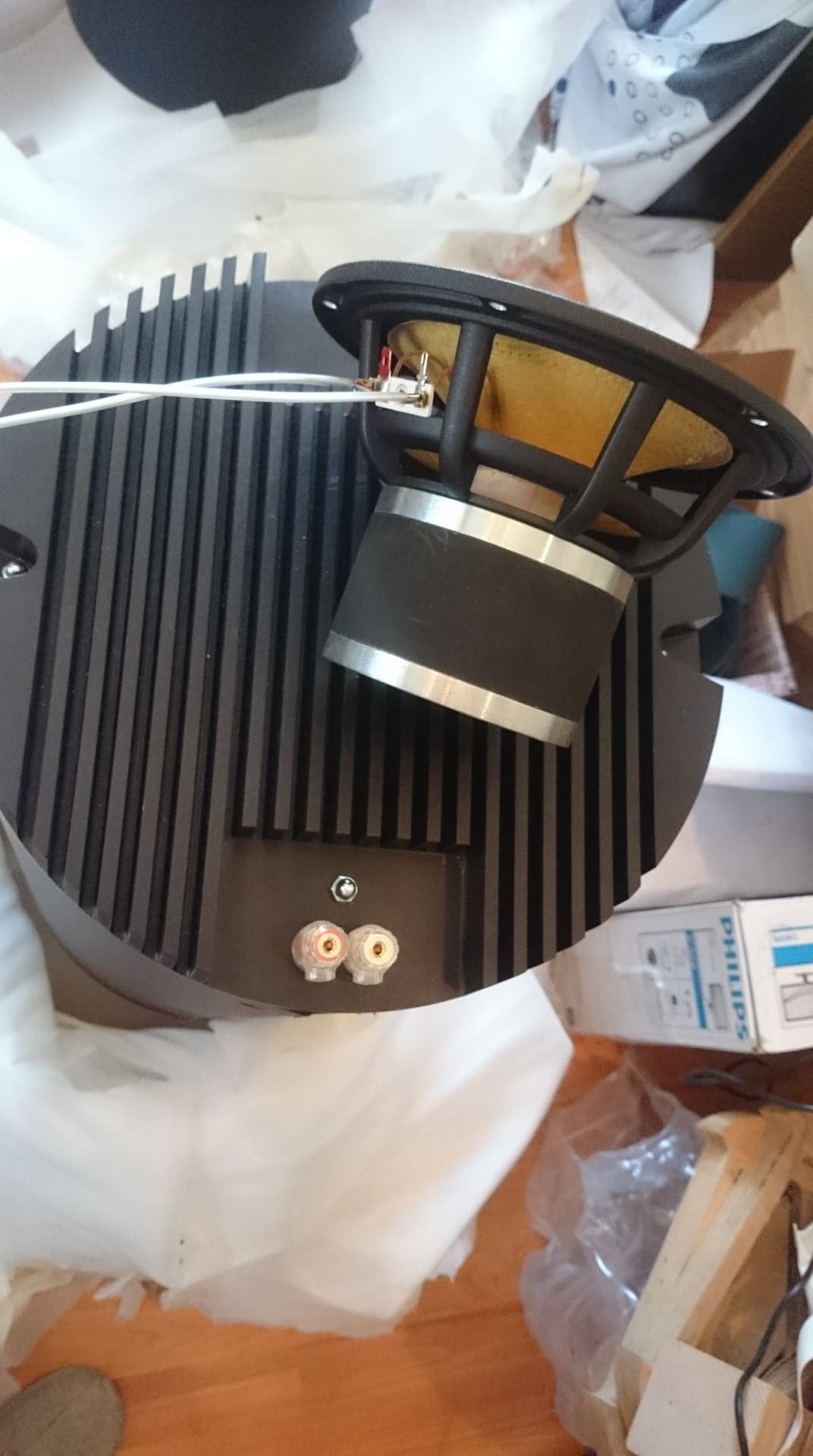

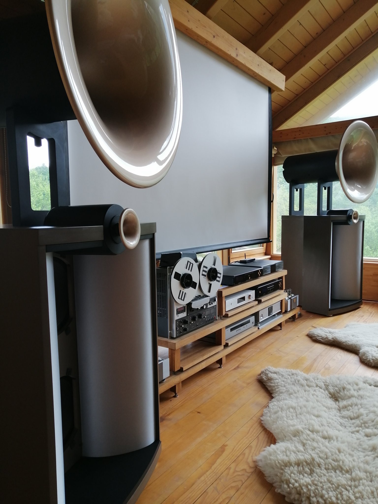

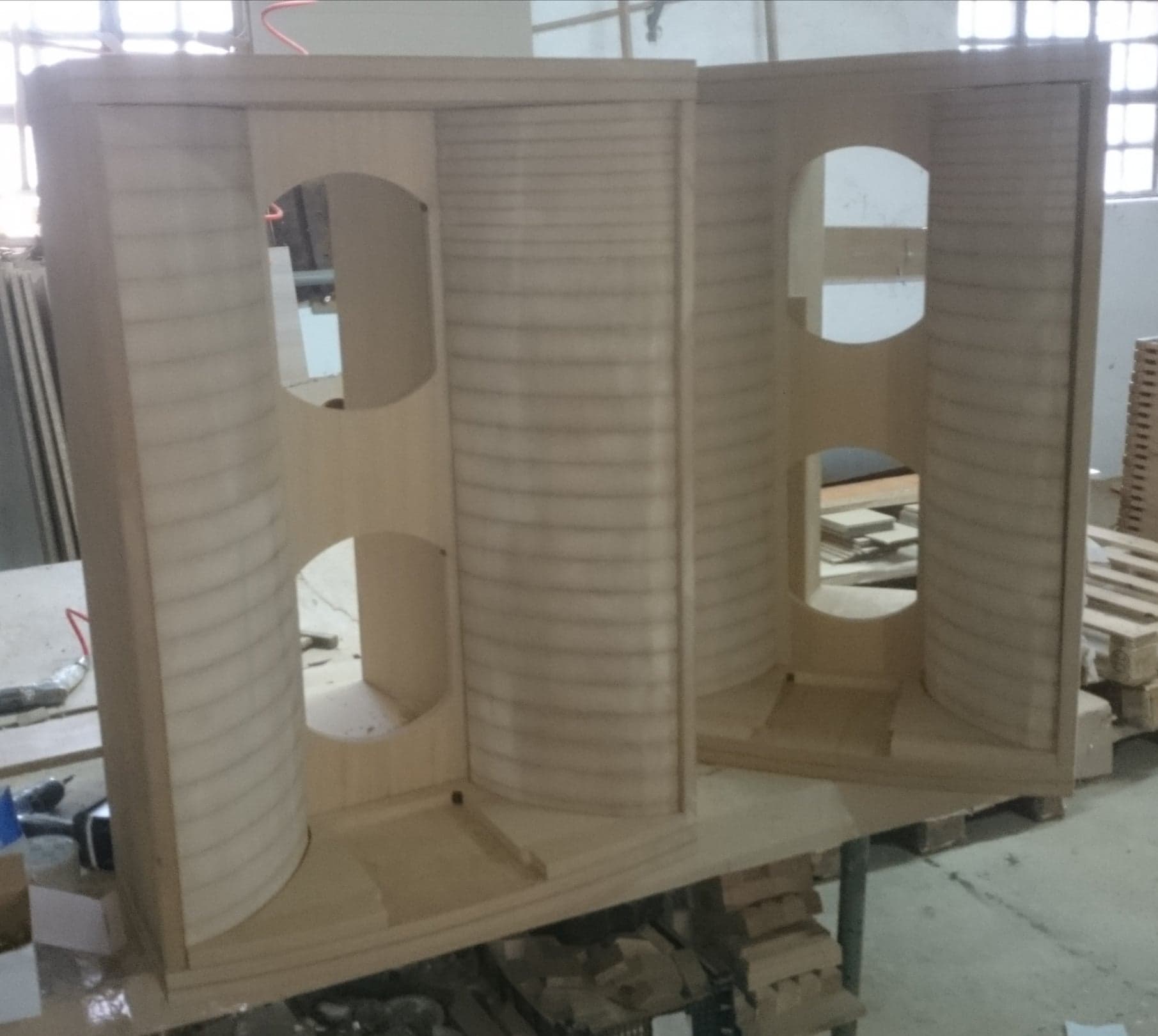

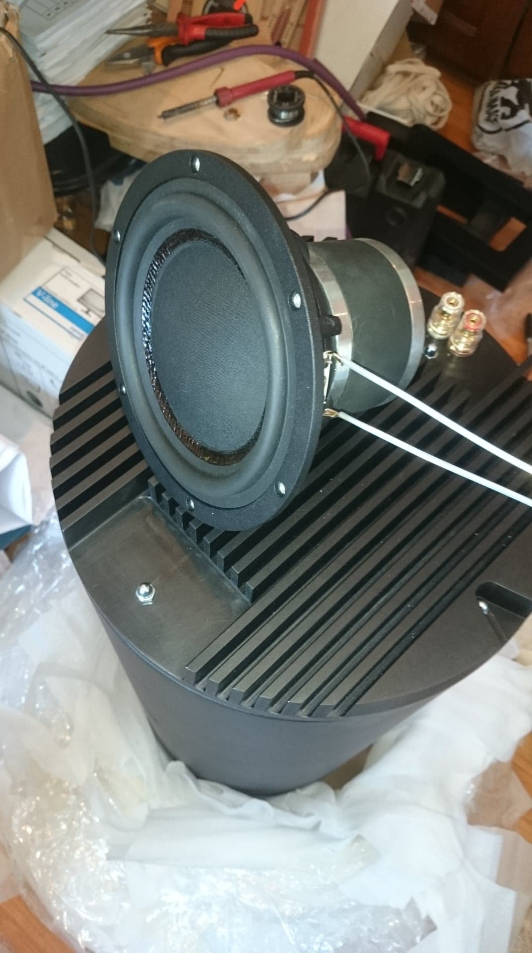

Avantgarde Duo Mezzo.....
Theese are the original components used in Avantgarde Duo Mezzo with a small difference at winding bobin of original Davis
-midrange.........Davis Acoustics 16TK6 V2
-tweeter.............Beyma CP380M
-Bass...................Beyma 12LX60.....2 units per side
-Active crossover with room correction is used only at bass
Here's mine.....

My stock Duos look to have the 16GKLV6 midrange drivers and the tweeter seems to be a Beymer CP350 (thanks @felixx for the point in the right direction).
The Beymer CP350 is discontinued so I assume Avantgarde started to use the CP380 in the “omega” version of the upgrade.
As one of my tweeters (believed to be the CP350) is sounding a little “off” I am thinking of replacing both with the CP380. Looking at the specs these do seem a bit more sensitive so not sure if this would have a significant negative impact on the voicing.
This has made me think about also upgrading the midrange drivers to the 16TK6 V2 and I guess these pair more nicely with the CP380 like the original omega upgrades that Avantgarde sold back in the day.
What is confusing me is the drivers Avantgarde used for the omega upgrade pack seem to be 16ohm.
Maybe I need to give it some more thought although I’m excited about making some tweaks!
Those 12LX60 look like the v2 version with that large dustcap. Are they used in a closed box in this speaker ? And where is the crossover frequency to the mid ?
Regards
Charles
My subwoofers are powered and have a variable crossover frequency which is set at about 170Hz. The midrange driver has no crossover and covers from 170-2000Hz (approx). The tweeter horn has a crossover which I think is two 2.2uf caps in parallel and an inductor (can’t remember the valve but have it written somewhere).
