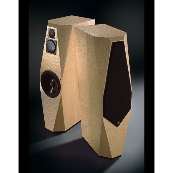

I own a pair of AVALON EIDOLON speakers ( 87dB ).
I doubt to associate the speakers with : XA 100.5 ; XA 160.5 or X 600.5.
Considering your Knowledge and experience wth this combinations AVALON / PASS ; can you tell me in your opinion , wich is the best option to join with my EIDOLONS.??
I think, you mean the speaker from the first jpg attachement.
It is very difficult to achieve satisfactory acoustical results, particulary in the midrange and the high frequency aera.
I think that the resulting distortion spectrum from those of the most amplifier topologies (especially Class AB with idle currents between 20mA and 50mA through the buffer output stages) and that of ceramic diaphragms (ceramic cones resp. dome)
is very unfavorable for satisfactory music reproduction.

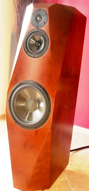

Less critical in order to the quality of the perception sound quality is a diapraghm stuff consist of non ceramic and metal, like by a clone of this model - go to the second attachement and go to
Avalon Clone, Projekte der Nutzer / Nachbauten - HIFI-FORUM
For this reason I hate cones made of ceramic, magnesium and metal like titan and aluminium.
