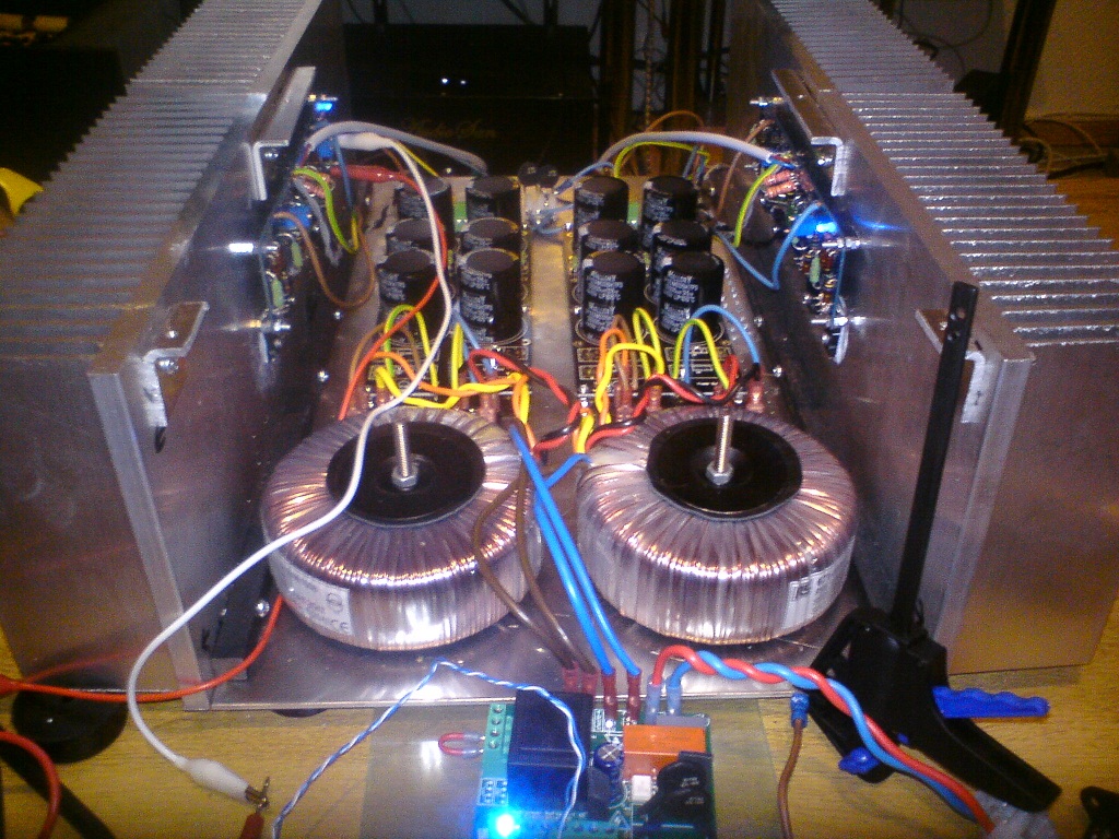

yes🙂 F5 dual mono with this boards. but with external dual bridges.
Nice looking amp 🙂yes🙂 F5 dual mono with this boards. but with external dual bridges.
What transformers have you used for that, and also - any reason you didn't do the rectification on the PSU boards - simply to use the case as a heat sink?
Nice looking amp 🙂
it is 2*18V 225VA RS transformers.
the reason for external bridges, was to get dual bridges. and to make sure they get the cooling they need.
