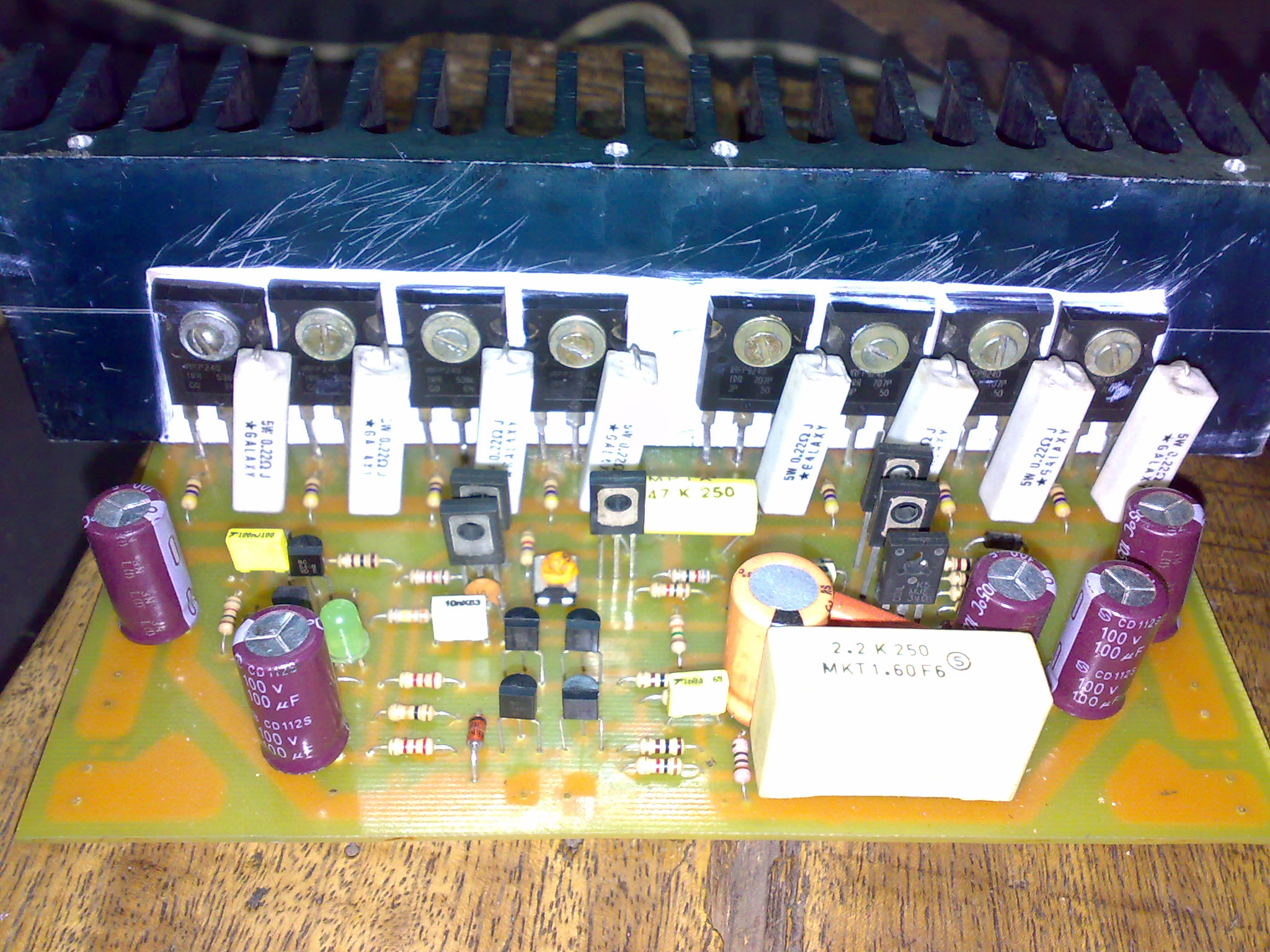

u r corrcet. but 5w risistor and power mosfet mount up or down, so i create manual easy to mount mosfet and resistors.
this is a LAY file....

hi this is a LAY file..
i test av400 amp yesterday.. work fine..
but low frequency not fine an remove resistor R35 R36 47ohms to 100ohms
and C12 100nf to .47uf 250v. work fine
test power supply -+25v tomorrow will finish.

I finished av400 amp but tr is above 6amp and tr is when power on bom!! Vibration ... I had sch for soft start but this below 5amp.. please good sch for softstart with 24v relay. power sup 50.0.50 650va.
http://www.diyaudio.com/forums/solid-state/191094-build-new-av800-av1000-mosfet-amp-irfp240-irfp9240.html#post2610656and i started new av800 amplifier
