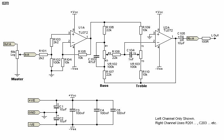

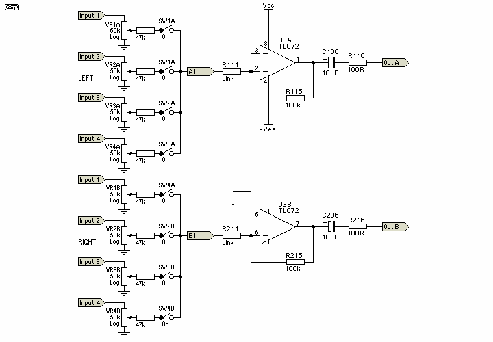

Aux send Circuit
I suppose you’re not going to have an aux return on each channel, but only an aux send on each channel and one common aux return? Is it an fx send and return your looking for?
Would you like a pre / post fader selector switch?
If you post the rest of the schematic it would be a lot easier to suggest something.
Hi I cant get into my laptop at the momment due to a doger charger but its a basic virtual earth mixer almost identical to the one I provided
hi yes your right one common return but no pre fader switch required i cant get into my laptop at the momment due to a doger charger however my circuit is nearly identical to the one i provided
