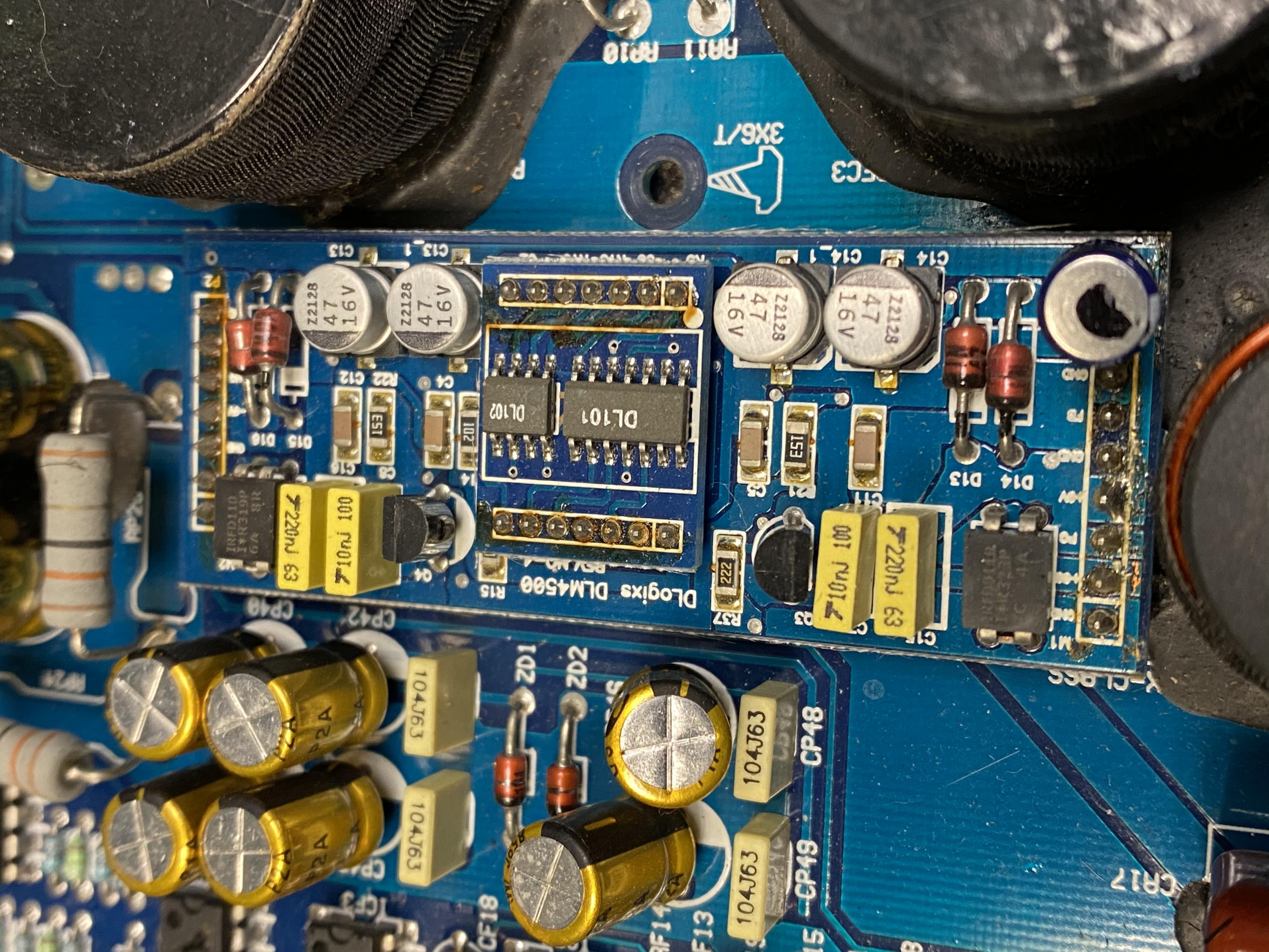

C caraudioguy2100 Member Joined 2010 2021-01-24 8:41 pm #1 2021-01-24 8:41 pm #1 Do these amps take IRF640/9640 or all 640’s ? Attachments 5F2CA0DF-A09C-4851-98DC-6DDE0EE2C47D.jpg 1.1 MB · Views: 104 P Perry Babin Member Joined 2003 bcae1.com 2021-01-24 9:00 pm #2 2021-01-24 9:00 pm #2 4 N-channel FETs 5 P-channel FETs C caraudioguy2100 Member Joined 2010 2021-01-24 9:36 pm #3 2021-01-24 9:36 pm #3 Amp will power up and idle fine without the outputs in the amp . If I put the 9640’s in the amp it draws excessive current. Are the IRFD9110 the driver ic’s ? Attachments 470B7C46-ADB4-4E01-A13E-19ECBA57EC11.jpg 1 MB · Views: 116 P Perry Babin Member Joined 2003 bcae1.com 2021-01-24 9:54 pm #4 2021-01-24 9:54 pm #4 No. See the diagram on the following page: Again with the Dlogixs DLM4500 You must log in or register to reply here. Share: Facebook X (Twitter) LinkedIn Reddit Pinterest Tumblr WhatsApp Email Link
