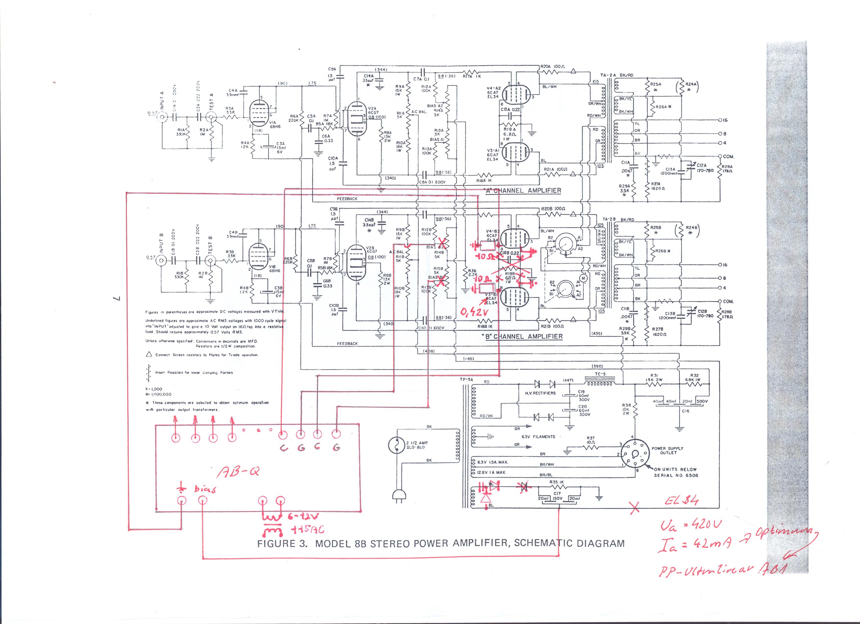

Okay, bought one of these boards from a gentleman in the Czech Republic. He sells them on eBay under the user name (Kotra). Not absolutely sure of the spelling of that name, but anyway, a search on eBay under AB-Q for four tubes will most likely return the item. All I can say is, this board is excellent!
I bought it to install in my Marantz 8B. While I can't say if it is a ripp-off of the Tent Labs unit, as some have suggested here, I can say it is much less expensive and way less bulky.

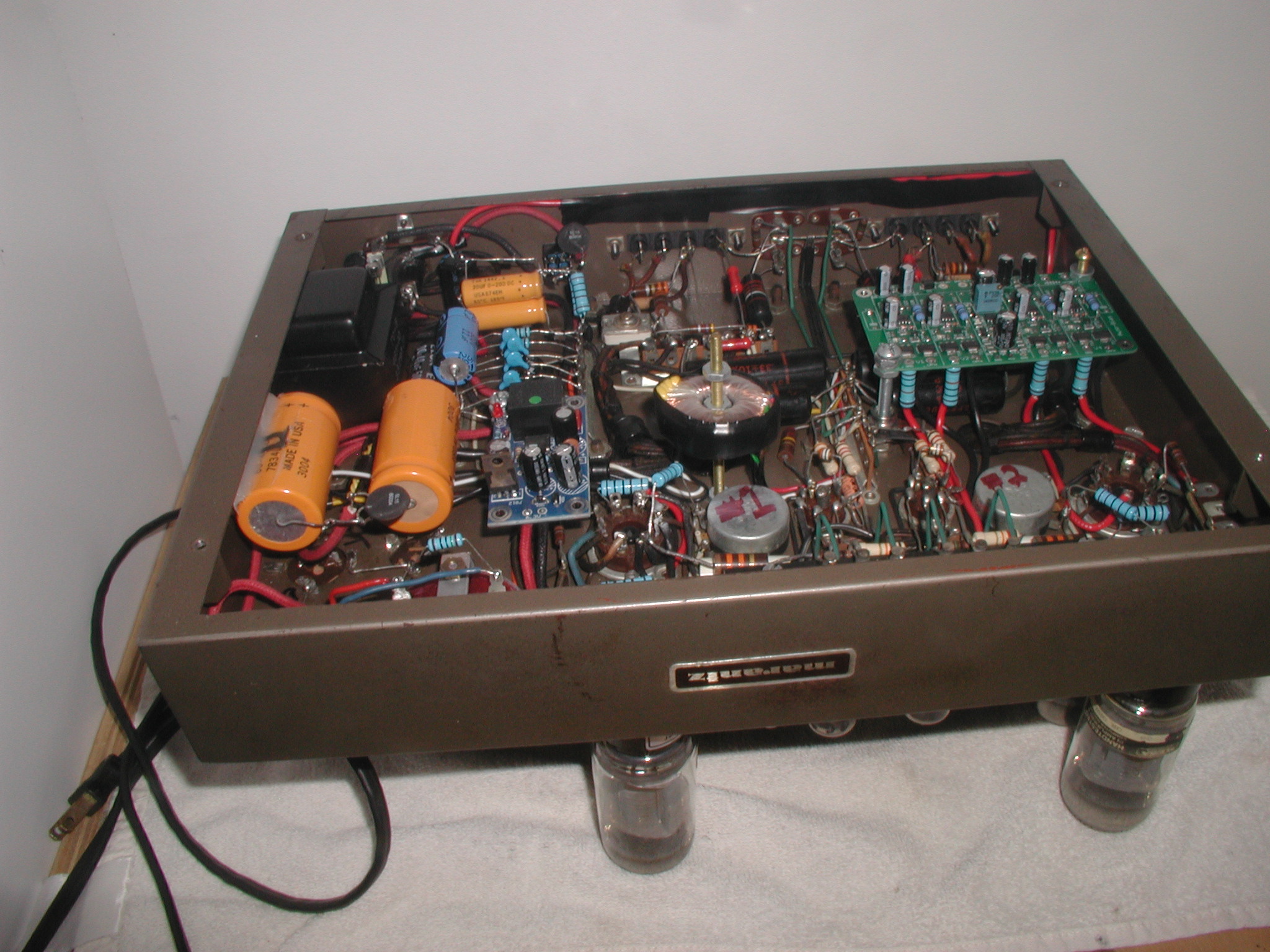

My Marantz 8B has very limited space, and even with stand-offs that elevate the board above other components in the amp, there is still plenty of room to install this board. The Tent Labs board would absolutely not work under any circumstance in an 8B. Inaddition, the board looks absolutely great installed in the amp. Why did I buy this board? Well let me see if I can explain.

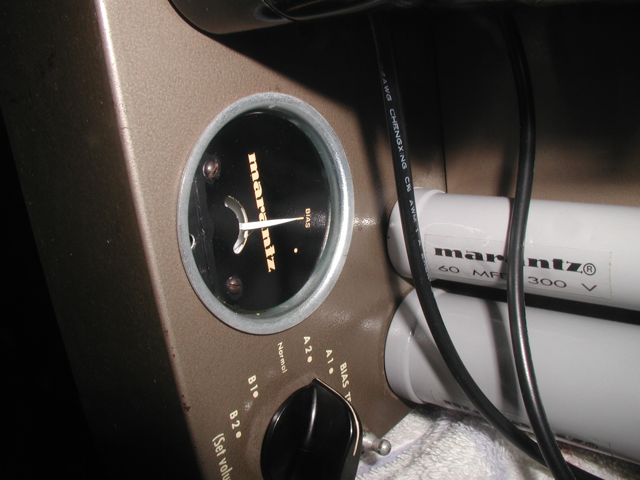

When using my 8B, which has individual bias pots for each EL-34 tube, I got very annoyed having to often reset the bias. Often, when I turned on the amp and biased it, 15 minutes later the bias would be off. I also would keep the amp on days and weeks at a time as I have music constantly playing in the back round and for discreet listening moments. I would check the bias habitually, and it often needed to be readjusted: Not much, but it was often somewhat off.

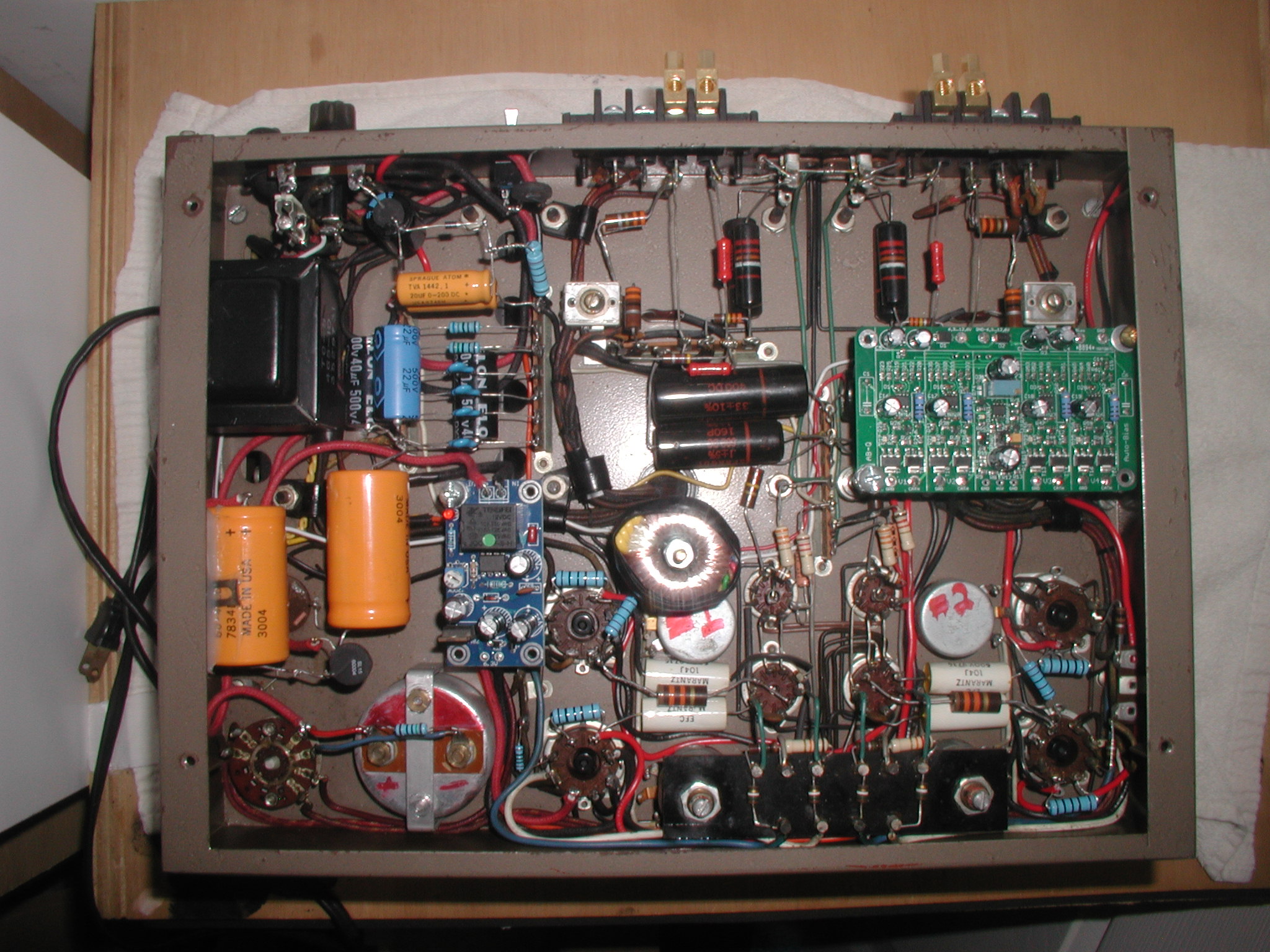

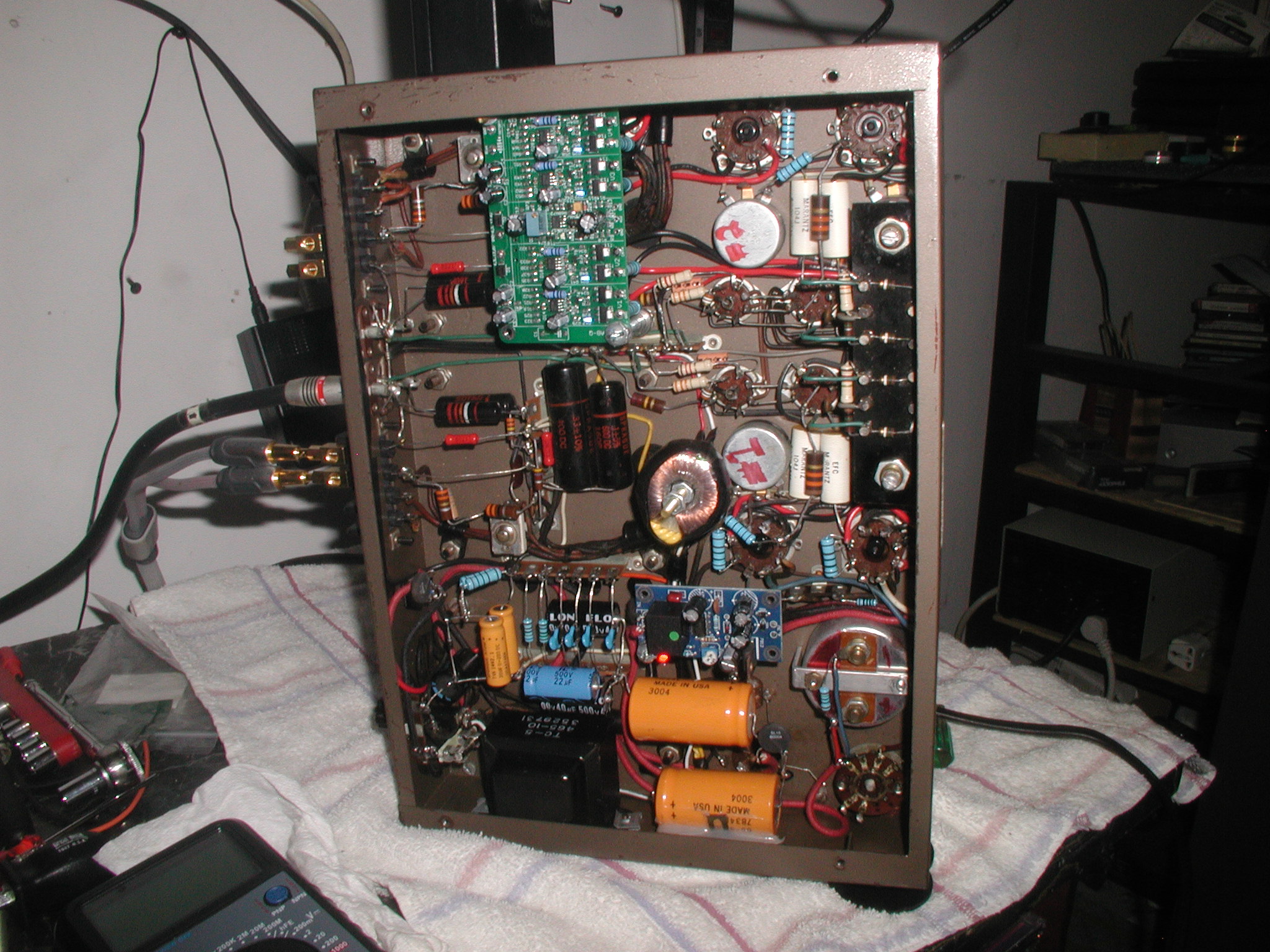

So, I bought the board, and in very little time I installed it. If you read his information regarding powering the board, I had both options he mentions available to me. I ultimately choose to install a tiny toroidal transformer to provide the 6.3Vac to power the board. The reason for this was that I had already installed a small, small B+ voltage delay/slow ramp-up board into the amp which uses 6.3Vac from the filament winding of the amp's power transformer. There was really no reason for using the small, small toroidal since the Marantz's filament winding is vigorous and would not be taxed at all by the small millamp(mA) current requirements of both of these board together, but I just chose to use the separate toroidal because I did not want anything else on the filament winding of the power transformer. It was psychological actually, and besides, it looked cool. Well to the chase now.
The board works flawlessly: I have the amp on days at a time, some times a week or two at a time, and the bias is always spot on as confirmed by the amp's bias meter. It absolutely does not vary, ever! The sound quality was also improved is all aspects, from the lows to the highs, especially the highs. Though the improvement to the high may also be attributable, in part, to certain modification I did on my Marantz model 7 preamp. More about that later. Further, the beauty of the AB-Q auto bias board is also in the fact that the reference voltage set by the trim-pot on the board, depending upon the type of tube used, I use 6L6s and EL34s in the amp, always sets the bias meter's needle exactly to the bias point marked on the Marantz 8B's bias meter even though the reference voltage requirement for the two types of tubes is different.
