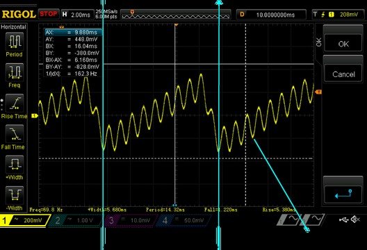

The capture of the cathode current is the same as Guido Tent. Measurement section for each tube measures the actual current around a very small window around the bias hence is not affected by any music signal (Guido Tent). The wiring diagram was on the Internet. When setting, the cathode current of one tube is measured. The current of the other three tubes is set automatically.
The setting is to measure the cathode current of one tube. The current of the other three pipes is set automatically. The signal on the grid tube has no effect on the setting. An audio signal may or may not be. However, it is good to check the signal at the output of the amplifier, such as an oscilloscope. However, the module is correctly set even without the oscilloscope.

From what I see, it is measuring cathode current across a 10 Ohm resistor, limited by 0.6V Si diodes. So the measurement interval is 0 to 60 mA. There is no actual grid signal input to determine the AC drive zero crossing. So it must be operating off the cathode current alone.
Tubes have a variation of gm with current, at 0 current they will have 0 gm. Instead of the rectangular integration expected from a linear amplifying device (with constant gm), you get a triangular integration from the gm non-linearity. The integrator output will vary the bias V until the triangle has equal area above and below the (new dynamic) DC set point. So it controls the bias V to get the average DC cathode current (with AC signal applied within the limited range) at about 25 mA.
So setting the unit up for 30 mA DC idle with no AC signal applied, will see a drop to 25 mA when AC signal is added. A long integration time will keep things more stable by averaging over the signal variation effects.
right ???
To do this more correctly, as Wavebourn mentioned in the DIYaudio link above, one would need a sample and hold function and the AC coupled grid drive signal input to determine the AC zero crossings to trigger the sample and hold.

The image is from the output of the GRD module.

Looking at your posted waveform, I had imagined that the audio signal would produce some 2nd harmonic of itself in the correction waveform, from the Asymmetric tube gm around the current set point. But I don't see any obvious effect in the waveform. Is this a non effect? (and so no bias current drift between no AC or quiet and AC audio present?) In which case the scheme must be quite stable at holding the idle current. ( I was conjuring up compensation schemes for the gm variation..., like altering one of the limit diodes slightly by mis-match of Vf or adding a series Schottky diode)
