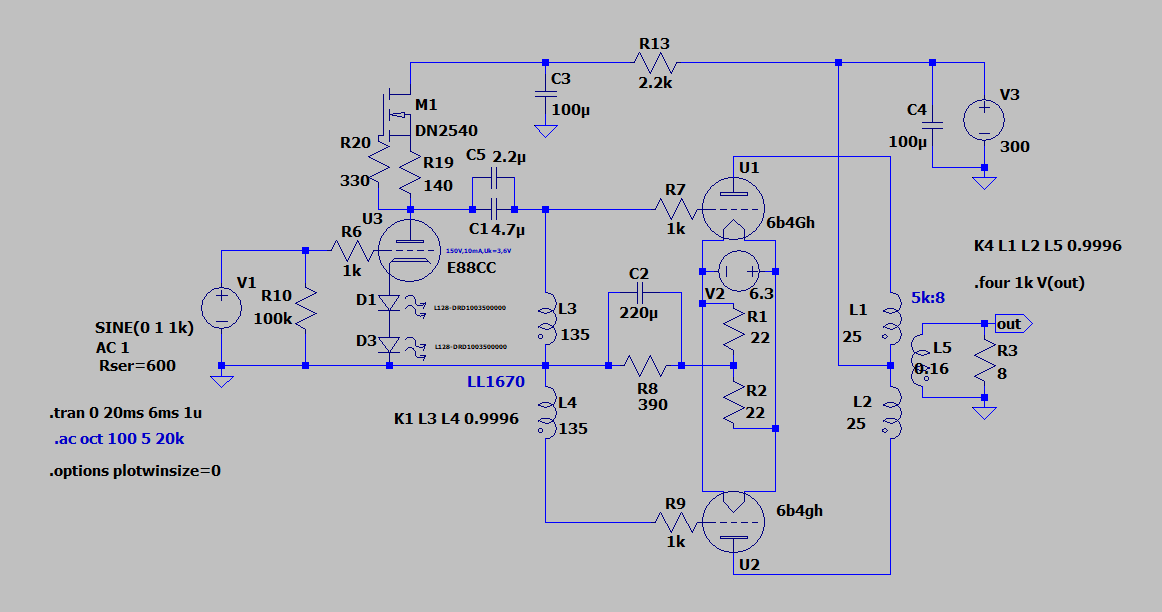

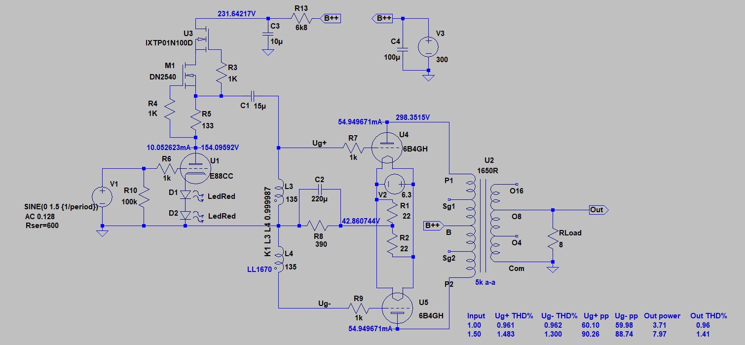

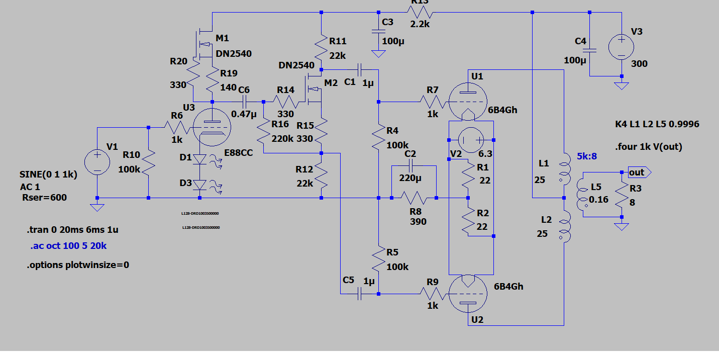

Which one would you go for, in these close to identical circuits? One with LL autoformer and the other with an AC-coupled 1:1+1 transformer. I am only interested in AC-coupling, ie no DC through the primary. Not sure of LL transformer to choose, capable of handling the high signal voltage? Circuit will work between 300Hz and 4kHz.

Great to hear this from someone who actually tried LL1670 in this configuration. I guess you removed C2 to enhance balance? Did you notice any big improvements when doing so. What driver did you use? Have E88CC, 5842, 6C45 and a few others in my stash. Might save the E280F for a SE working from 300 and up with horns. The PP is for 414-8E in closed or reflex from 60Hz.

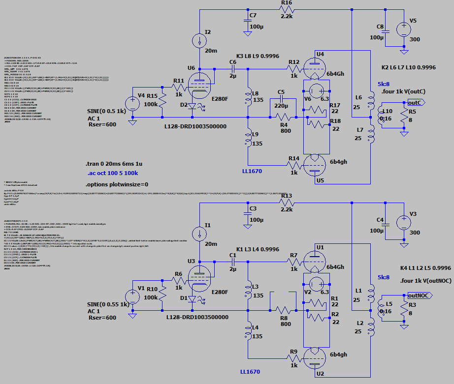

Another option might be to consider using the transformer to split phase at the input. Admittedly you then need a 2nd input tube to amplify each phase, but you can keep the AC coupling to the output tubes. And with smaller circa 0.1uF or 0.2uF coupling caps. Works very well in my experience.Which one would you go for, in these close to identical circuits? One with LL autoformer and the other with an AC-coupled 1:1+1 transformer. I am only interested in AC-coupling, ie no DC through the primary. Not sure of LL transformer to choose, capable of handling the high signal voltage? Circuit will work between 300Hz and 4kHz.

Yes, was into that too, but unfortunately get indcations of high H3.Another option might be to consider using the transformer to split phase at the input.

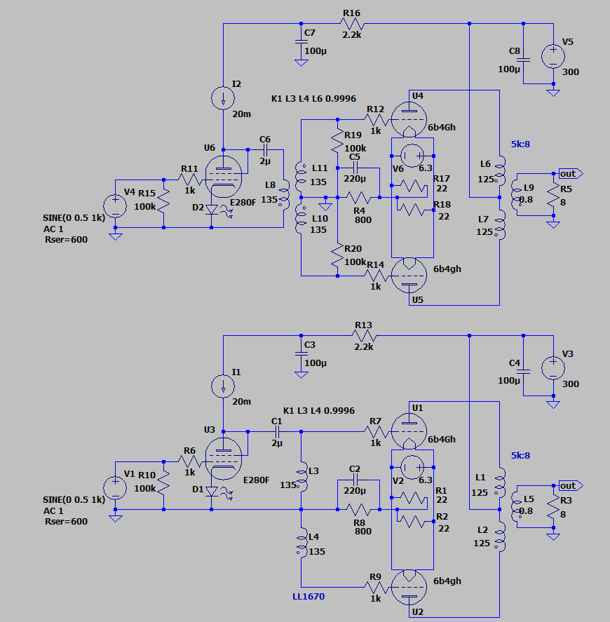

Found the alternative to autoformer, gives the same results with just a minor higher H2 than that. Would have been nice with direct coupling from the input tube but Ua is to high at 150V. Taking the the lower output from below the source resistor actually sims best. A depletion mosfet with lower input capacitance would be desirable, though.
I just check my spice schematic, my C2 is in ultra-path connection, not grounded cathode connection.Great to hear this from someone who actually tried LL1670 in this configuration. I guess you removed C2 to enhance balance? Did you notice any big improvements when doing so. What driver did you use? Have E88CC, 5842, 6C45 and a few others in my stash. Might save the E280F for a SE working from 300 and up with horns. The PP is for 414-8E in closed or reflex from 60Hz.
In additional to LL1670, I have custom-made Nickel core "autoformer" (~150H)
which is an improvement sound-wise over LL1670.
I tried many many drivers: ECC88, DA3, 7119, ECC81. Dual ECC81 (8mA each CCS loaded) is my pick.

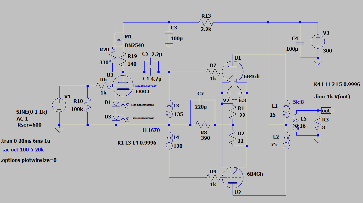

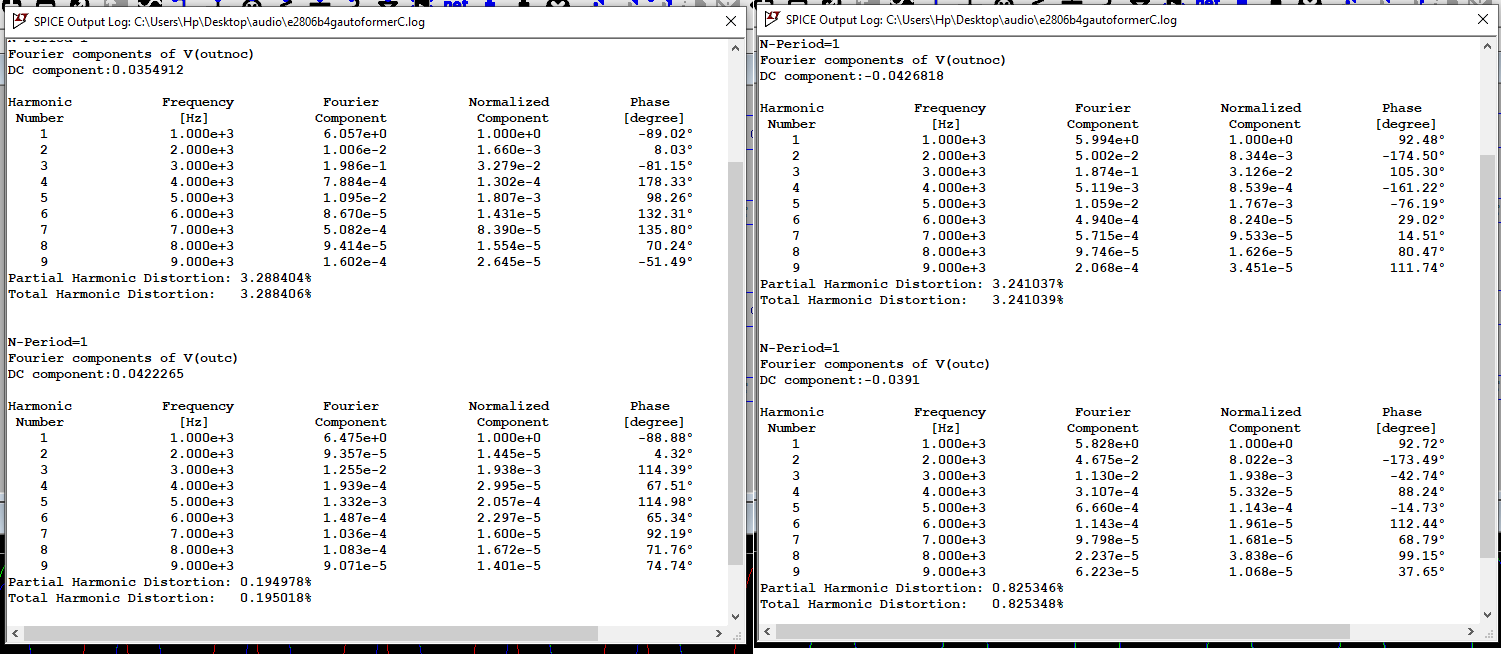

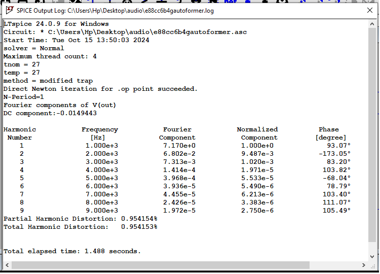

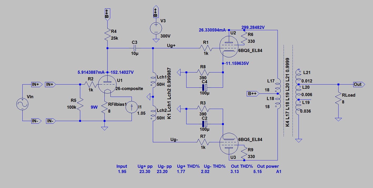

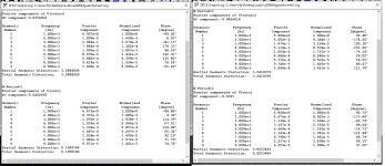

Played around in LTSpice and to my surprise, distortion figures got significantly lower with less inductance in the lower part of the autoformer. More inductance in the upper made results worse. Checked overtone and it seems H2 is the one that is lowered,
Any theories or explanations? My guess is distortion cancellation.

Clearly this must be, due to distortion cancelling only affects H2. Did the same operation with the concertina, where the lowest H2 is at 15k/17k anode/cathode resistor. In both concertina and autoformer the quota is 1:1.13.

Have read them both read them again now. Dmitry’s is the one who actually pinpoints the imbalance issue. Easy to get fooled by THD.
