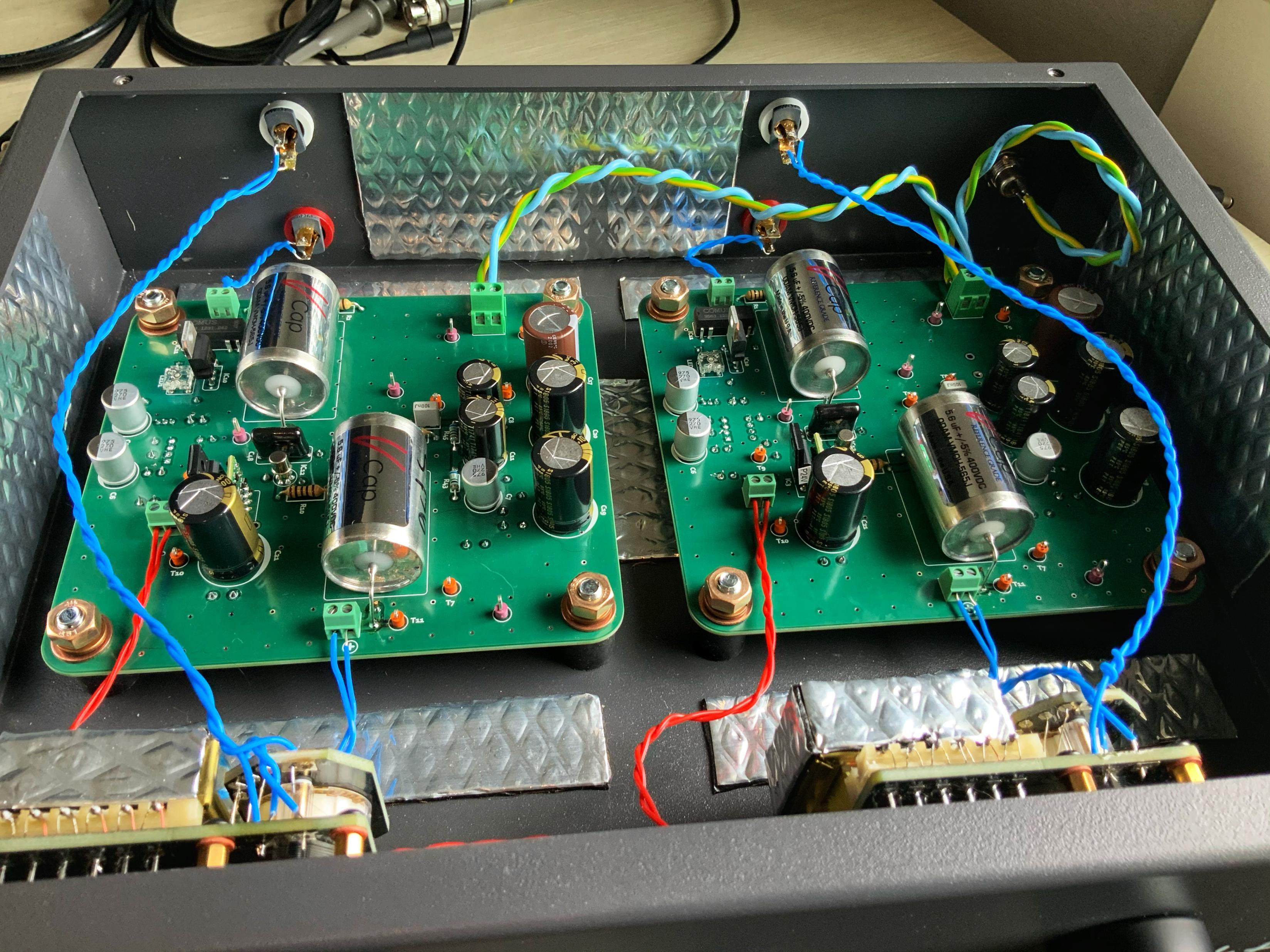

Autoformer + Jfet Buffer

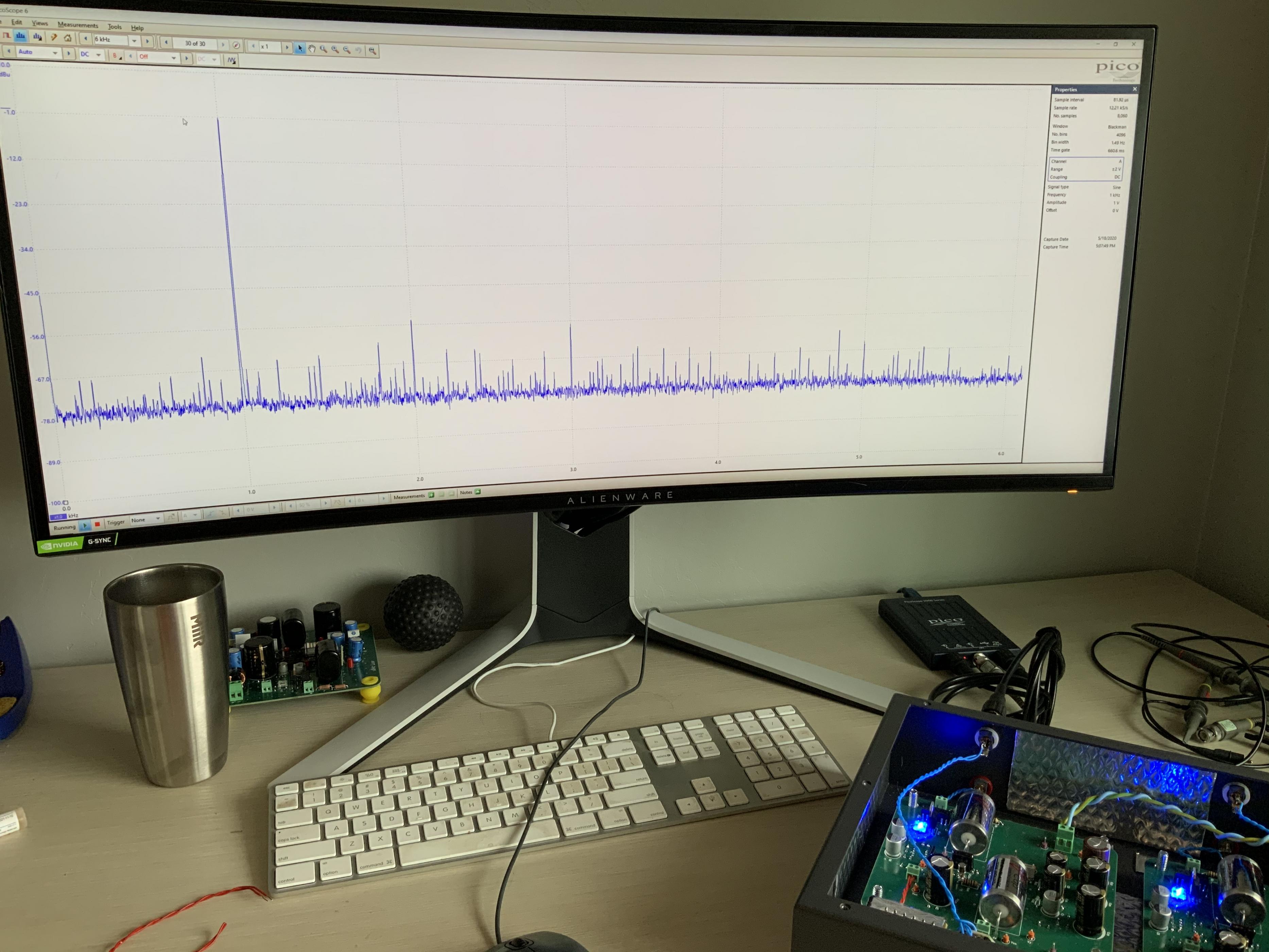

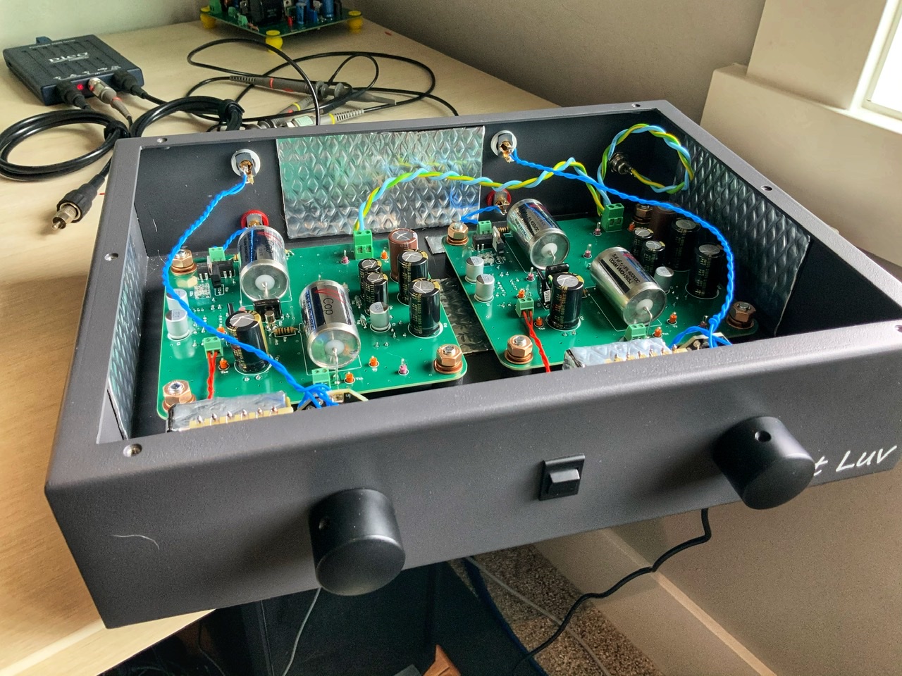

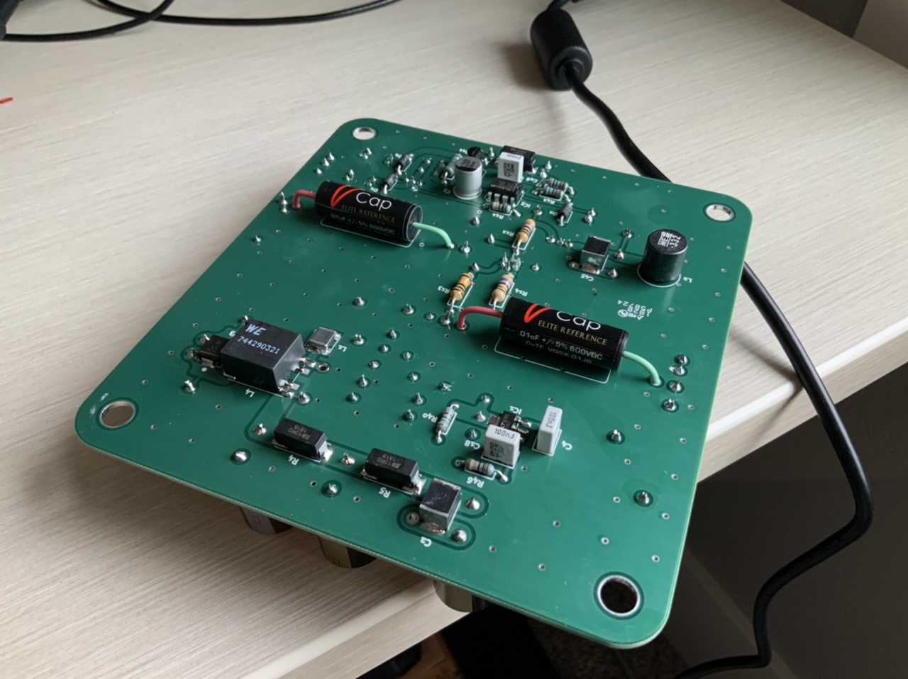

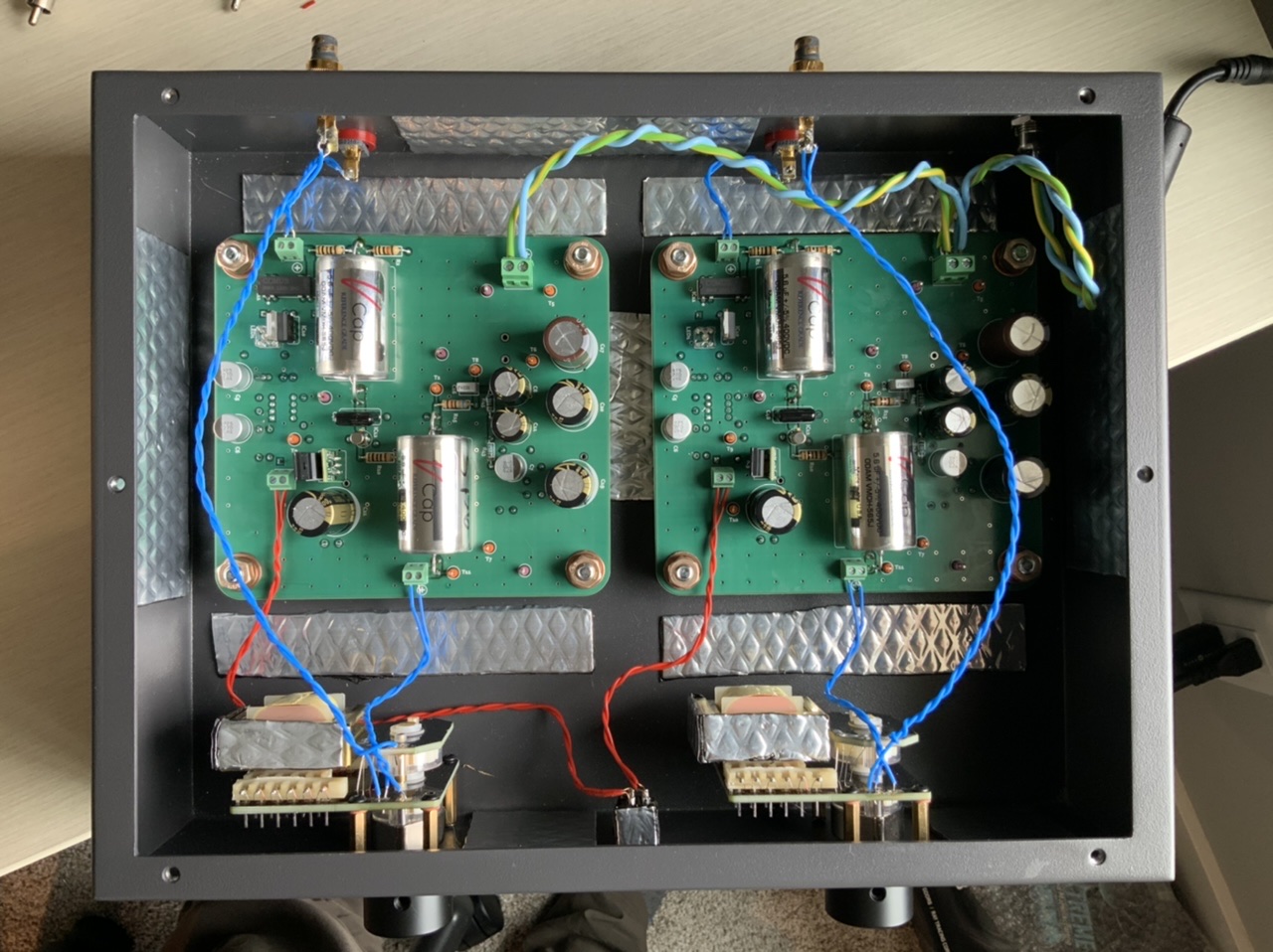

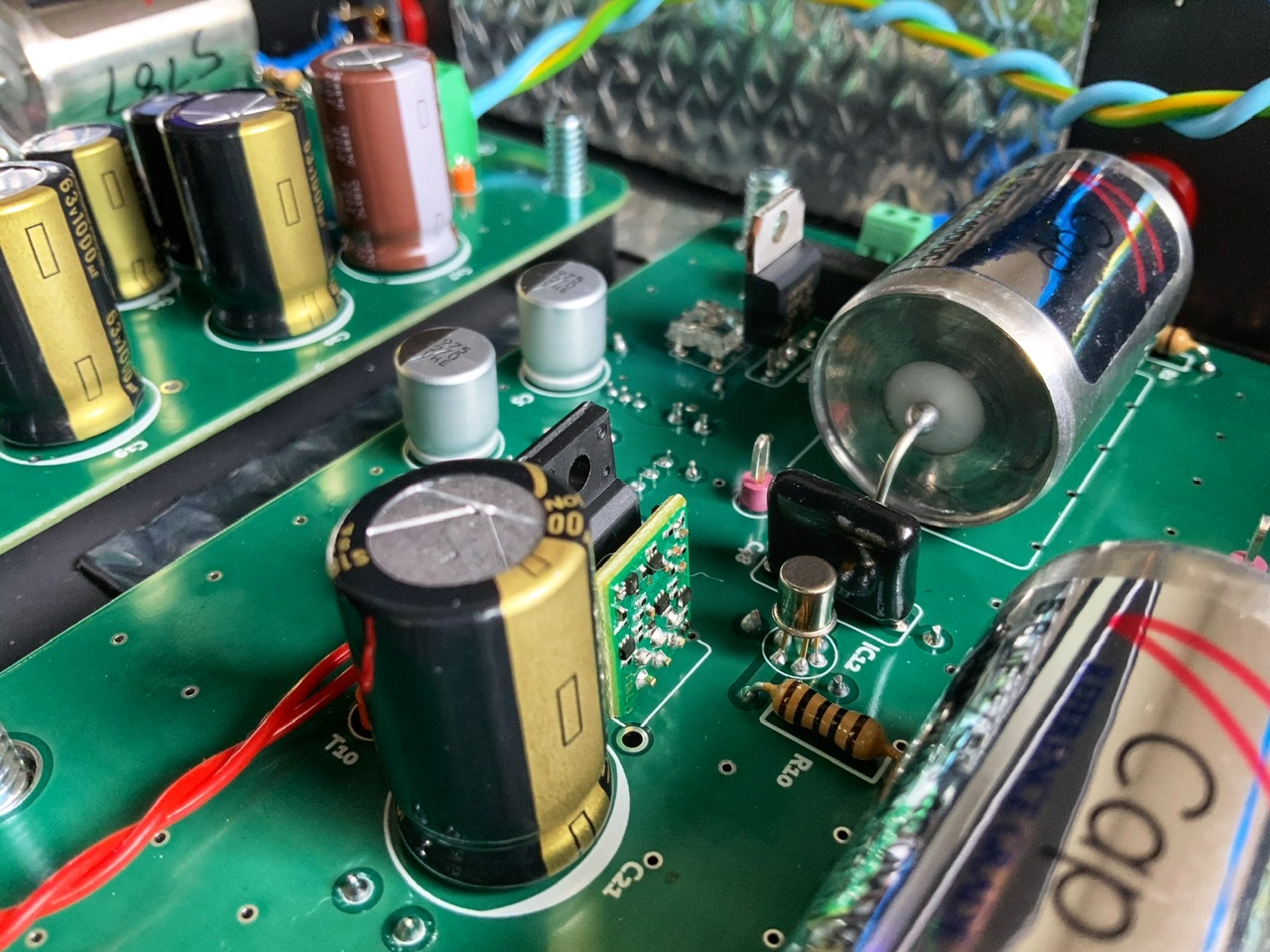

Using an Intact Autoformer, I added a LSK489 buffer based on the White Cathode Follower. Its a dual mono configuration using a 28v switching supply. The input cap is level shifted allowing a single supply design. Also added a muting shunt relay for noise free operation during power up & down. The jfet adds some 2nd harmonics. The 3rd order shown in the pic is mostly from the 8bit usb scope. I find the preamp surprisingly enjoyable and resolved. See attached. I plan on developing a linear power supply version(+/-24v) in the near future.
