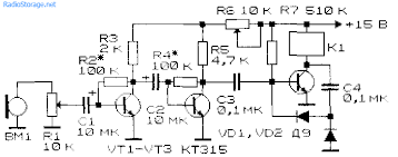

I, too, would like some of these! Seems odd that there’s not an off-the-shelf solution.
If you have, say, a small echo dot with the auxiliary out going into a proper amplifier and speakers… you want one of these so that the amplifier is not running 24 hours a day all year!
I’m amazed that there is not somebody selling a plug in semi-smart switch by the bucket load.

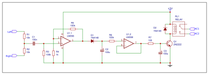

This is how post #12 is supposed to work.
Just explanation, not a recommendation.
R1, R2 average the left and right channel inputs.
C1, R3 block off any DC below 16Hz before entering U1.1.
U1.1 amplifies the input signal by 100x, determined by R5/R4.
You can change detection threshold by changing R5.
Any positive output from U1.1 >0.6V will pass through D1 and charge up C2.
R6, U1.2 is a buffer to charge up the integrator R7/C3.
You can change the delay time by changing R7.
When the integrator output is larger than 0.6V, Q1 will turn on the relay, which e.g. can be the power to the amplifier.

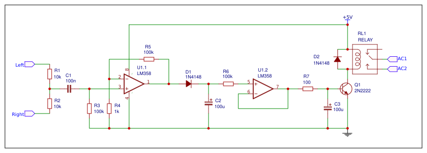

There are (at least) 3 issues as i can see :
1. The opamps are powered by single rail, but the input to U1.1 is not protected against signal below Gnd. At least a clamping diode is required.
2. Output of U1.1 needs some current limiting (e.g. resistor) when charging into C2.
3. When the input signal is off, C2 can only discharge through its own leakage current, the leakage current of D1, and the input current of U1.2. It may take a long time to switch off. A large value resistor in parallel will help.
Some people did say the LM358 has internal clamp diodes, but I would still play safe :
https://www.eevblog.com/forum/beginners/protecting-op-amp-input-from-negative-voltages/
Best to simulate in LTSpice first before trying in hardware.
