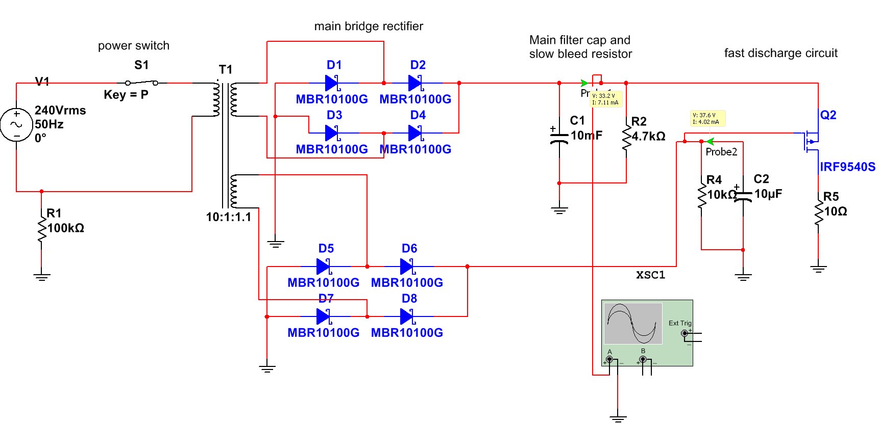

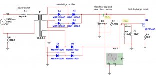

Idea 1:
Short the cap permanently through a low resistor (say 10R) and a PNP transistor or a P-Channel MOSFET, which is kept "off" by a positive voltage on its base/gate. I will get this voltage with another bridge rectifier in parallel to the main one. Ideally I would have a separate winding on the transformer so that the voltage at the base of the PNP/FET is slightly higher than the voltage of the main filter cap and keep the transistor well off. When power to the transformer is lost, there will be no voltage at the base of the PNP and it will discharge the cap. I attach a schematic.
Cons: requires extra bridge. Ideally also requires a slightly higher voltage on the gate of the FET to work well, which means another winding.
Idea 2:
Instead of FET use a NC relay - or a 1PDT relay - power through the coil keeps the contacts open. As soon as mains power is off, the coil current will deplete the caps, the relay will close, and will further discharge the cap immediately.
Pros:
Extra fast discharge, just one additional compoment, no bridge required.
Cons:
Continuous relay coil current draw in normal operation.
I am going for lunch, any suggestions welcome.

The R3 tries to charge the C1 up to turn on Q2 to discharge the main cap C2, but C1 gets discharged by Q1 through R4 every power cycle so that the gate of Q2 never reaches the turn-on threshold, therefore, Q2 never turns on to do the discharge work until the mains is turned off and Q1 stops discharging C1.
It looks very similar to mine (P-fet vs N-FET)? The separate winding is only needed for perfection but you can use the same winding as the one for the main cap, the loss will be a few mA leaking through the not-fully-closed FET. On simulation at least.
There is a slight difference in how the residue voltage on the main cap goes down at the end of the discharging. In your circuit the Q2 starts to turn off when the main cap voltage drops to the threshold voltage of the MOSFET, and from then on the R2 will finish it off. In my circuit the gate voltage is held by the C1 above threshold (4V in this case) and the MOSFET can completely discharge the main cap. A bleeder resistor is not need.

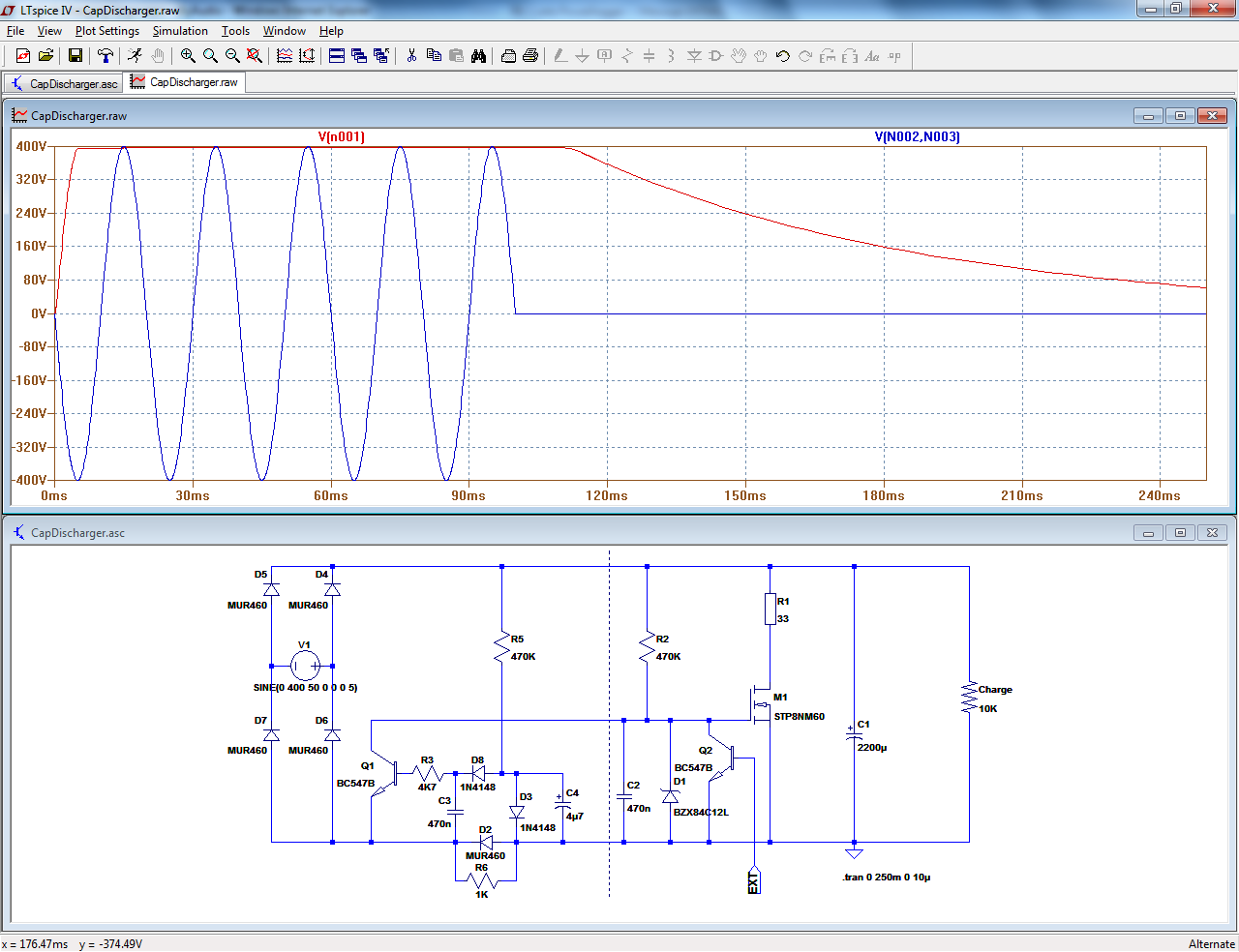

Agreed.
I will just add that a quick "complicated" discharger is not incompatible with a slow, low-tech one: even with a quick discharger, it is probably a good idea to add a large value bleeder resistor anyway, in series with a high-brightness LED.
For maximum safety, the resistor should be made of two parallel reliable types, and the LED should be shunted by a 4V7 zener, in case it fails open.

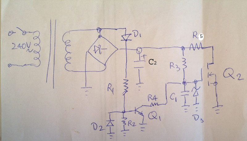

Using the secondary of the transformer, in my schematic 24V AC, to power an AC relay which will disconnect the big cap when the AC is lost. Just one extra component.
If we use two extra diodes and an extra capacitor to rectify the same secondary feeding the main cap, we can then use a DC relay.
Ta. The concern I have is not how the relay coil is powered, but the rating of the 'contact' (or terminals) within the relay. That contact will have a specified rating for switching power - with an AC rating, and possibly a DC rating. Unless the relay contact is designed and rated to switch DC current up to a certain voltage, then you may well find the relay contact will fail (high resistance or welded low resistance contact) in a very short time.
