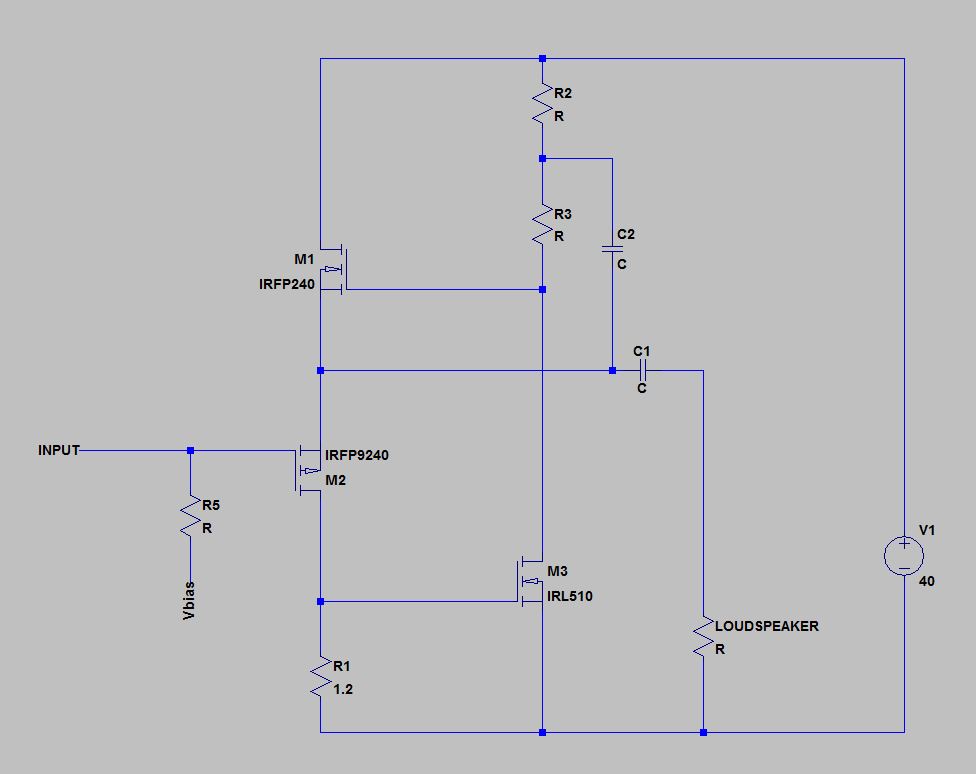

Dosnt matter how high the bias starts or how big the caps are. If the signal stays on long enough, a full cd for example, the caps will increase there voltage and increase the bias. The louder it plays the higher the bias goes. What other tricks?

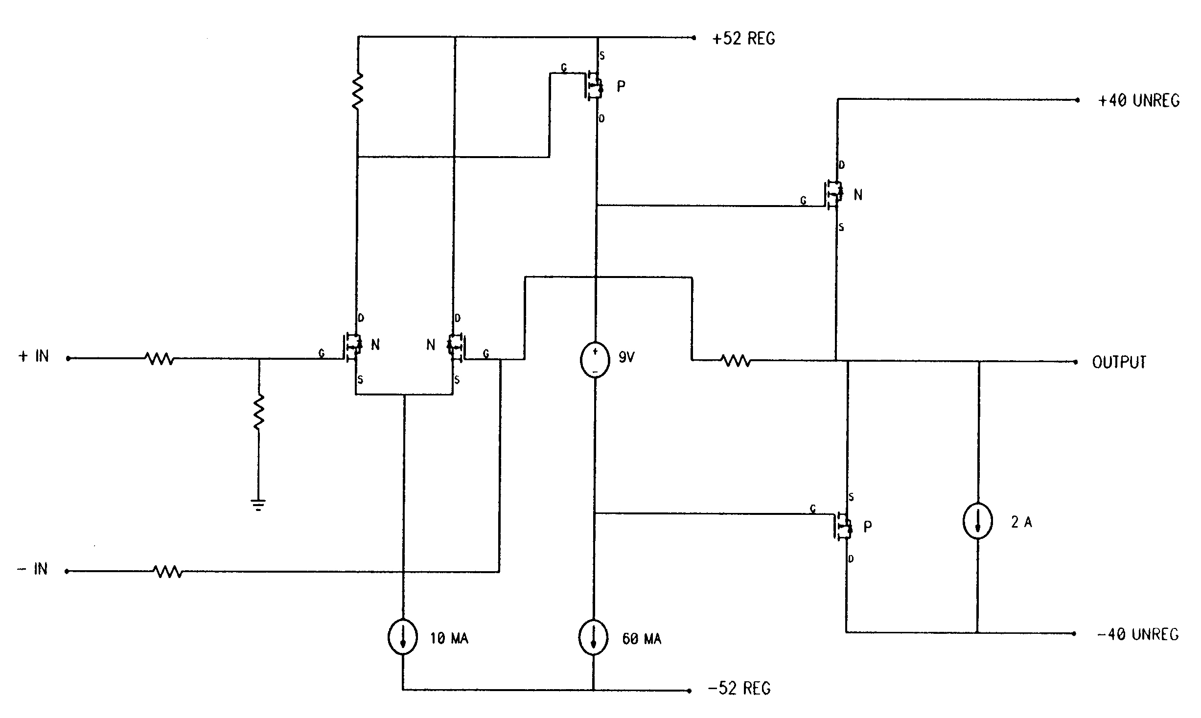

And you might enjoy the Aleph 0 from 1991.

This is a neat auto-bias from TubeCAD that I like. (very simplified for clarity)
Class A only, but can have a very low distortion and be very stable and nice behaved. It is easy to add positive current feedback for a negative output impedance if wanted.
