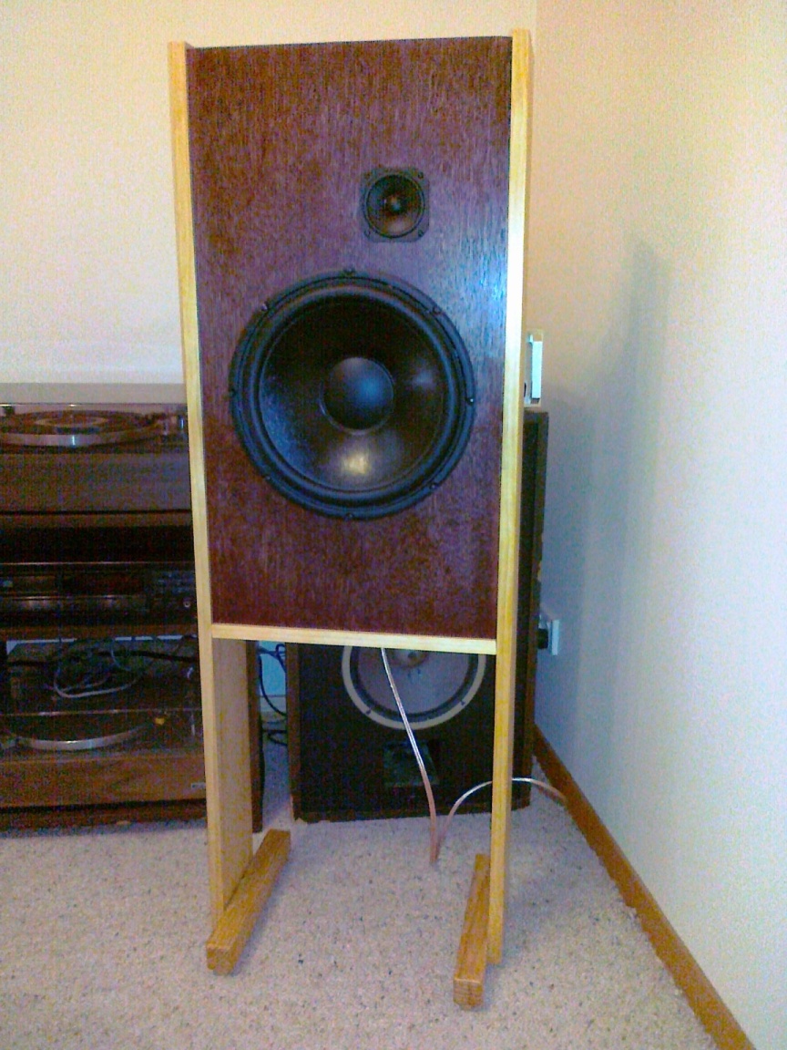

Hi Eugene. The 6.5inch Response is a good woofer, as is it bigger brother. Both have phenomenal bass out put, and if you have a good crossover is and excellent performer.
I use the 8 & 6.5 in a lot of builds and they perform as well as much higher priced speakers. I also use the Kevlar range from Surplustronics as well. I use all three of the Kevlar depending upon build.
My latest version of the Pettites uses the 6.5 inch Kevlar coupled with the CT2007 Jaycar titanium tweeter. For a 12.5 litre 2 way they are really good performers and have an impressive sound-stage & resolution.
The tweeter is a Vifa OEM clone and the Response woofers are a Peerless OEM unit made in India. I know because I got Jaycar to find out for me.
I also have all the T&S parameters and performance graphs for these speakers so I you need any info just PM me or email.
Heres some of my builds using these drivers
Meet The Family
Showing the Aria's Aria2 and the Petites.
Build Threads :
PMS
Current build is a set of PMS speakers using a Response 8 inch Driver & Tweeter and a 6.5 in Kevlar for the mid.
Pettites
Latest version of the Pettites
Aria2
The Aria 2's a two way hi-fi speaker
Hope all this of some use.
Cheers
Ralph.
