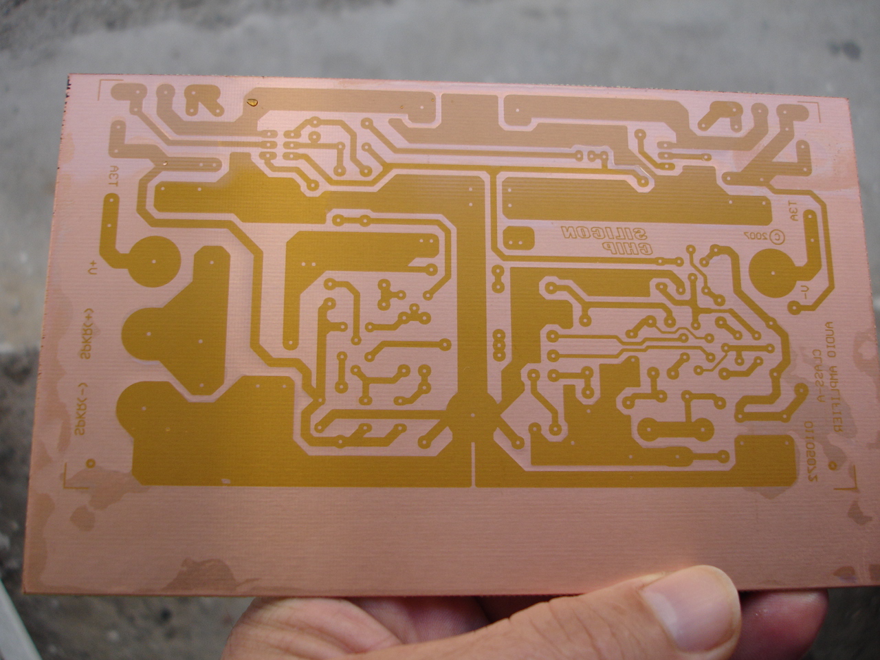

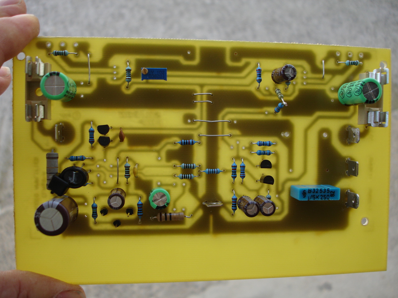

I didn't want to buy modules.
I have handmade PCB as usual.
These are etched today.

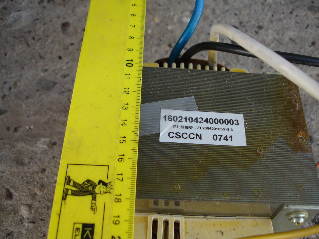

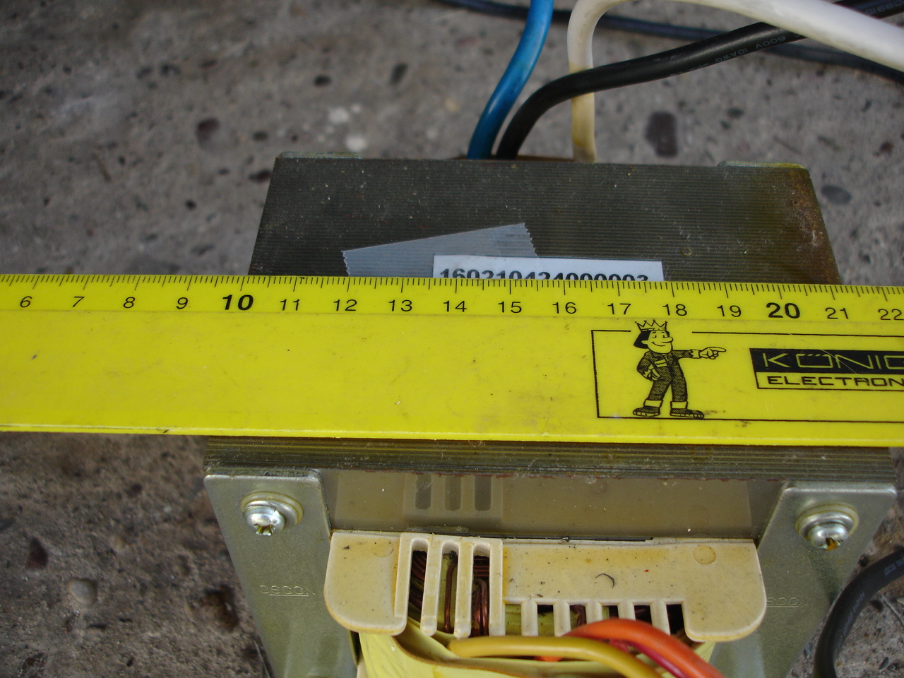

I have a large transformer 2x15v from a damaged UPS.
As for large heat sink........a smaller with blower ....just for try.
I'll post pictures from first steps tomorrow.

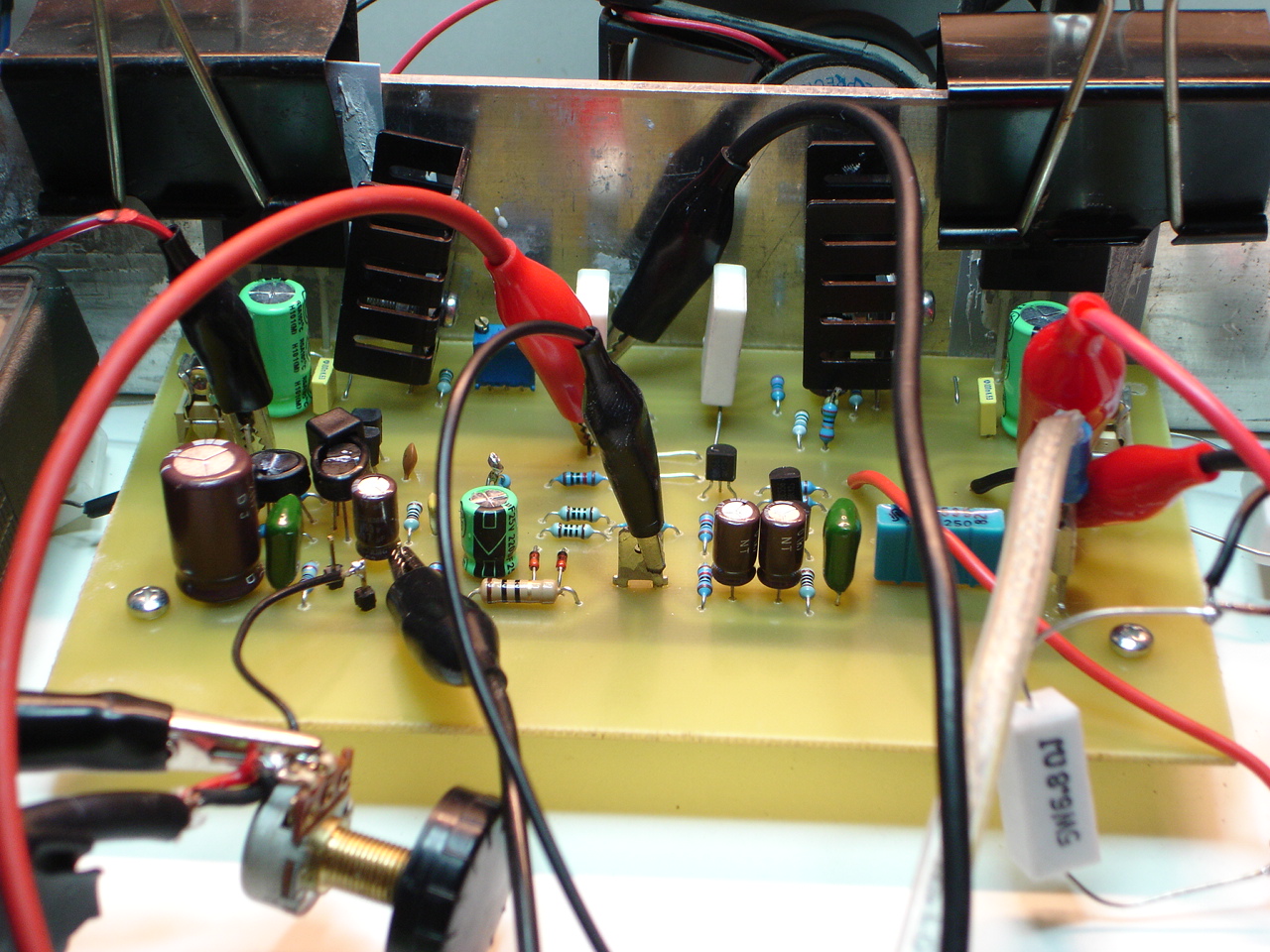

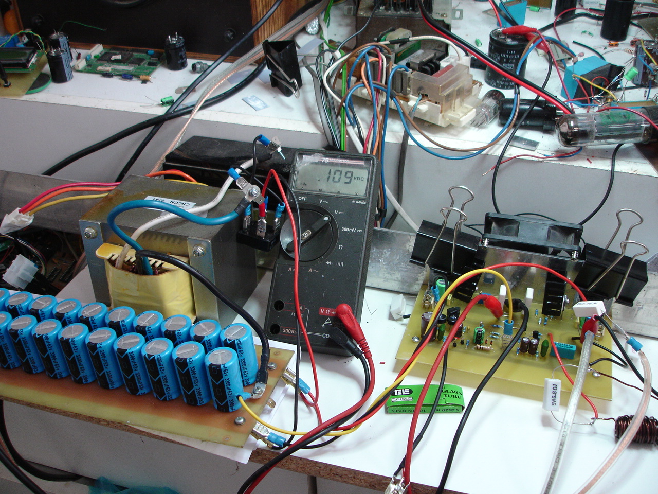

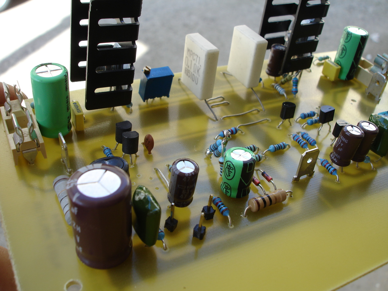

Here are first steps.

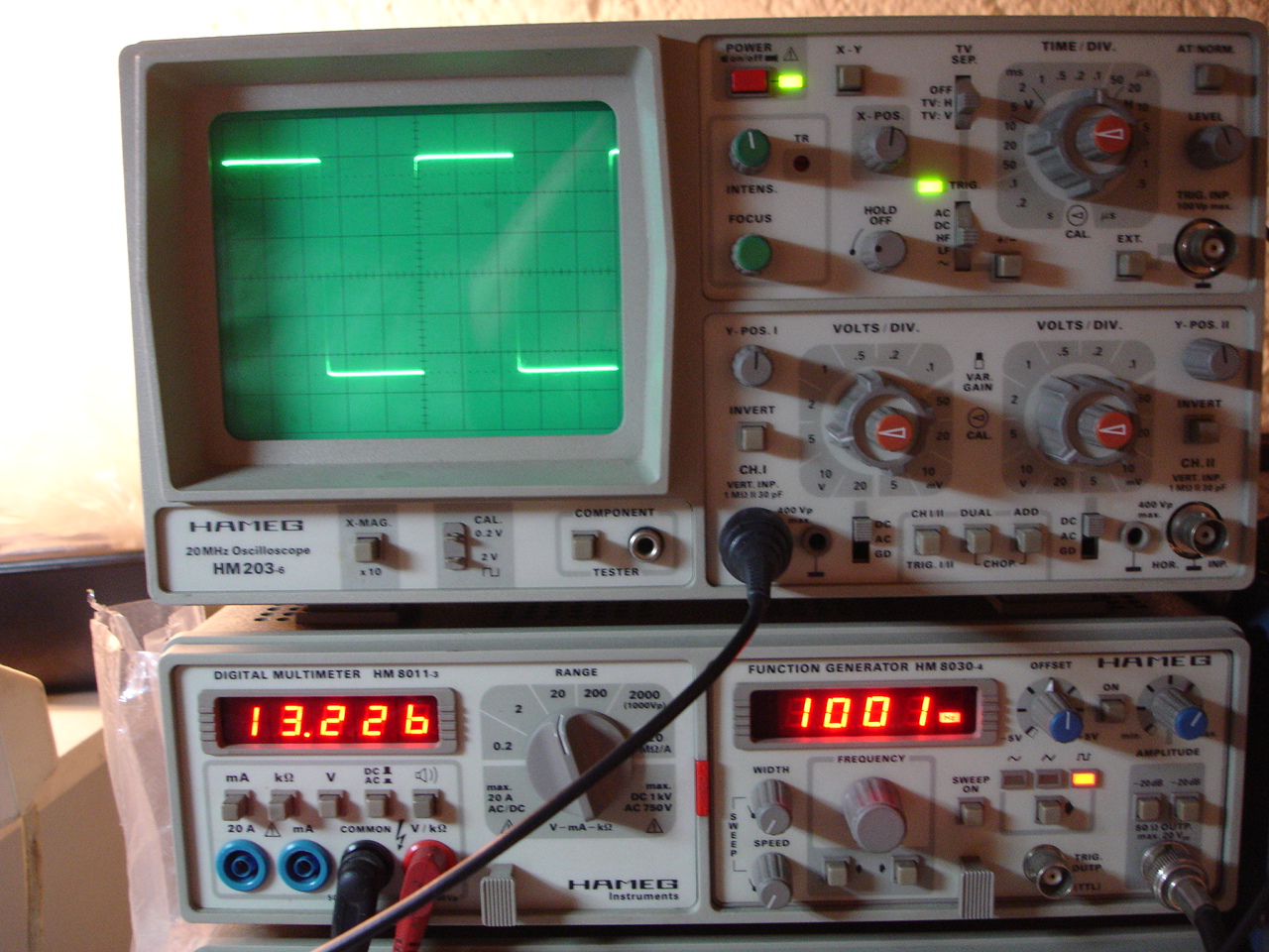

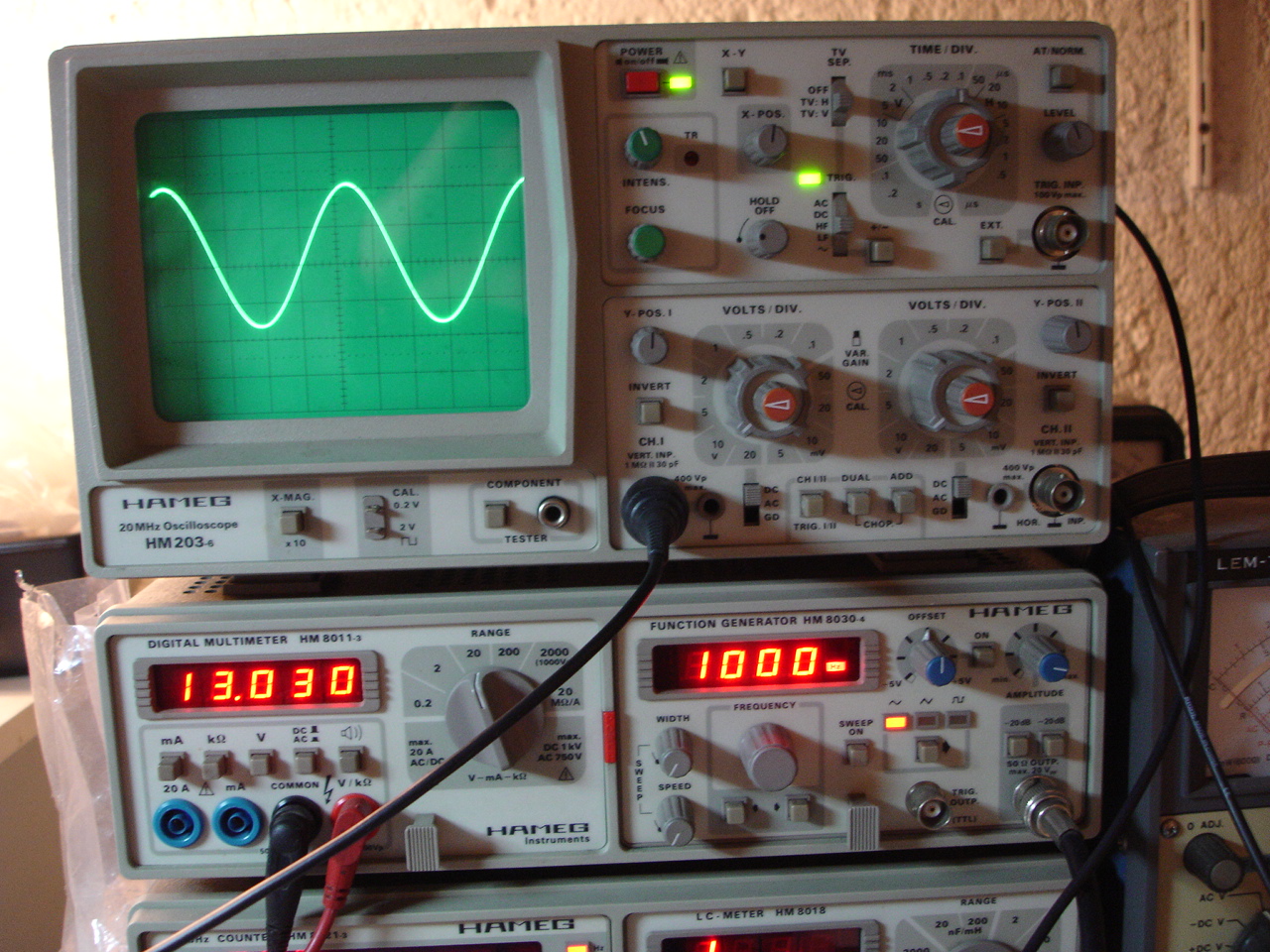

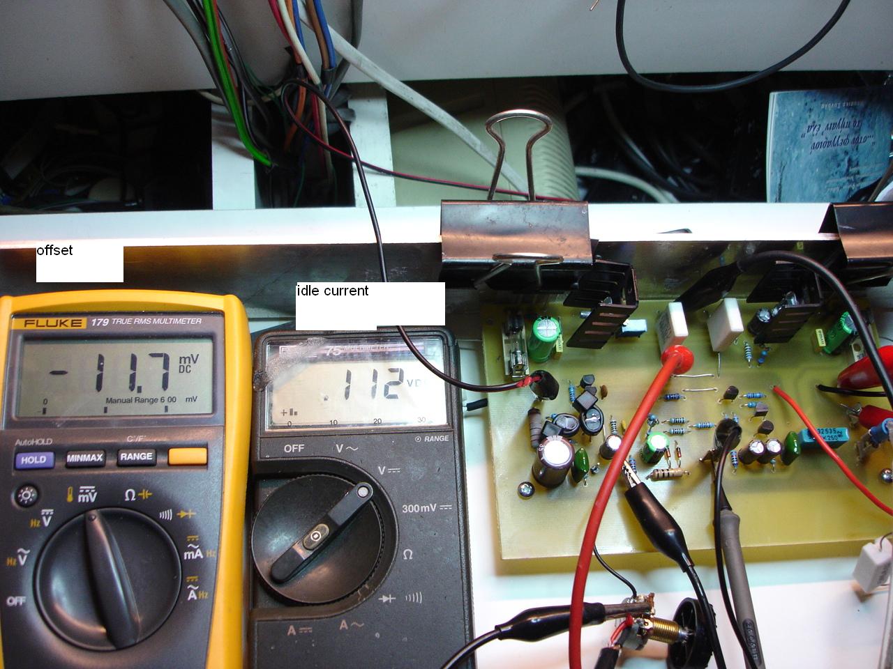

Some photos from first fire.
Keep in mint that power supply isn't so good.
Two separates adjustable power supplies just for first try.
+/-22V
1.2A idle current
-11mv offset
R dummy= 8R
20W RMS Just before clipping.
