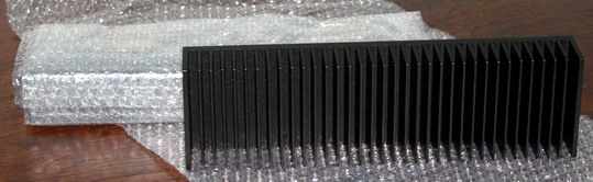

casing
for make my own casing i prepare the important thing
" HEAT SINK "
I listen carefully for destroyerX thread about aussie heatsink
So I order from conrad heatsink, australia
http://www.conradheatsinks.com/products/flat100_350.html
IT IS COLD, I try to look in Indonesia Market, only available
heatsink for machinery industry the better is Heatsink with
size 300 mm x 90 mm x 90 mm ( Too Bold )
I receive the package yesterday but i have no time right
now because i must finish my job in the office, i order 2
conrad Flat Backed Heatsink MF 35 - 100
I buy 350 mm 'cause i look the "better place"
" HEAT SINK "

Interior
Theres a lot negotiation about the case 😀
Even with my wife a interior designer
and she likes minimalis verymuch
When i want to build amplifiers i ask her
what design she like, from some picture
casing with MF 350-100 its the best
You can contact julian wales at sales@conradheatsinks.com
He is kind and give me the quick service and alot tips & trick
Shipment is 15 days with regular air mail service
This is the real heatsink picture, imagine .....

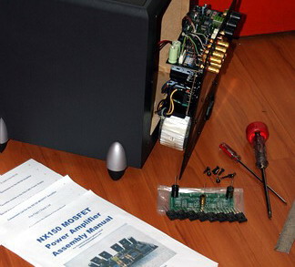

Wrong Picture !
My Heatsink Picture is in this posting 😀
sorry this is 5 o'clock in the morning
The picture before was my friend NX 150 KIT
I think He want really realy do the mods
So we will learn seriously about the other component
Will read a lot about another review component & mods
The Motto - What will be, will be ... I just listening 😀

90 x 90 x 300
Hii Fast Eddy
The picture below is my drawing about the heatsink
The product better lokks than my drawing 😀
I look in Indonesia Market, price is US$ 22.25 / each
But must colouring / anodized yourself
The have some measurement
- 90 x 90 x 300 mm
- 90 x 90 x 200 mm
- 90 x 90 x 150 mm ( I forgot )
- 90 x 90 x 100 mm
Weight = 3 - 4 kg / 6 - 8 lbs
If i look detail, looks best if we use THE HEATSINK
for ALEPH 30 😎
