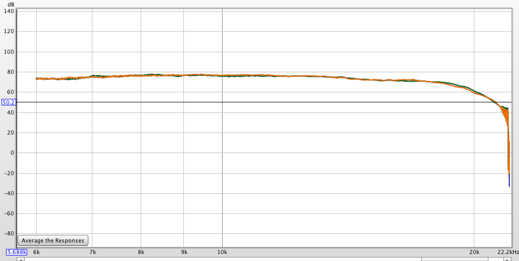

Hi, complete newbie here to loudspeaker building. I'm trying to find a dipole tweeter to suit my Coral Beta 10's in open baffles (Slot loaded open baffles). I bought a pair of Aurum Cantus AST 25120 air motion transformers, which should suit the Coral's sensitivity nicely (95-98dB). The frequency response looked quite flat on the spec sheet (see attached pdf). However, I did a quick measurement on them, and found a huge dip above 10kHz (-10 - -20 dB). I measured them with Room EQ Wizard from 3k-22k without crossover, straight from both my 300B amps and a Denon transistor amp. Am I doing something wrong?

What was the distance from mic to tweeter?
Try a near-field measurement (like 5 mm from the tweeter diaphragm).
Try a measurement at 2 meters.
Try measuring a different, known good speaker with flat frequency response.
With those three measurements added, you should be able to tell if it's something related to your mic/measuring system, baffle, your measuring distance and the line source behavior of the tweeter, or something inherent to the tweeter's response.
I'm glad it helped.
Typical measurement methods assume point source behavior. You are dealing with a small line source, so path length differences from the mic to different parts of the diaphragm may cause issues depending on the distances involved.
A larger tweeter like this will be more directional vertically than a typical dome. As long as it's aimed at the listening position, it should be OK though. You see similar size/shape tweeters used successfully, so not a big problem in practice if you are careful.
