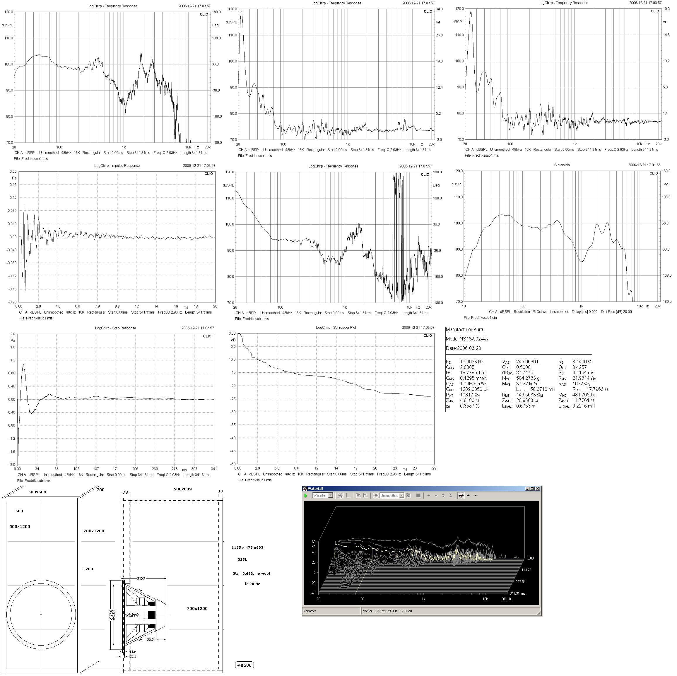

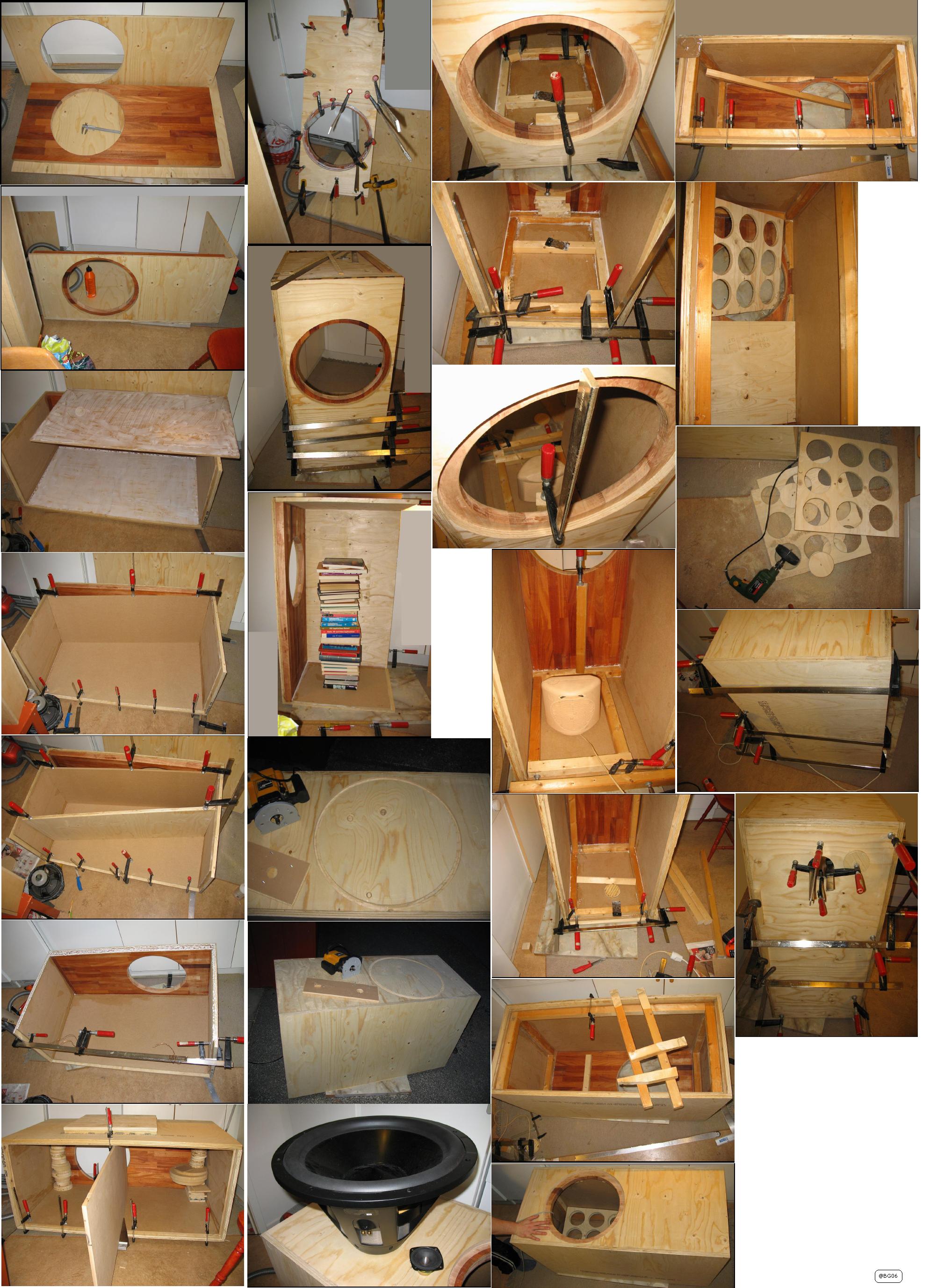

Sealed
Here is an example of a sealed box using the Aurasound NS18-992-4A I've build for a friend 5 years ago:
b🙂
