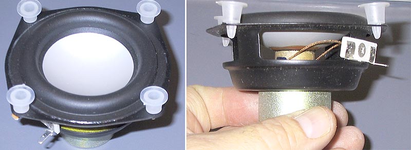

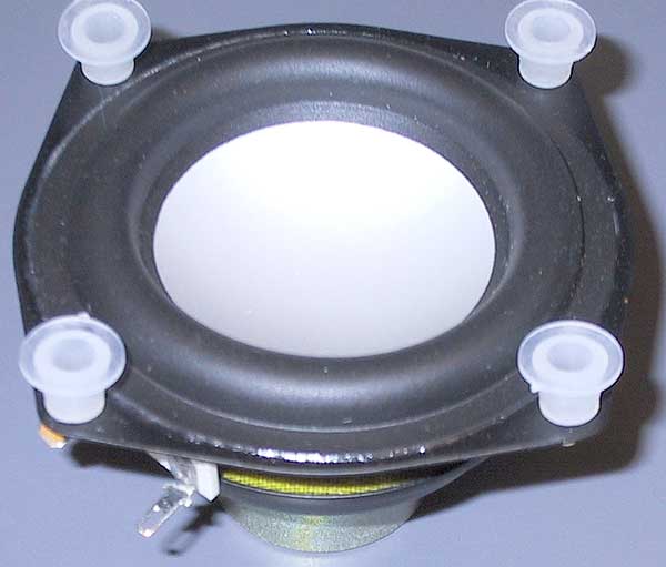

This shouldn't be too hard...I'm thinking you can drill a pilot hole in the middle of the cone and slowly, carefully enlarge it...how depends on the material, I bet it's very thin, I'd try a very sharp exacto or scalpel, that way there won't be any shavings in the VC gap. If you go slowly enough the pressure from the blade shouldn't distort anything...but I'm only guessing at how 'soft' the cone material is.
Illusus said:I'd try a very sharp exacto or scalpel, that way there won't be any shavings in the VC gap. If you go slowly enough the pressure from the blade shouldn't distort anything...but I'm only guessing at how 'soft' the cone material is.
pretty much the approach i'll start with... once the 1st one is off i'll know if a better approach is worth attempting.
dave
I also have some surgical tools that may work. I often use them for nibbling thin metal, they are very well made and the ergonomics are brilliant, very articulate...as to be expected with surgical equip.
If the surplus shop still has some I'll buy a couple extra pairs to share.

The coating is a fairly substantial layer of aluminum. They are going to take a dremel and no doubt some work fishing stuff out of the gap.
dave
Might it be easier to remove the cone completely before you start? That way you can see/work both sides and you don't get stuff in the gap.
And keep it in a condition to enable me to reassemble it -- not me...
dave
I was about to suggest a CO2 laser but then you said the cap was aluminum. Do you have a Dremel stand? If so, you could build a jig that allows you to spin the driver while routering a groove of the needed diameter.

Where I work, when we want to remove material without it falling into a hole, we turn the thing hole-side-up and it falls away from the hole. Just a suggestion. 😀
Anyway, is it too thick/ durable to cut with a new scalpel or xacto blade? I guess so if you mention a dremel. Try a low speed with a big toothy bit to scratch out the initial hole, maybe you won't get as many chunks that way. maybe mount it sideways in a vise and use a low-power vacuum to keep the dust out. Don't forget the goggles!
David
David
I've got that down... with a dremel some of the bits will likely be given enuff velocity to go away from gravity... the coil hoil is deep enuff that i can jam a foam plug in before operating -- that will also help hold the cone in place.
Anyway, is it too thick/ durable to cut with a new scalpel or xacto blade? I guess so if you mention a dremel. Try a low speed with a big toothy bit to scratch out the initial hole, maybe you won't get as many chunks that way. maybe mount it sideways in a vise and use a low-power vacuum to keep the dust out. Don't forget the goggles!![]()
I was able to carve away an initial hole with a scalpel -- going thru a few blades, but there is not enuff control to get a clean edge near the voice coil. If i'm lucky some of the early FE103 prototype plugs are going to fit.
dave
