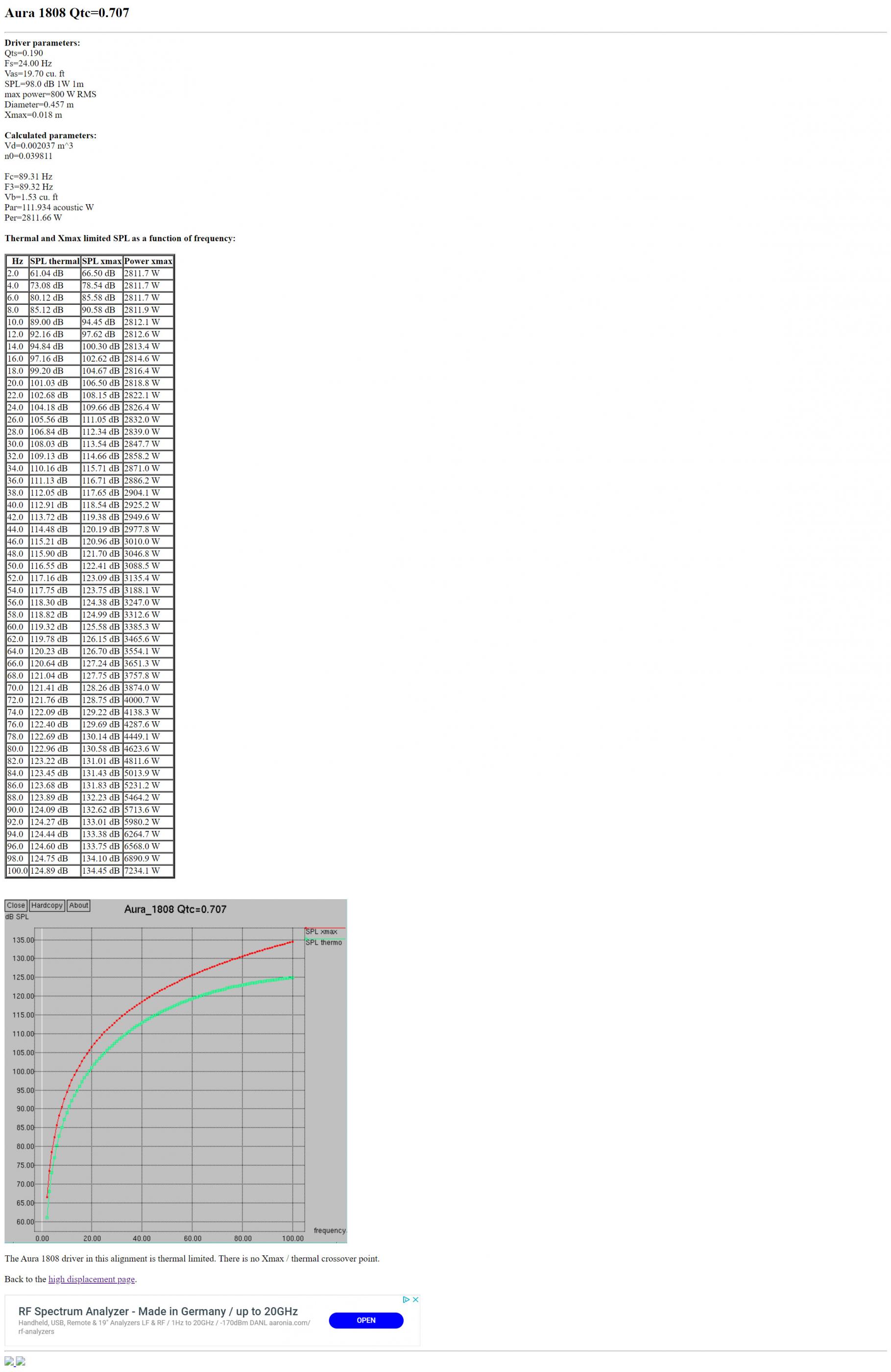

I initially did a plan on Speakerbox Lite which brought up some head scratchers...
see images, but the general gist
The calculator determined what seemed to me quite a small box (79.35 litres for a Qtc of 0.5, f3 97.2Hz)
When increase the volume of the cab the f3 increases and the Qtc decreases... how small a cab can an 18" have?
(images are for a slightly bigger box - needed to fit the driver!)
Then i found this calculator Speakerbuilder Pro 2.0
Vb 150l, Qtc 0.7, Fb 52.12
The results seemed to "feel" more correct... also as i made the Vb greater, the Qtc and Fb lowered... this is correct right?
Are these both viable options, or is one of these not functioning correctly?

As you documented above an image taken from the same website Aura 1808 Qtc=0.707
