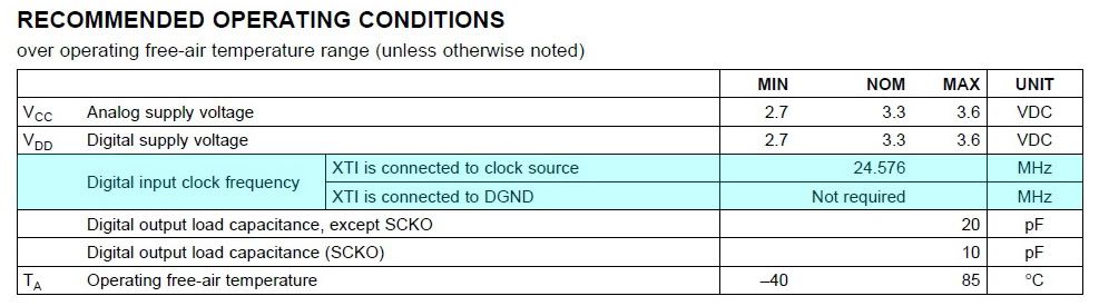

DIR9001 XTI must be connected to DGND
As per DIR9001 datasheet - when it is not using external clock source, the XTI pin of the DIR9001 must be connected to the DGND. I had the DAC opened up and soldered a small piece jumper wire to connect the DIR9001 XTI input pin 8 to the DGND for a trial because I found the sound from the CD SPDIF source wasn't quite right, kind of too mellow.
After this fix, the sound from the CD - SPDIF source became much for solid and dynamic. It is quite similar to the character from the USB source. I was very surprised with this change.
I can't say this is a design fraud but I firmly believe this should be the right kind of sound it should be. I hope someone could try it and see whether they like this change.

your over my head re: clock. maybe you could explain further. are you saying the DIR9001 doesn't use the clock?
maybe this is it? interesting. i have a 24.576mhz clock here. don't know how to implement it at this point.
Yes, you can add the 24.576MHz clock to the XTI input or simply ground it. It should be more stable with external clock.
The DIR9001 is used for the CD SPDIF RCA input. I don't have the external clock. Therefore, I need to have this pin ground as per the manufacturer's datasheet.
