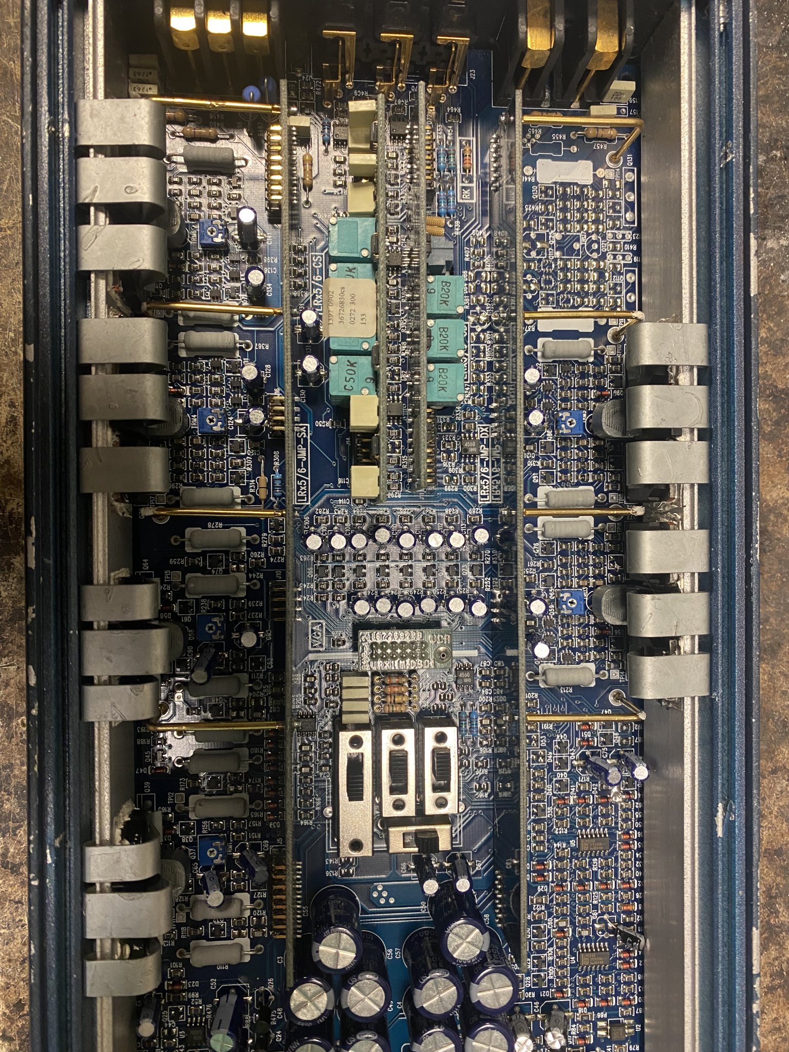

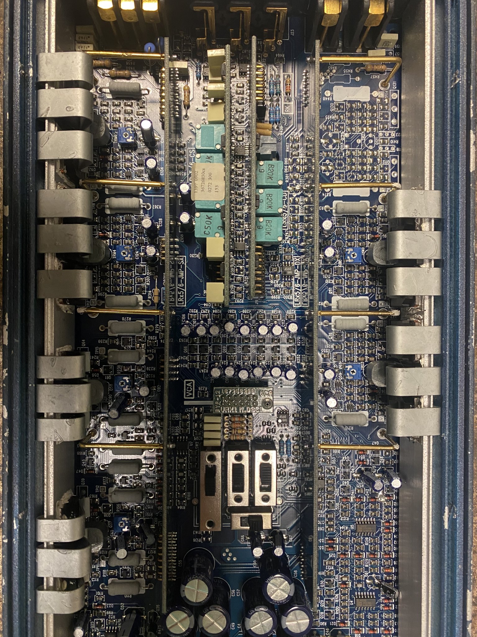

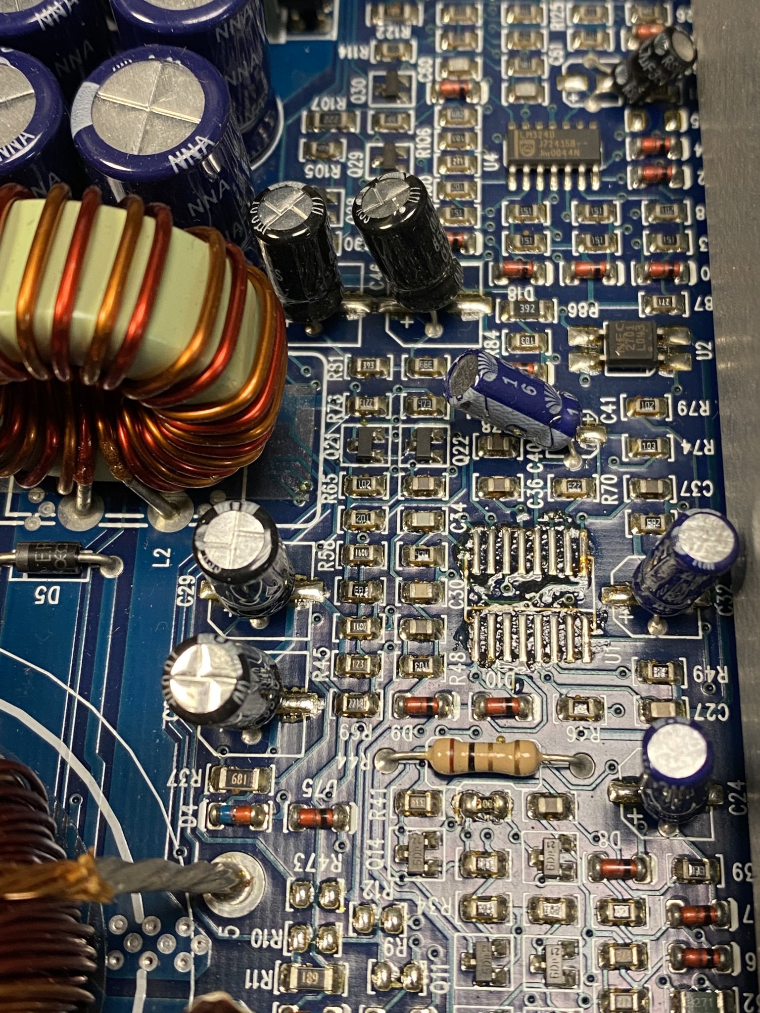

Does anyone have a pic of the following area in this amp ?
I got it in for repair and not sure if U1 is missing
The owner said another tech took some chip out of the amp

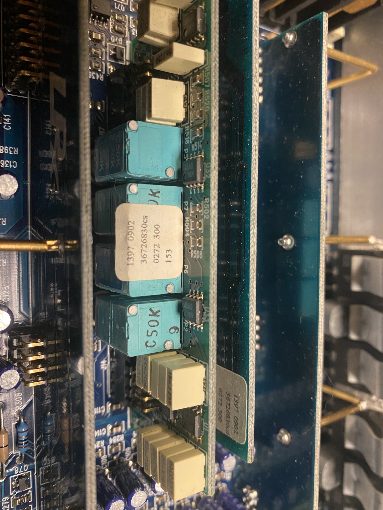

The preamp boards are in plug in headers .

I'd first ,monitor the bridging terminal of each channel with your scope (2ms 5v/div) when you apply power to see if you get a pulse of DC on any channel.
Another option would be to connect a high-power woofer to each channel and listen for a pop or tick when you apply remote.
from what I understand while repairing this amp, this is the story :
originally there was IRFB3710 then IRFB59N10 was used but with this they changed R128-148-210-233 to 1k5 .
Then an upgrade was made by removing C65-C90-D39-D54.
The IRFB4115 is not suitable, unless you modify the R-gate and do some complicated tests and measurements.
The IRFB38N20 seems a bit small to me.
Before changing mosfets, check all driver transistors and open resistors (!)
