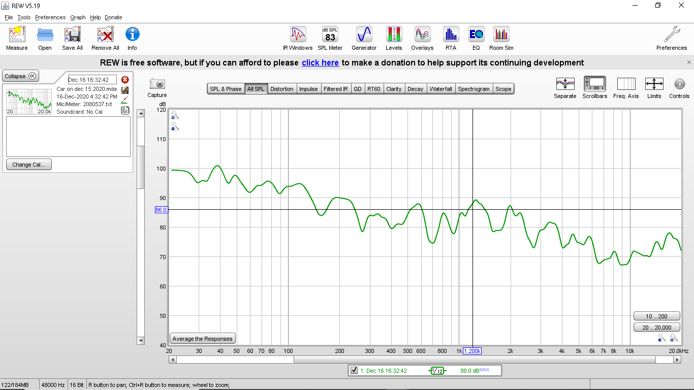

I have an audison AV12 in a very small, 18l vs 20 reccomended.
heres the TS parameters i pulled w dATS
Re 3.66
fs 39.4
vas 93.09
Qes .74
Qms 3.55
Qts .61
Le 1.47
EBP is 57
Im running about 220w into it in the box and its fat below 100hz to 20 hz in my honda Accord
Thinking of trying it in IB sice according to hornresp i would gain about 13db on the same power and still have excursion to spare.
Can anyone recomend something else? space available is 32"w x 15"h x 16"d gross
Priority is low frequency extension so i dont mind a large box since hoffman says so!
I built the little shoebox so icould get more tha the 6x9s in the rear deck.
Incar response w REW
Attached the REW measured response at headrest, 1/3 oct smoothing.
removed a big hump between 1K and 4K with deck eq.
