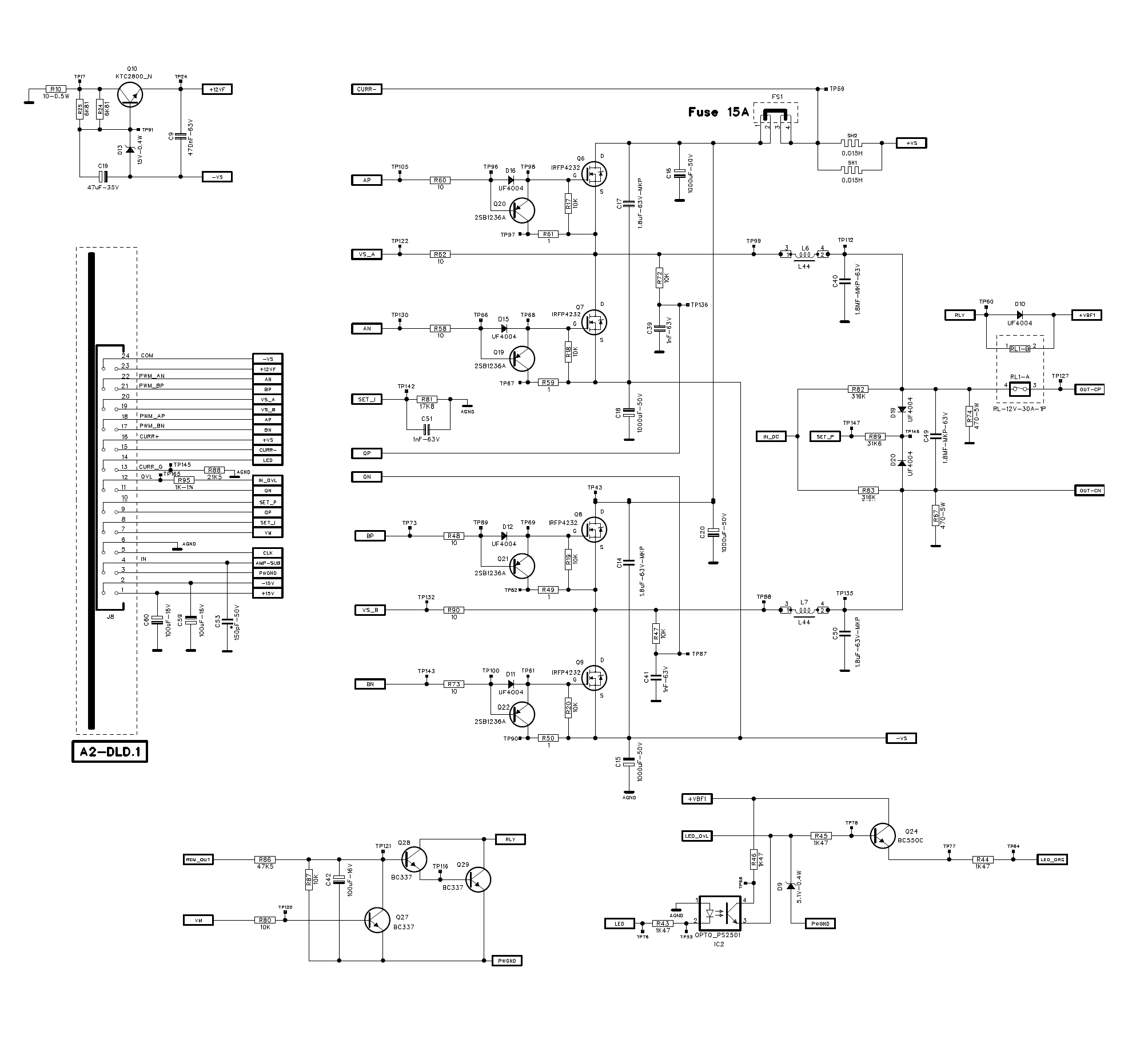

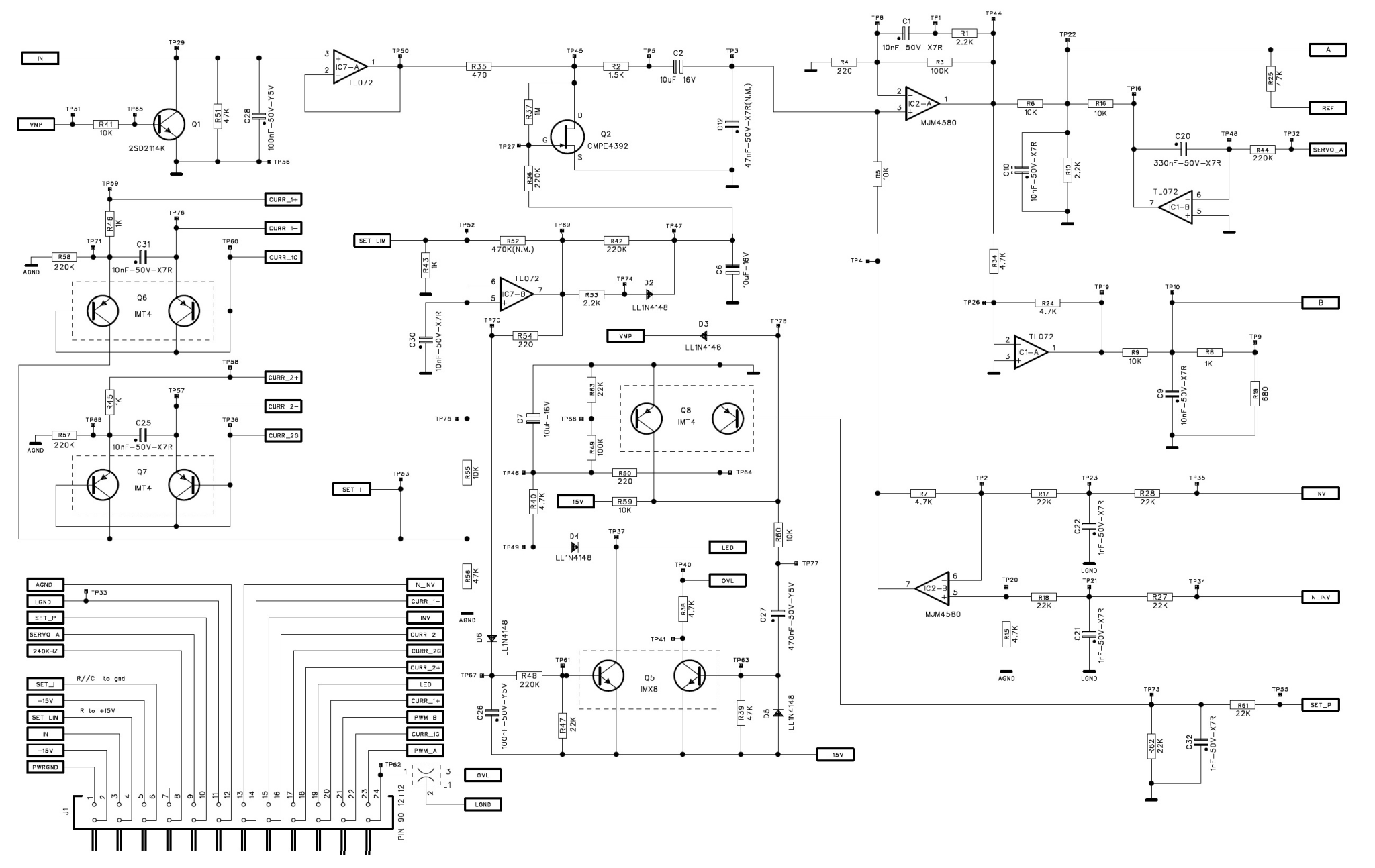

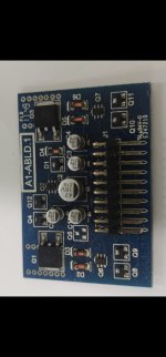

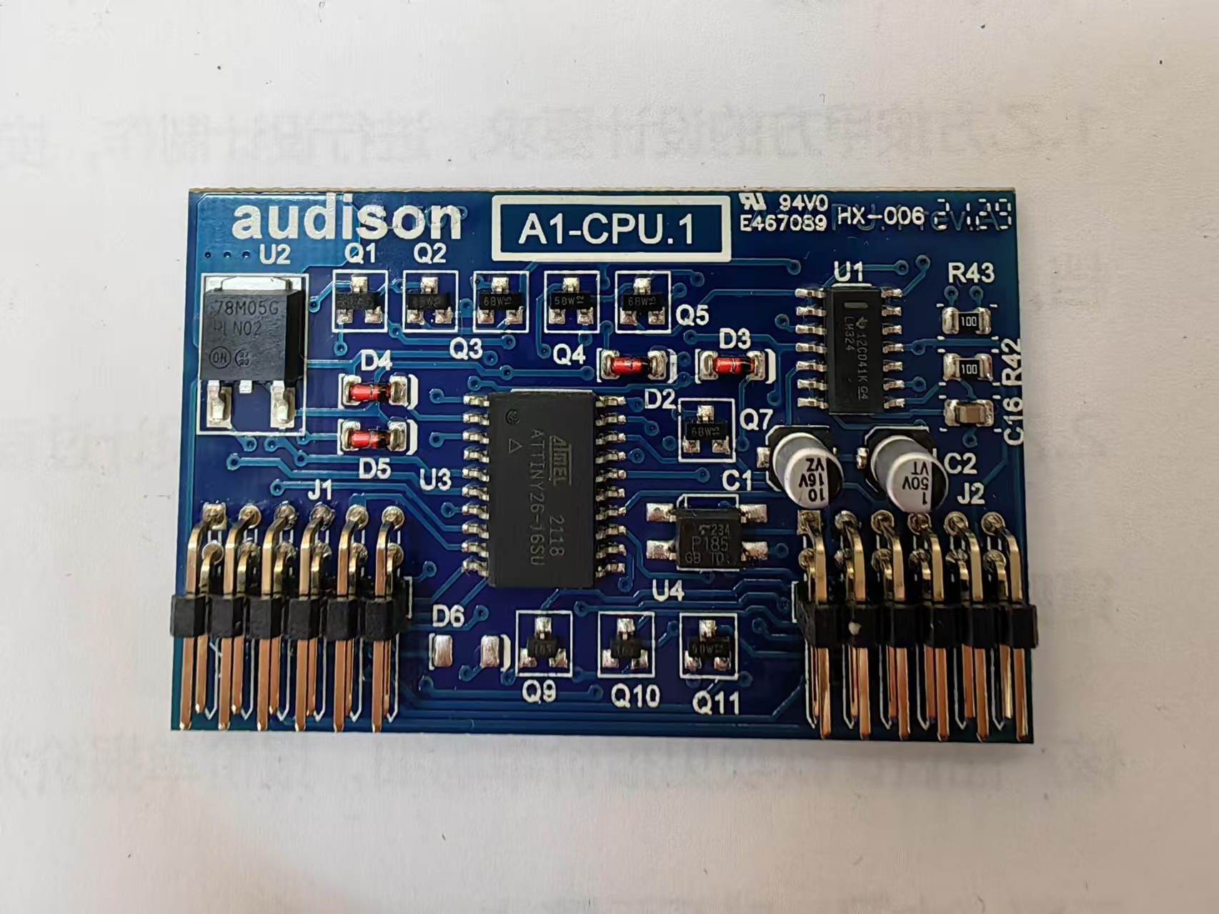

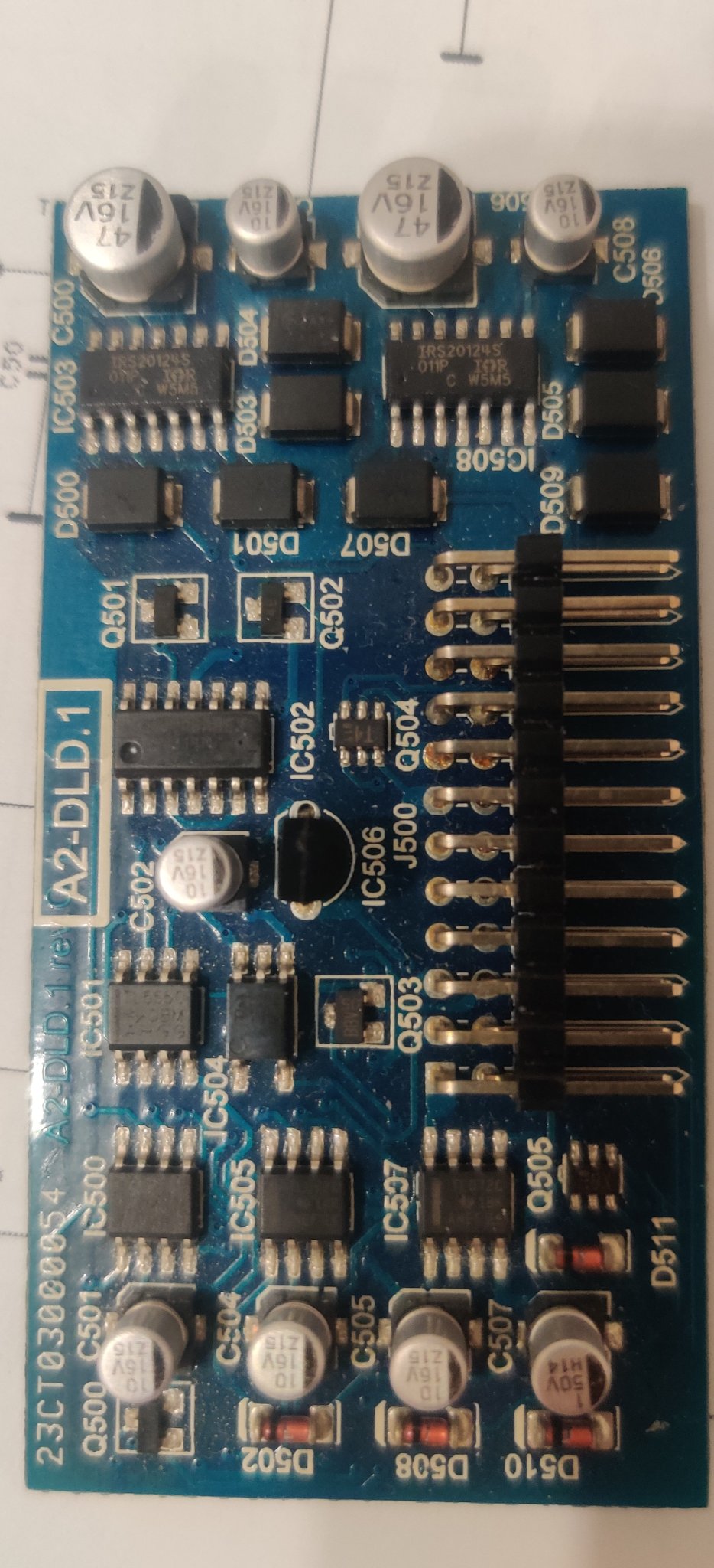

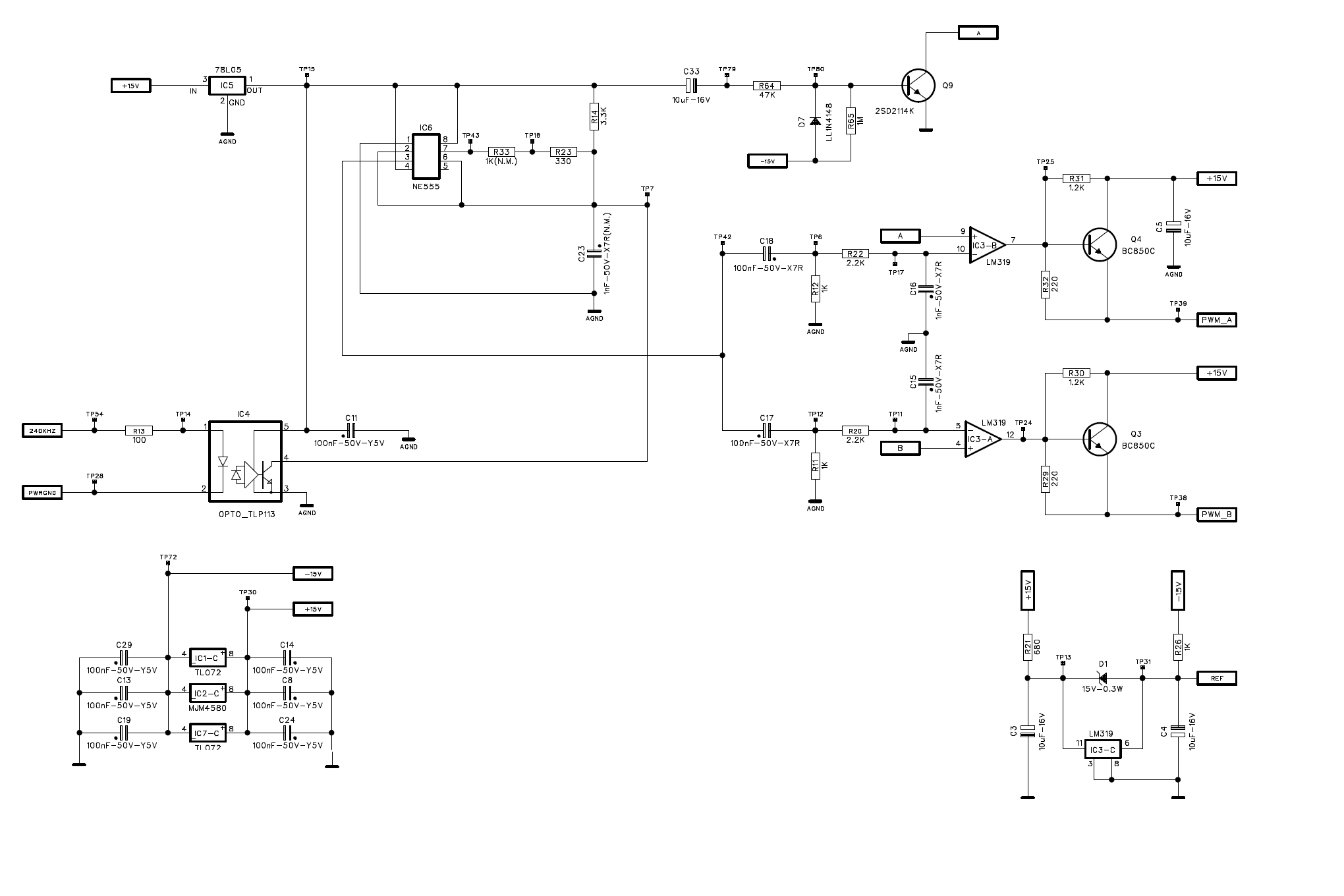

Hi I am looking for a schematic for this amp or equivalent Audison AV 5.1K. This amp has 2 494's, and I don't have no voltage on pin 12 of either of them. Maybe someone in here has had a little run in with this amp.
