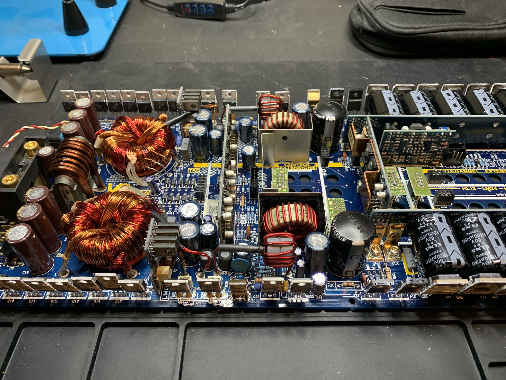

Audison 1.500.2 CE FHS capacitor replacement

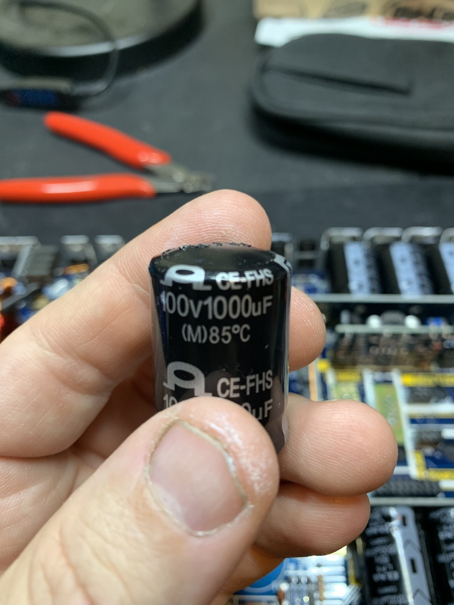

Both of these capacitors are bulging at the top and need to be replaced, they are CE FHS 100V 1000uf. I looked for direct replacements however I was not able to find any from mouser or digikey. On Daewoo’s datasheet, http://info.incomp.hu/NETPDF/FHS.pdf ,the features for the FHS series were low esr, low dissipation. I tried finding a similiar capacitor and found the CDE SLPX
https://www.mouser.com/datasheet/2/88/SLPX-3081876.pdf
And the Vishay MAL series
https://www.vishay.com/docs/28340/056057psmsi.pdf
Would either of those work well or would you recommend a different one.

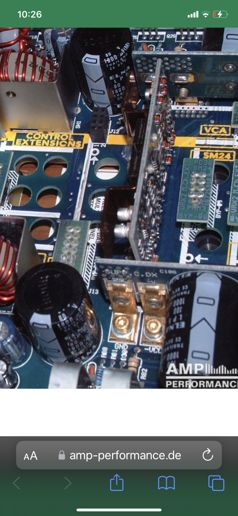

I just purchased the amplifier, it’s going to be in a difficult place to remove once it’s in the vehicle, it’s an older amp so I wanted to check and make sure none of the capacitors were going bad in it, that I could see. None of the other capacitors had that bulge, except those two. I thought they needed to be replaced, I’m glad they don’t. I won’t power it on untill it is back on the heatsink.
