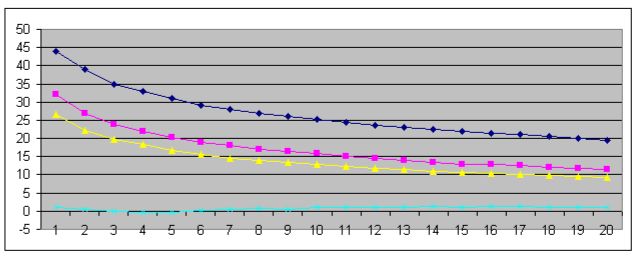

Asum the cone is at standstill.
Then the two coils can bee seen as a transformer with a LR as a low pas filter primary side. With known values.
secondary side is a current sorce loaded with LR.
converting it to the corresponding R/C.
The x-talk seems to have huge effect! lika a bandpass filter that at its maksimum is in phase with input and here normalised it is 6 dB down from drive signal.
Asuming the above is correct: The x-talk maksimum can probably bee generalised as in the middle of the elements passband, ie above fs. having a low Q.
