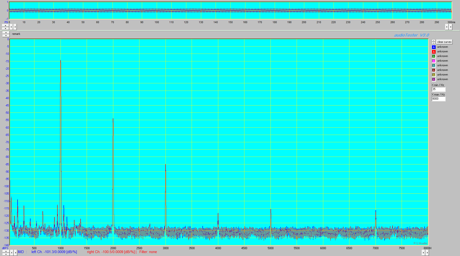

Here is my line amp under test. So a couple of questions:
Does it look like I am getting proper test results?
What are the standard FFT's that people are running and using to compare? (2D or 3D or distortion or IM or noise) I have no clue.

Yes, it is proper result....it shows that your preamp distortion a bit high.Does it look like I am getting proper test results?
Second (first is the fundamental -in this case 1KHz-) harmonic level 40dB (1/100) below the fundamental, and third -60dB, so THD (Total Harmonic Distortion) about (over) 1%.

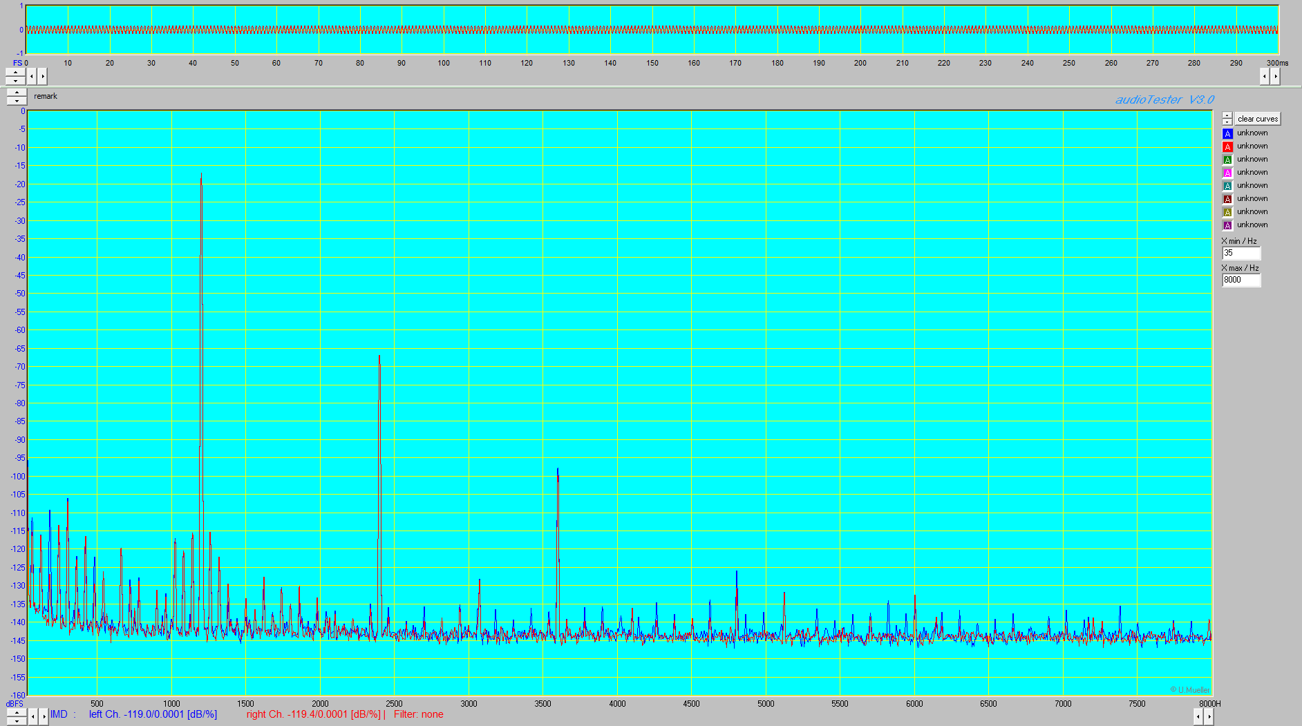

I have managed to switch over to the ASIO.dll.
Now I get this (attached) All else being equal..the distortion is magically better?
The ASIO is allowing a higher bit resolution OR I may have been able to use more bits with the Windows drivers and just did not know it?
Steep learning curve with this.
This is Windows 7 64bit with Audiotester (latest version) into a M-Audio Delta 1010. Using channels 7 and 8 (-10dB) Calibration value 800mA.

ASIO is squirrelly with my XP machine, worked much better with my (hate to say it) Vista computer. In any case, yes, your distortion is a bit high, but you may want to check levels using a scope or AC voltmeter to make sure you're not running them too high and overloading the preamp or your soundcard input.
Usually I use a loopback in one channel to verify that the soundcard is working properly.
Audiotester is amazingly versatile but it does take a solid understanding of FFTs and a lot of playing around to get things working right. And technical support is basically nonexistent.
