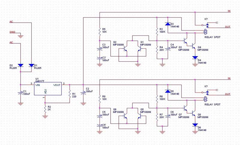

The speaker protection board schematic is attached.

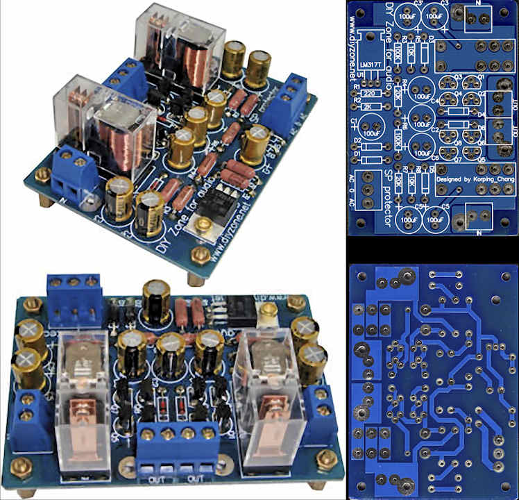

I bought a couple of the Audiotek speaker protection modules - the spec. says each module can handle up to 2 x 250W, suggesting stereo, but the schematic doesn't make speaker connection clear. No Left/Right or +/-, just two IN and two OUT.
I could assume +L and +R to and from board, with grounds straight from amp to speakers, but I would feel happier if someone with more knowledge could please confirm this before I kiss my tweeters goodbye... again.

Rab-
I have a speaker protect module like that- I forget if I got it from Audiotek or another Chinese seller. The grounds go direct to the speakers and the R,L go through the protect board. (I'm not sure that it protects much; more just a delayed turn-on??.) It gets AC-0-AC from the same transformer that feeds the amp.
If you have a pic, I can compare it to my unit.
BTW, I have a couple of sets of 'junk' thrift store speakers I use for testing stuff like this- I recommend it!

Audiotec Speaker Protection
John -
Sounds hopeful... same schematic as your earlier post. If it's the same board they were claiming delay, overload & DC protection back when they existed.
Pics of board bare & assembled should confirm.
