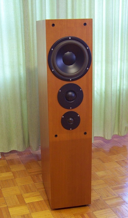

I have my own developed 3 way using Dynaudio 24W75, D52AF and D28/2.
When you say "Have you experience with AT" you "imply" that these speakers are different to work with. The same rules of speaker design apply. They have deeper bass capabilities, different sensitivity and impedance which means slightly different XO values will be needed for the same kind of voicing along with larger cabinet and vent tuning than a smaller diameter woofer of any other make and model. Room does much at altering how bass sounds, so some care should be invested in speaker placement, and box tuning. That's important. And no, I haven't worked with AT.
