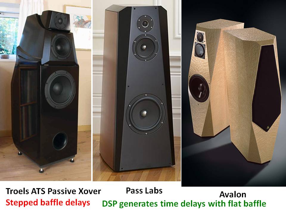

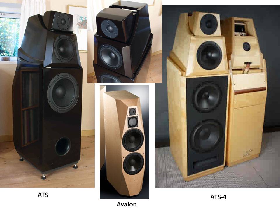

"In my opinion" Troels Jenzen ATS cabinet has too many exposed edges and stepped baffles for a low diffraction effects design. Troels' stepped design is required for time alignment, which is especially important with 2nd order LR2 crossovers to equalize the circuit's 90-degree phase shift. A full minidsp crossover would include delay-blocks, and this would allow a smoother, clevely shaped low diffraction baffle. You could maintain the basic ATS shape using smooth, continuous cut bevels. A little closer to Avalon designs. T-M-mW-sW cabinet, or a separate T-M-mW top + sW bottom cabinet.
Troels ATS woofer cabinet is 352mm wide(320mm internal). The advanced motor 12" SB34NRXL34-8 woofer has a 346mm external frame and 305mm internal frame...worth consideration. The low cost 12" Dayton DS315-8 has 314mm external frame and 272mm internal frame.
You might also consider removing woofer vibrations by using a side-side pair of sealed woofers with direct amp connections and minidsp for crossover plus room equalization. With dsp, smaller cabinet volumes can produce low-smooth <80H bass with a powerful amp.
You could use dual 10" SB29SWNRX-S75-6.
Dual low cost 12" Dayton DS315-8.
Dual advanced motor 12" SB34NRXL34-8 with flat SPL beyond 1kHz.

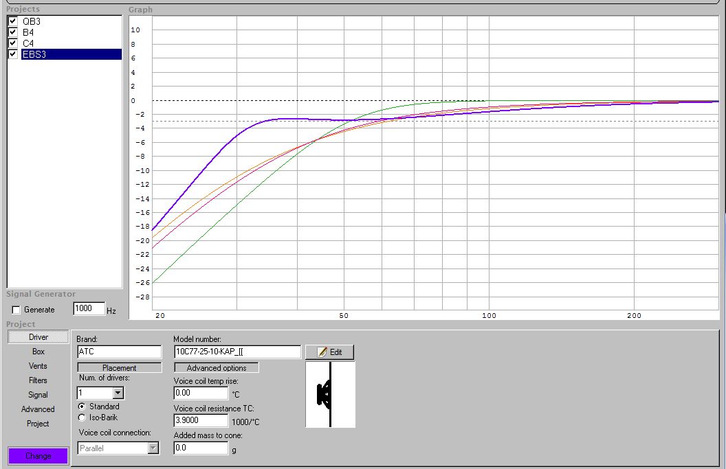

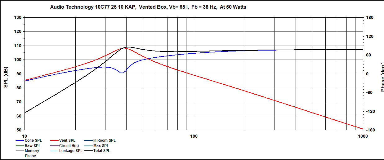

WinISD sims of the 10" ATC 10C77-25-10-KAP confirm that its T/S parameters work well for a ported -3db bass shelf alignment with -F3 of 30Hz when near a wall. Troels used this alignment in his 3-way ATS construction. Looks like an excellent ported woofer 3-way design for a modest size room.
In a sealed alignment, the 10" ATC 10C77-25-10-KAP will perform well with a 300Hz crossover frequency to the ATC 18H52-06-13-SDKA, even when a shallow LR2 slope crossover is used, and it has natural -F3 ~75Hz in a Qtc = 0.577 alignment often praised for fast&clean transients. You can use DSP with high power amplifiers to equalize this ATC 10C77 sealed box from 75Hz down to ~30Hz equalized-flat for your room. Max SPL at 30Hz will be limited to about 96db for conservative 10C77-25-10-KAP power specs.
-So, you can get decent bass in your modest volume room from a 3-way with a sealed woofer using DSP + watts.
-If you demand high SPL deep sealed box bass, adding an equalized 12" like the SB34NRXL75-8 with 91db sensitivity would get attention.

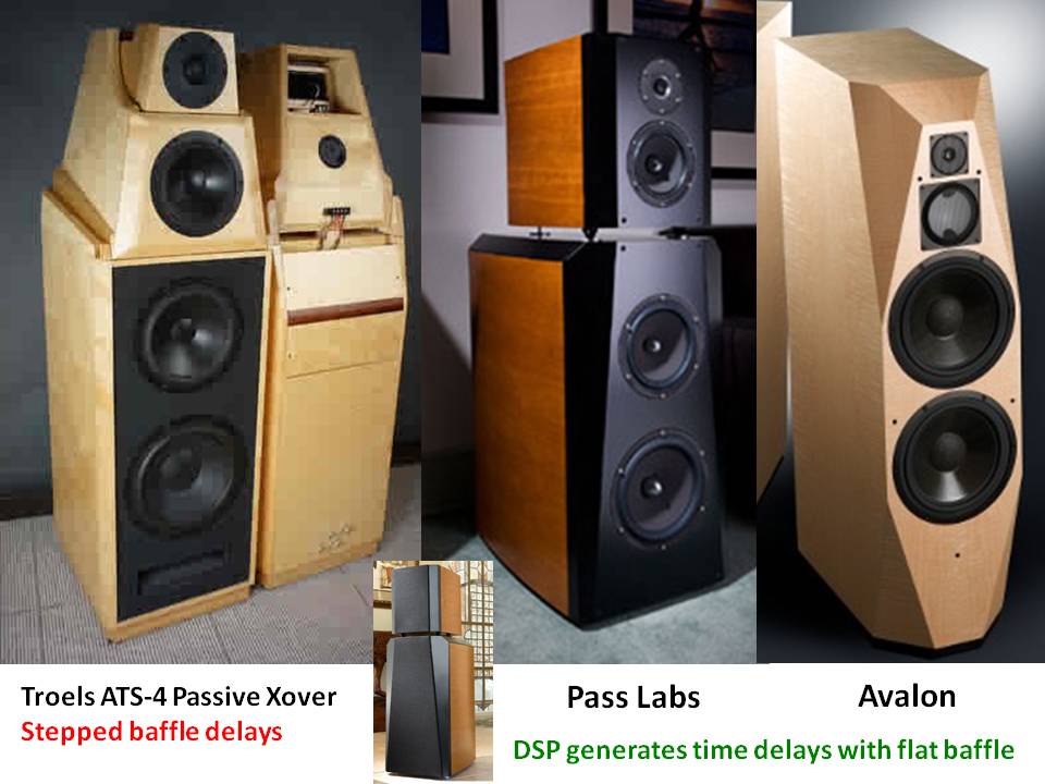

DSP will set the time delays that allows you to use low diffraction flat baffles. I added pictures of Avalon and Pass Labs speaker cabinets to illustrate options to the high-diffraction multi-step Troels ATS and ATS-4 cabinets.

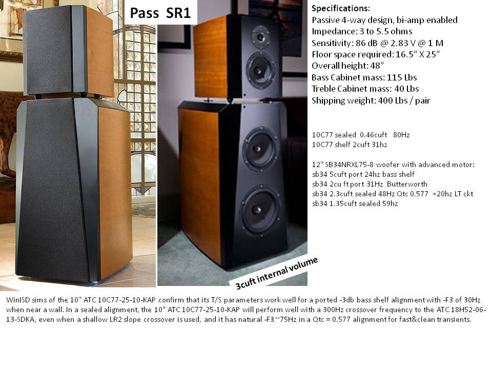

How good are your woodwork skills...or cabinet maker? Is there a commercial speaker cabinet which your favor?

As much space I can save it would be good. The maximum dimensions are the troels one, but sealed enclosure is an option.

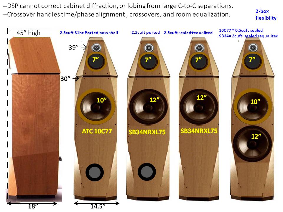

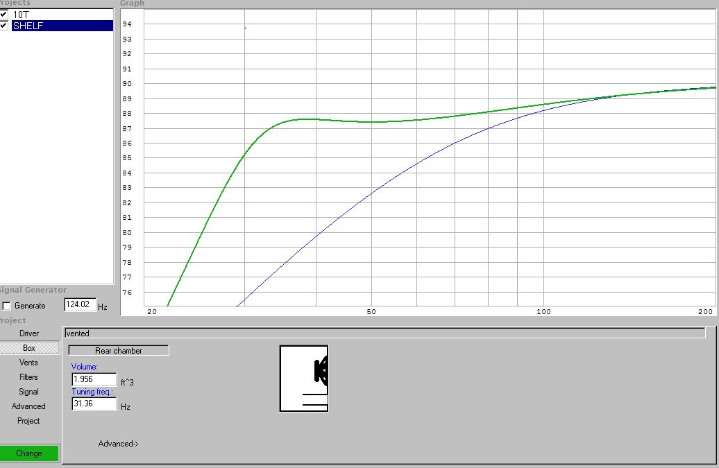

You could knock together an internal 2.5cuft MDF ported bass-shelf alignment test box for the 10" ATC 10C77-25-10-KAP, add some stuffing, and fire up the minidsp_HD + user manual. 3" diameter port, 8.8" long
If you decide on a single 10" ATC 10C77-25-10-KAP ported bass-shelf alignment woofer like Troels ATS, you could consider a single cabinet Avalon clone. 2.5cuft volume for the ported woofer is the goal. The open volume behind the sealed tweeter and midrange can be used, and this reduces the total cabinet size. You minidsp with the advanced 4-way crossover should handle this. (pic: Single 10in) ATS performance in a smaller, lower diffraction cabinet. There are a few diy-construction threads for similar Avalon boxes.
If you want greater flexibility to experiment with a 3-way using the 12" SB34NRXL75 instead of the ATC 10C77, or even a 4-way by adding the 12" SB34NRXL75 with the ATC 10C77 in the same cabinet, you could construct both a TM top cabinet, and a 3cuft internal volume woofer cabinet. Avalon style or Nelson Pass SR1 style are examples. Even with the advanced 4-way plug your minidsp will stuggle with bass equalization, you will probably need some passive Xover parts. (pic: Avalon xx and Pass xx)
W =360mm = 14.6" external ~ `12.6" internal
H =711mm = 28" external ~ 26" internal
D = 457mm = 18" external ~16" internal
gross internal volume ~3cuft
10C77 sealed 0.46cuft 80Hz
10C77 shelf port 2-2.5cuft 31hz near wall
12" SB34NRXL75-8 woofer with advanced motor:
sb34 5cuft port 24hz bass shelf
sb34 2cu ft port 31Hz Butterworth
sb34 2.3cuft sealed 48Hz Qtc 0.577 add 25hz Linkwithz Transform CKT
sb34 1.35cuft sealed 59hz plus massive equalization for 30Hz bass

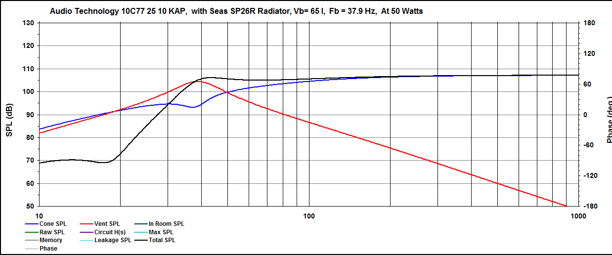

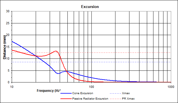

Hello again.

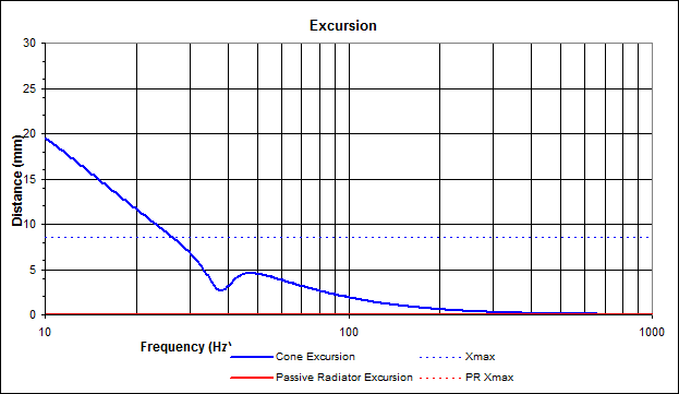

Here I go with my passive radiator calculations to get an Fb=32Hz
I should use a PR with 1.5 to 2 times the Xmax from my woofer, that has 7.5mm Xmax as Measured by AT, so I have to go for an Xmas of 11 to 15mm.
I can only find one PR with the weight and xmax combination:
SEAS SP26R-H9946
Xmax 12,5mm
Moving mass 42 gr
Sd 350cm2 (what means 21.12cm effective diameter)
With those numbers, my calculations are 65,7 gr, so I need to add another 24gr, although SEAS Specs says I need to add another 55gr
H9946 SP26R
Is this OK??
I'd rather prefer to use the cheaper Dayton Audio SD270-PR, but has a 10mm Xmax and the moving mass is 100gr with an Sd=340cm2 (28.8 cm diameter). Those numbers pray for 62gr moving mass, but the dayton has 100gr.
Dayton Audio SD270-PR 10" Passive Radiator
Any suggestion or Will the SEAS work?

For your 10" ATC 10C77-25-10-KAP I have been modeling a 2.0-2.5cuft volume with a 3" diameter port tuned to 28-30Hz (8" - 9" in my model). This produces an Extended Bass Shelf alignment which typically complements room gain. Troels discusses a similar design for his ATS.
This SPL plot might be a useful comparison with your passive radiator tool, or you could start with a simple plastic pipe port and purchase the proper passive radiator after some cheap experiments.
I mentioned the SB 12" in earlier posts just in case you wanted monster-bass from a 3-way which your minidsp-HD could easily control. Others have commented on the challenges and costs of building an excellent 4-way.
sb34 2.3cuft sealed 48Hz Qtc 0.577 add 25hz Linkwitz Transform CKT
