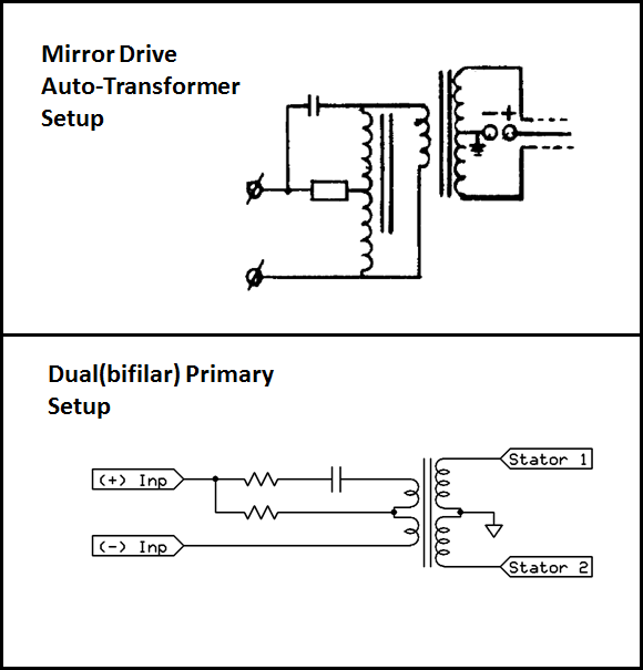

The auto transformer for a mirror drive setup can easily be made with a 100VA – 200VA toroidal power transformer that has dual 30V – 40V secondaries. You would connect the two 30V secondaries in series to use as the center tapped auto transformer winding, and not use the 115V primaries at all.
However, driving your 6v/230V toroids with a mirror drive transformer will not prevent core saturation at low frequencies…in fact it will make it worse as the auto transformer would be doubling the input voltage to your toroids at low frequencies.
For your setup with 6V toroidal power transformers, the best idea is probably to use the dual bifilar primaries as their own auto transformer.
This would give step-up of ~150:1 at low frequencies, reducing to ~75:1 at higher frequencies.
Attachment #1: shows the concept I described above with a dual primary single transformer compared with the Mirror Drive setup.
The resistor in series with the capacitor is not part of the mirror drive concept, but should be included to damp the high frequency resonance of transformer and to protect amplifier.
Attachment #2: shows the concept extended to your 4 transformer setup along with some suggested component values to start experimenting with.
As far as component values...in general larger center tap resistor and capacitor values move the start of the boost lower in frequency. However there is a lot of interplay between the transformer inductance, the capacitor value, and the resistor value going to the center tap.

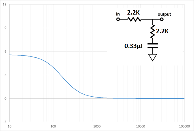

As far as using the mirror drive circuit to boost low frequencies, since you are using a separate power amplifier it would be much better to perform this equalization with a passive line level filter between your preamplifier and amplifier. Something like the attached circuit. The component values shown provide a boost similar to the mirror drive circuit for your NAD amplifier input impedance. Well...it is an "effective" low frequency boost. Being a passive circuit the response equalization is actually done be shelving down the high frequencies.

Thanks Golfnut and bolsterst for your comments and advice.
From what I had initially read about mirror drive I had understood that the advantages would not only be low frequency boost but also an ability to extend the low frequency range. I understand now that the latter is not so much the case, unless you use very special transformers.
I will try the 6 toroid transformer setup we talked about earlier in my setup, and will report about the results here. Apparently Syb0rg has a similar setup with good results ( KenSeibert.Com Audio Projects , a very helpful description of a full range ESL ).

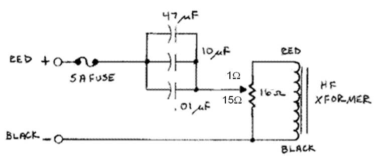

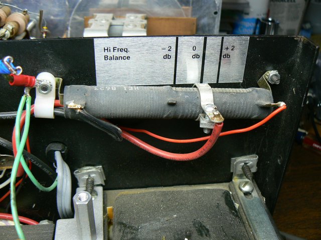

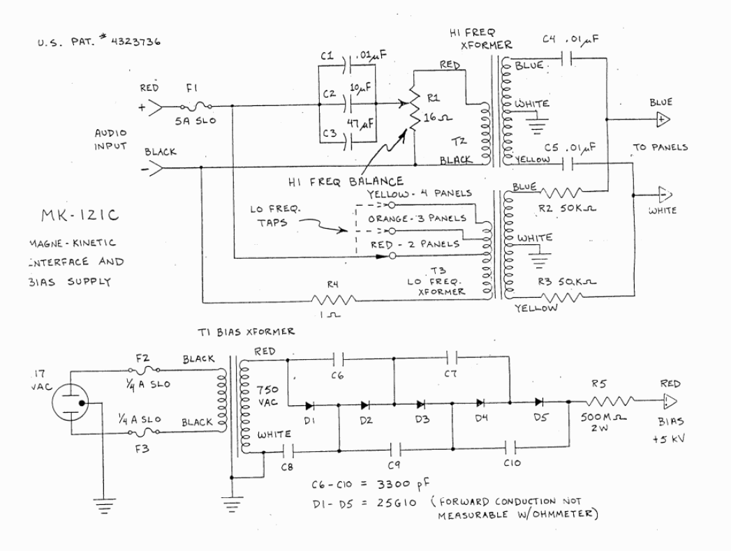

The best approach for combining a high step-up ratio LF transformer with a low step-up ratio HF transformer is the Acoustat C-mod circuit.
1) the primary side of the LF transformer is essentially driven full range with a small series resistance to protect amplifier in the unlikely event of core saturation
2) the primary side of the HF transformer has 1st order HP filtering to ensure core does not saturate at low frequencies. The filter is made up of the series capacitance (~57uF) and the shunt resistance portion of R1 (~15 ohm). The remaining ~1 ohm of R1 will be in series with the primary to provide the usual damping for the HF resonance. Acoustat used a sliding tap power resistor to provide some adjustment for the damping, but you can use separate resistors for the shunt and series portions.
3) The secondary side of the LF & HF transformers are combined in a "mixer" circuit made from 0.01uF high voltage capacitors and 50Kohm resistors. The bass boost from this circuit and trends for adjustment of component values was posted here:
Acoustat MK121 LF transformer Taps and Mixer Resistors

Very informative bolsterst, thanks again. The Acoustat approach looks very sophisticated and I might have a go at it later on when I have assembled my panels. The setup does have some advantages but also introduces some difficulties.
I will try the six toroids in total setup first (mentioned earlier) and see what I come up with with measurements. I will try to extend the bass as low as possible combining a flat response curve, adjusting the panels resonance frequency as a bass boost for the lower frequencies, as you did in your panels (as I read in other posts). This will take a lot of trial and error though, although the many informative posts here on this forum on the subject must give more than some guidance.
