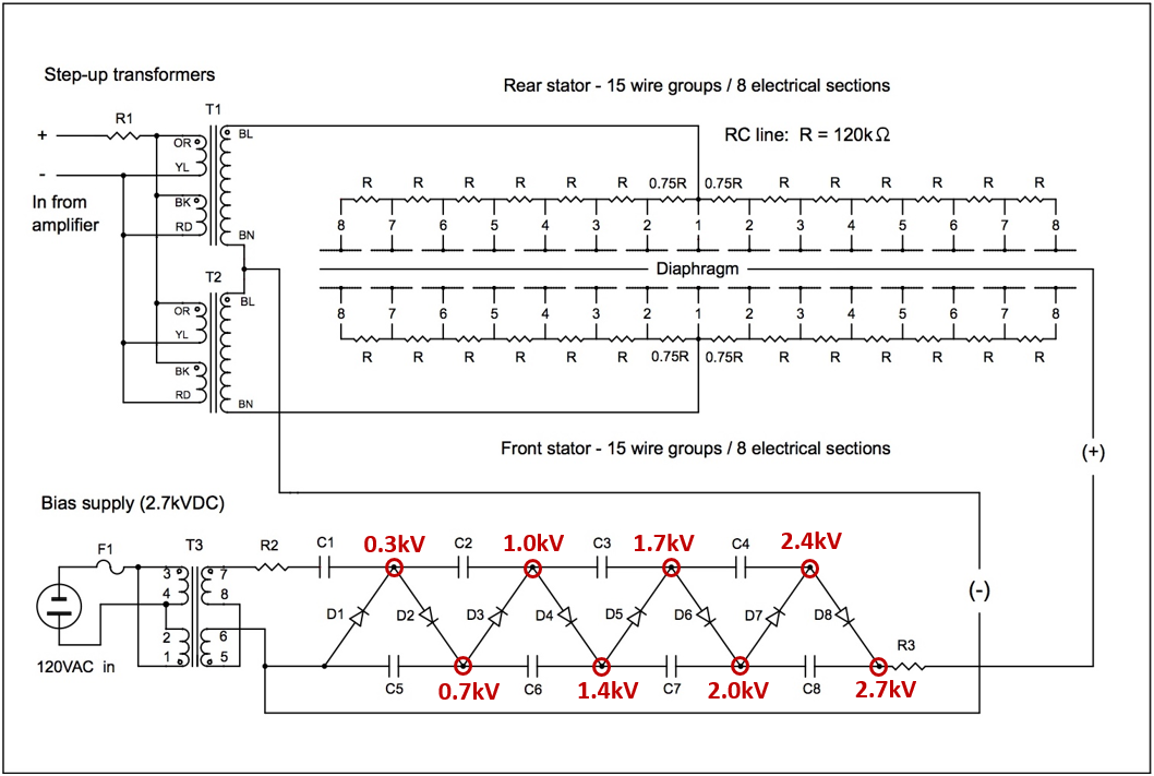

Have you checked the high voltage bias? I don't know what it should be on your speaker, but a loss of efficiency is often caused by a drop in the bias voltage. Be aware that a high voltage probe is usually required to measure high voltages, especially in a high impedance circuit like an ESL bias supply.

Thanks for the idea...it should be around 5kV...do not have a high voltage probe (yet), it is derived by a Cockcroft-Walton-cascade with 19 condensors and diodes.
Should I be able to read 5000/19= 263V over each diode then?

Somewhere in that range, yes. You may find, however, a steadily decreasing voltage increment at each stage due to loading effects of your meter. I've never been fond of measuring high voltage multipliers that way - very easy to get your meter probes in the wrong place and...poof goes the meter. Better to use a proper HV probe at the output of the multiplier. But even with a high-impedance HV probe, you will likely measure less than the actual voltage due to loading effects of the probe.

Thinking of measuring across one diode by connecting first, setting the DMM and then plugging in. Observing from a distance and if the DMM goes, not a great loss, I can unplug the HV supply from the sidelines. Just need inflammatory underlay 😉

Bolserst - perhaps you can confirm - shouldn't the voltage at each stage of the multiplier be measured across each capacitor, rather than across each diode? I've always had an HV probe at my disposal (ever since birth, ha ha) so I've not much experience measuring stage voltages.
My preference is to measure across the capacitors, but you can measure either way. The advantage of measuring across the diodes is that it will be half the voltage of that across the capacitors (except the first cap). The downside is that it is more work to calculate the total output voltage.
See example figure taken from: there's a way to understand the limit of hv bias?

I got a HV probe and as I remember the audiostatic has around 5,2 kV. Measure the output!

I am not able to measure across the diodes, this is to close.
Instead I went capacitor by capacitor, the outer row added together gets 2kV, since there is an inner run of similar caps on the side towards the transformers...I'll make a wild assumption in just doubling the output so that gets to 4kV...and it does not change noticeably between free running or panel connected.
So I was also informed that I can tighten the diaphragm by using a heat gun/hair dryer...as long as I stay below 140C. Measured the output of the hair dryer at 80C and did one run...the crackling completely disappeared...well off to the other panel...careful et voila...no crackling either. So I must admit there was too little mechanical tension. Sensitivity is better as well, need some time to listen before comparing with the other ESLs.
