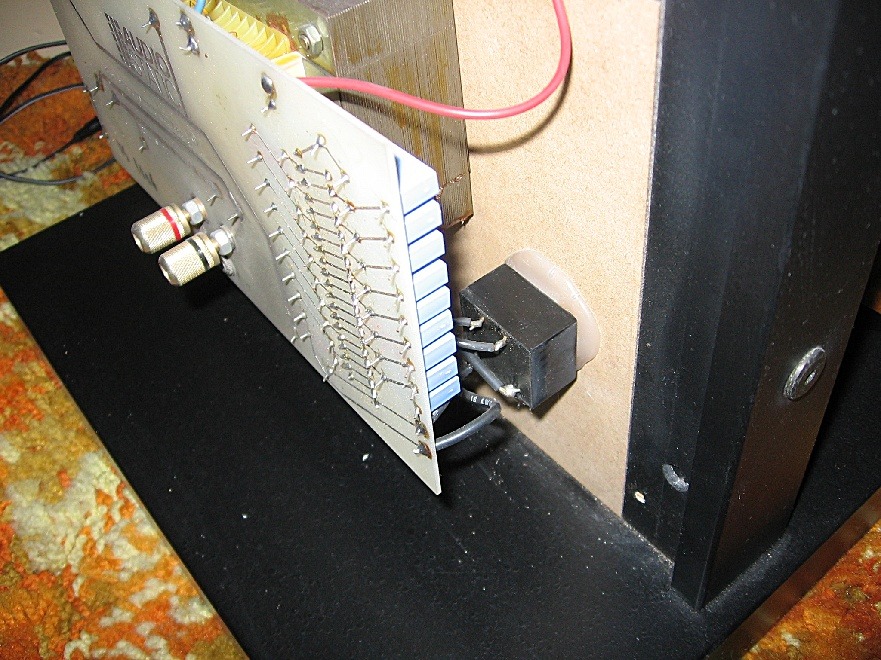

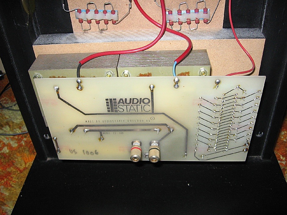

Neither of my Audiostatic ES100 speakers will play high frequencies.I have a beautiful midrange but the sparkle is not there.
Since these are single panel I would think the problem would be in the interface.An ex Audiostatic employee thought it
could be a fuse or relay.I don't see a typical fuse but do see a small black box which could be a relay.Not sure how to test it.
Any help or thoughts would be truly appreciated.

There is nothing in the interface that can cause this. High frequencies are only radiated from the center strip of the membrame that is connected unfiltered to the transformers and that plays fullrange. The resistors under the panel filter the remaining sectons left and right of this center strip, those radiate only low freqs.
Most likely the membrame coating is on it's way out, so the middle section does not charge properly anymore.
Try breathing on the membrame while playing music. When the highs return temporarily it's the coating. Don't remember if the coating is on the back or front side, just try both
The small box btw is probably a mains transformer wired backwards. The USA models used a wall wart adapter that delivers some low voltage ac, that was converted back to 230V ac by this internal transformer. The voltage multiplier for the bias voltage is fed with 230V. European models feed the mains directly to the multiplier without isolation transformers, but in the USA this was not allowed. Thus this improvised additional transformer.

One more thing to check: what amplifier are you using? These speakers go well below 2 ohms at 20kHz and represent an almost purely capacitive load. Amps with high output impedance (tubes and/or designs without feedback) can roll off in the highs because of the rc filter that Rout forms with the capacitive load. Easy to check, just measure the frequency response over the output terminals.
The OCM looks like it's up to the job for sure. Be careful in the meantime, when the coating is bad they loose a lot of sensitivity so it is easy to overdrive them. You wouldnt be the first to ruin the transformers that way.
If there is a large electrolytic cap on the pcb, check that one too.
When you drive the membrame into the stators you are feeding them way too much power. Don't do that. They really should not need more than a few watts to play at normal listening levels when the coating is good.
